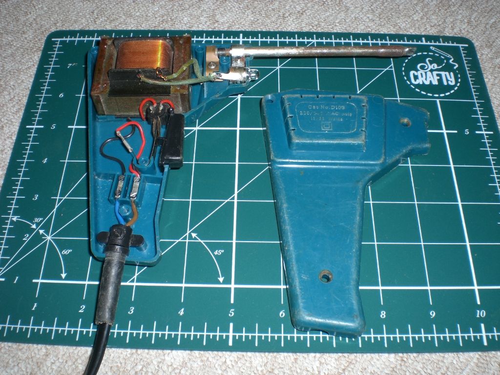

          Hi, I've never had one of those soldering stations with temperature control, but I do have a duel power one, which I happened to come across the other day. It's a Black & Decker one from the 70's era and had two different sized irons, which the transformer heated. I've only found the larger iron of the two and the tip end of both of them is a flat blade shape. I haven't used it in years and it needed a bit of a clean inside and out, so I took it apart.
          When I'd cleaned it, I plugged it in and it worked without any problem despite the tip being a bit eroded a little on one side. I used this one and my little black Antex C precision 15 watt one a fair bit when building the circuit boards for my mobile disco decks/mixers, and amplifier etc.
