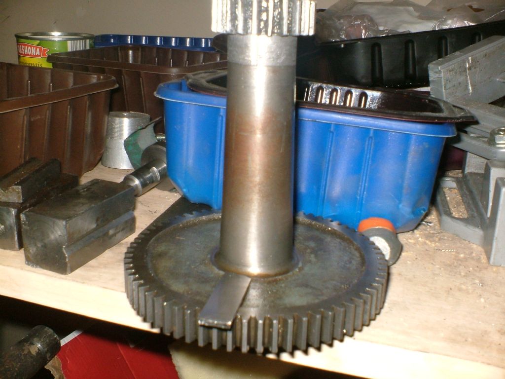

      Any tips on how to soft solder cast iron please? I'm struggling to get it to 'wet'

          Hello David,
          I'm not surprised! The carbon content will make it impossible as it tends to act as a surface contaminant.
          Much better success is assured in joining to Cast Iron with high temperature bronze welding which also makes a strong joint. You do need oxy/acetylene to get the temperature needed though

            Preheating to red heat will drive the carbon to the surface which can then be wire brushed off when the part has cooled, you can then silver solder and I believe the same method can be used for soft soldering though I have only used this method for silver soldering..

              Thanks, I haven't got enough heat to silver solder or to get it to red heat. I'll have to think again.
              I started by going to a local engineering shop to ask them to braze it. They said that they don't use acetylene any more for various reasons i.e. cost and availability and the gas they use isn't suitable for brazing. The second and third shops that I tried gave me the same answer. The fourth told me 'yes no problem' but after three weeks I've just been to collect it as they still haven't done it.

                Depending on application and whether you consider soldering essential. I have used JB weld on CI and it works a treat. Much prefer the original to the fast stuff.

                    Decent cast iron welds pretty easily if you've got a pal with a buzzbox

                        Hi David, no idea what needs to be repaired, but if it is a simplish sort of part, is fabbing/machining a new one from solid CI stock like Durabar or Meehanite a possibility? Obviously this won't be an option if it's something big or complex but worth a thought of it's smaller and not too involved. Just a thought.

                            What are you trying to repair? can we see? I'm curious to know what a professional outfit put off for 3 weeks.

                                Hello Pete, of course you can see, it's just that I'm a little embarrassed having admitted that I'm trying to soft solder it!
                                It's a steel gear wheel and a cast iron sleeve on a Mellor lathe that I'm restoring.

                                  Could you key it on? Better for high torque applications

                                    High strength loctite?

                                      The problem is a little more complex though. Having got the lathe as a box of bits, I 'think' that originally the gear wheel was also cast iron and part of the sleeve. for some reason the wheel has broken and this is an attempt by someone to repair it. The wheel is only bored out for 3 or 4 mm just enough for a register. If I machine the wheel all the way through to accept a key, I think that it will leave the sleeve too short. There is a triple pulley to fit on the other end of the sleeve.
                                      Last resort I think will be to make a new sleeve and wheel in one piece.

                                          Four quick tackwelds with a decent buzzbox would do it in 5 minutes
                                          100-120 amps with mig gasless wire
                                          Instant practical problem fix… but cosmetically ugly
                                          I had to use a key because my replacement cog was aluminium

                                              O.K. After chatting with Brian, I've decided not to prevaricate any longer and I've ordered a piece of cast iron to make a new one in one piece.

                                                    I did suggest you graft the gear you already have onto the new piece of cast iron bar and how to secure it. There seems to be nothing wrong with the gear itself, it will save you time as well.
                                                    It is of course your choice but as you describe your plan it involves making the gear as well. Either way, I hope it goes well for you.
