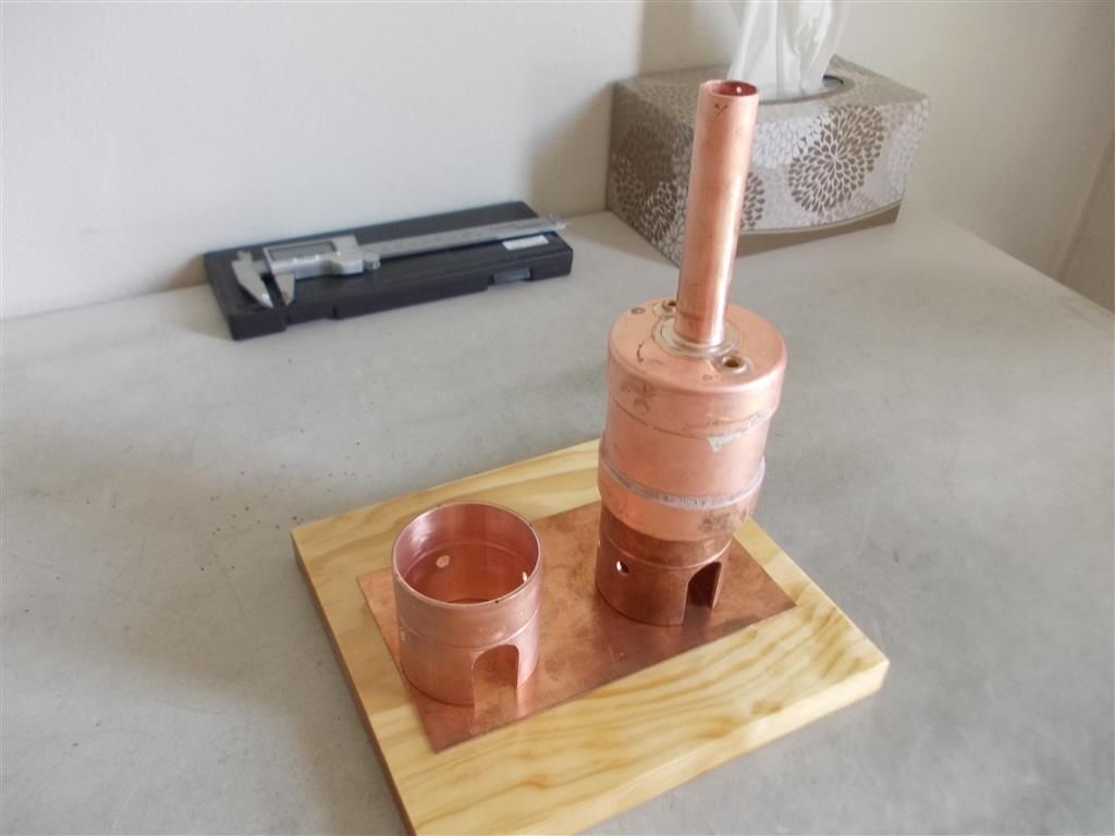

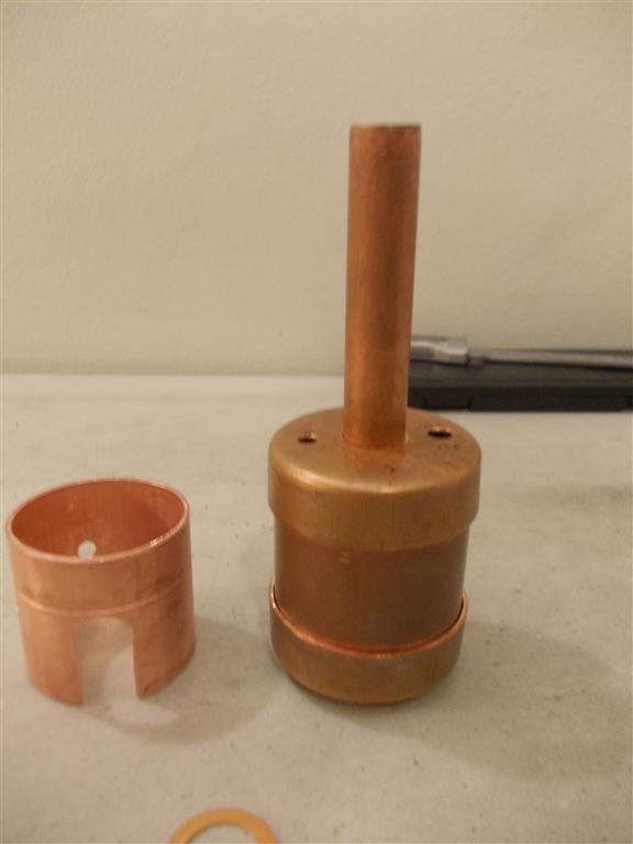

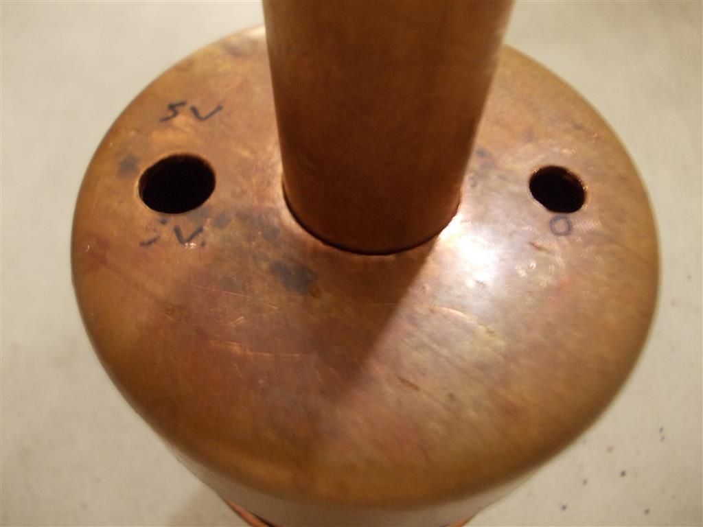

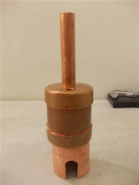

        I have gathered all the parts together to make a slightly larger version of the Midwest boiler : mine uses 65mm end caps and is 75mm in length/height, excluding the firebox. I had a few problems drilling the large 19mm hole to take the flue/chimney. There is slight gap which I hope you can see in the pictures : the tube does not fit in the hole as well as I would like. How big is too big a gap ? I was thinking of silver soldering that copper washer around the chimney to improve the situation ?

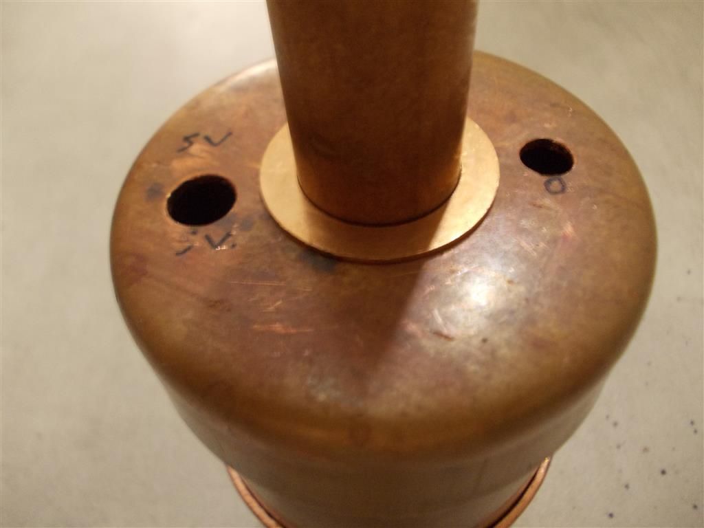

          Brian,
          First; let me congratulate you again, on the inspired use of those end-caps !!
          Second; life will be much easier when you get a lathe … that hole could have been bored to size.
          Third; My rescue plan would be to make a snug-fitting ring of Copper wire and press it into the gap; then solder the lot … Silver Solders really need quite close fits, so that they work by capilliary flow.
          #177046
            The washer should do the trick or Michael's wire.
            Are you going to add a couple of cross tubes to the flue to help get the most from the available heat? Now would be the time to do something about it before you start putting things together.
            J

              Michael : yes, the lathe would have been very handy for drilling the hole and levelling off the top of the end cap (I had to do it by hand with a file). I could also have thinned the base of the end cap a bit. At 1.58mm thick it may not conduct heat as well as say 1mm thick copper. The sides of the boiler are 1mm thick ; I could not find the thicker copper pipe at the scrap yard.
              A ring of copper wire would not work as the hole is not quite round ! It is slightly oval which is why I went for the copper washer idea. When I drilled the hole I had the end cap in a vice which slightly distorted the end cap and hence distorted the hole. Next time I will slacken the vice on the last step of the step drill and hold the end cap by hand to get a neat circular hole.
              Jason : what diameter cross tube would you suggest ? I am not really confident enough about the whole project ; it is adding more potential leak points which would be almost impossible to fix. I have no way to pressure test the flue with the cross tubes before fitting it….a nice idea though.

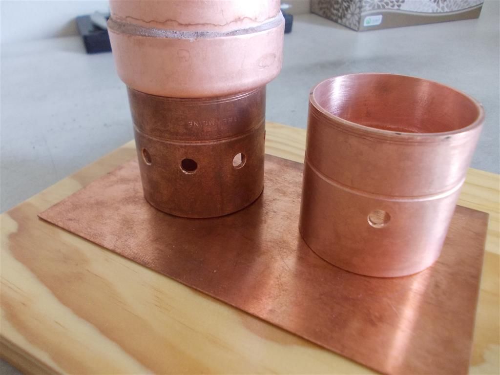

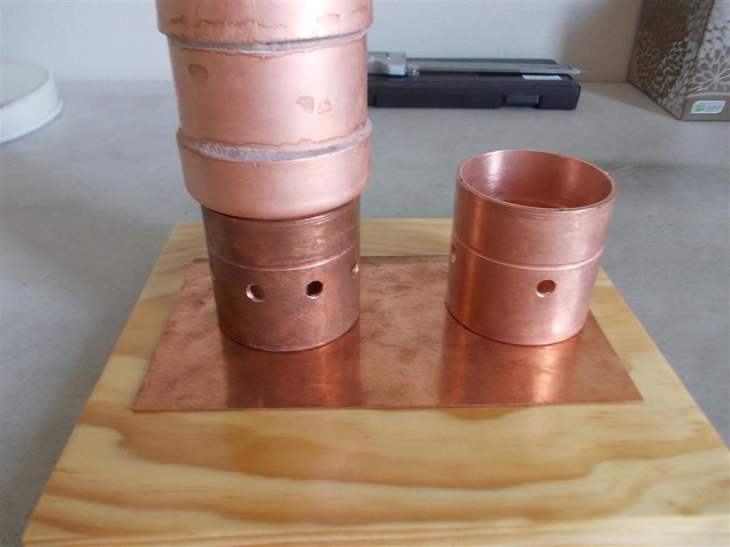

                    I have soldered the larger boiler together and I am ready to solder the firebox to the base of the boiler. I have built two fireboxes : one has three air holes and the other has six air holes. Which one would you use or would it not really matter on this small scale ?
                    NOTE : I have already soldered a firebox to the smaller Midwest boiler and it makes a huge difference. It raises steam much more quickly now. The firebox on the Midwest boiler has three air holes.

                      Possibly fit the 3 hole one and if you find it needs more you can always drill them once it is assembled, you will still be drawing a lot of air in from the large hole where the burner tube fits.
                      Rest looks a good job

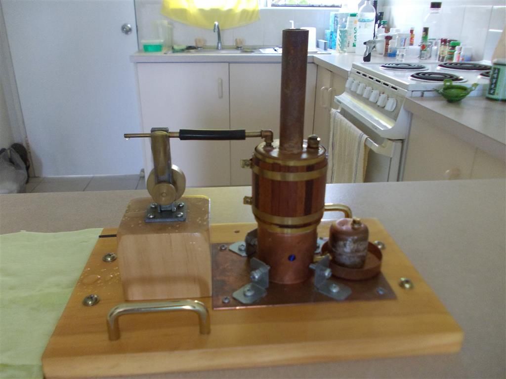

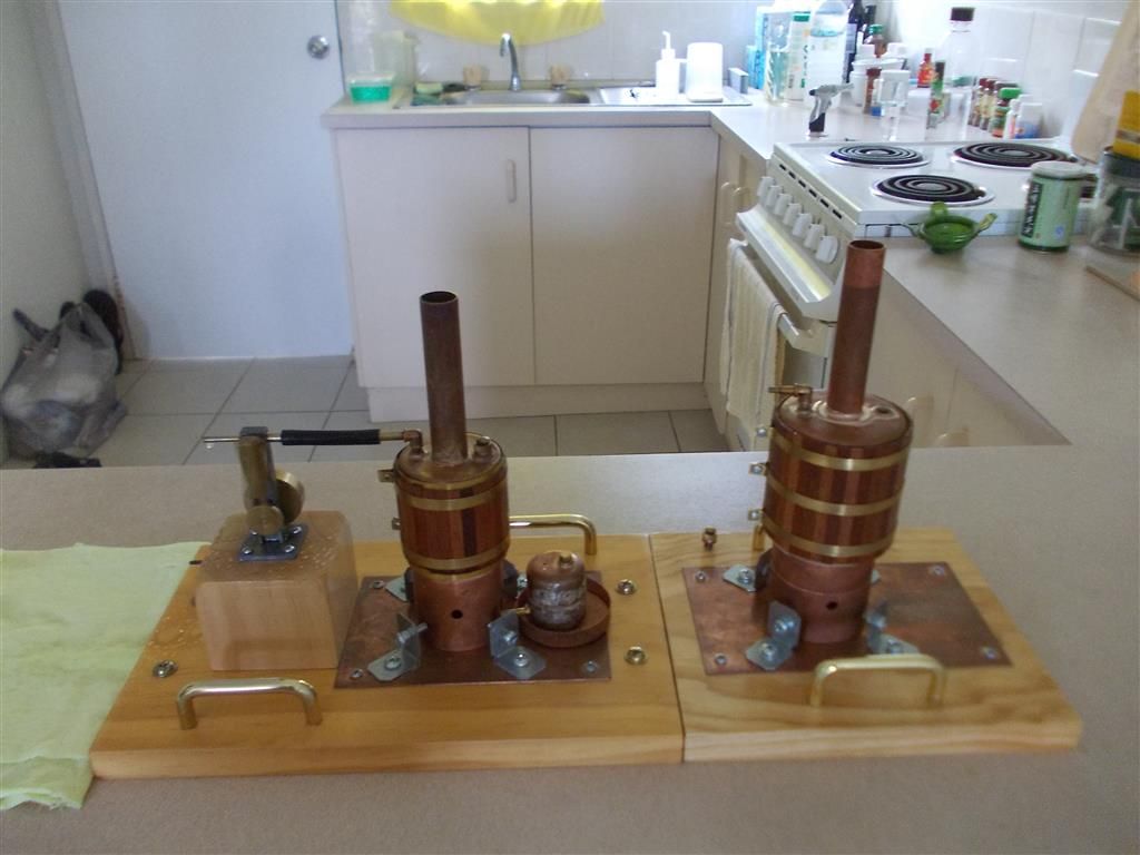

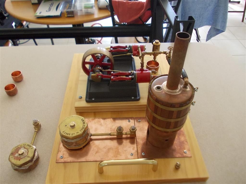

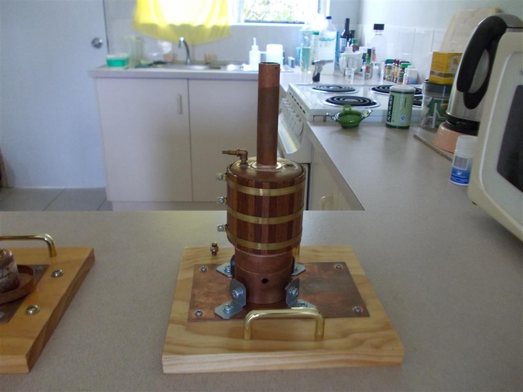

                          The finished products : both the Midwest steam boiler and my own larger copy. I am not sure if the larger boiler needs the two boiler bands. They are tricky things to fit !
                          I will be replacing those steel brackets with something made of brass soon.
                          Edited By Brian John on 07/03/2015 05:50:55

                              Brian, it would be nice if you could fit the support brackets inside the firebox, with the feet turned inward, that would look a little tidier, to match the nice work you have done on the rest of the boiler.

                                      1. When I silver soldered the end caps to the pipe I put flux on all surfaces and then pushed them together.
                                      2. I applied flux to both sides of the washer, the top of the end cap on which is sits, and the chimney where it makes contact.

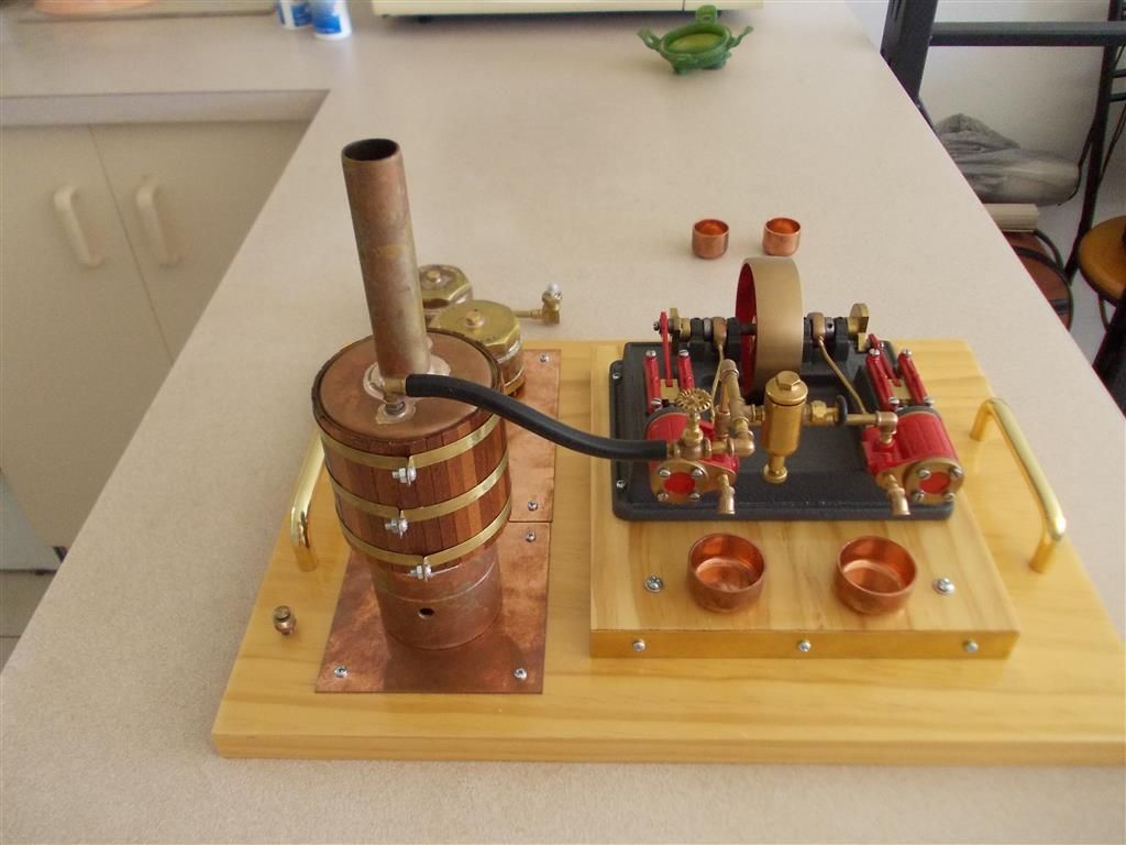

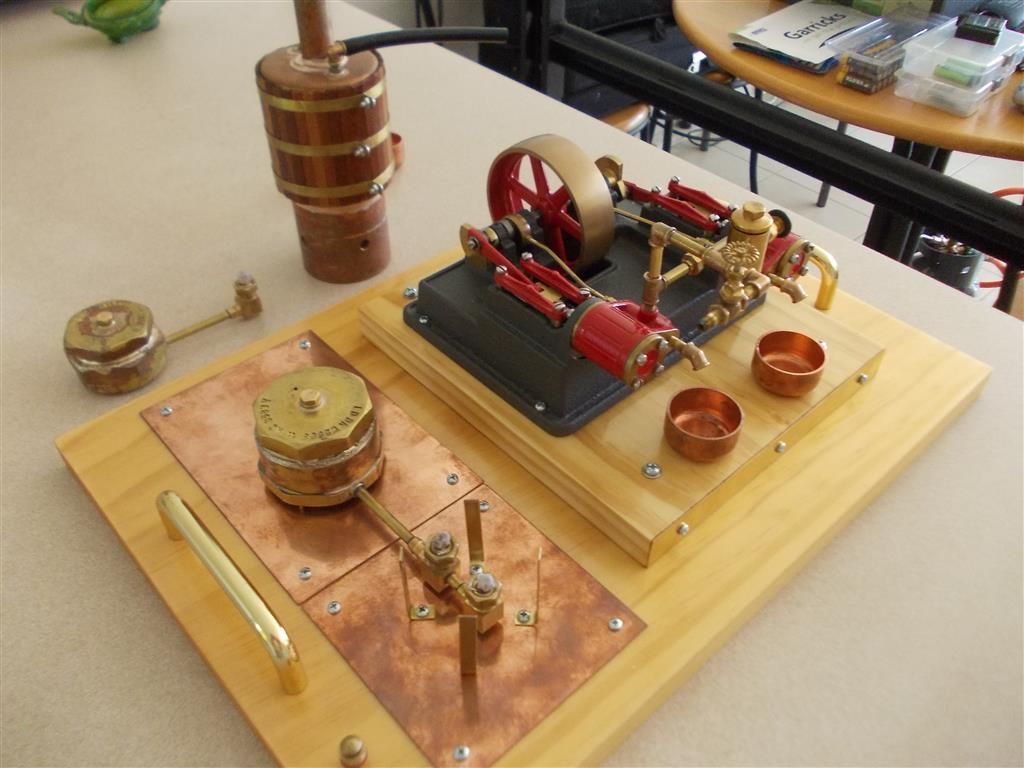

                                        Here is the PM Research twin cylinder engine combined with my own boiler all fitted together on a single wooden base. I have made brass struts to hold the boiler with the feet facing inwards as per Jason's suggestion. There is a larger copper plate to take the twin funnel burner and it is separated from the boiler's copper plate by a 1mm gap. This is to stop the burner getting hot when in use although the small pins I have fitted to the bottom of the burners seemed to have solved this problem anyway.
