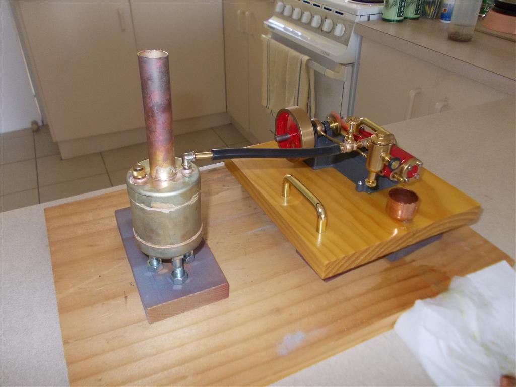

                  #172095
                  Brian John
                    @brianjohn93961

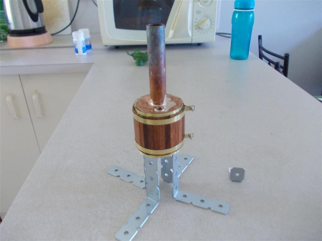

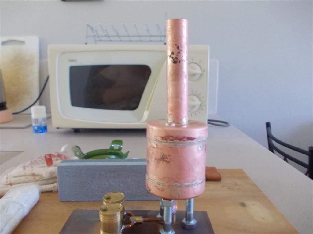

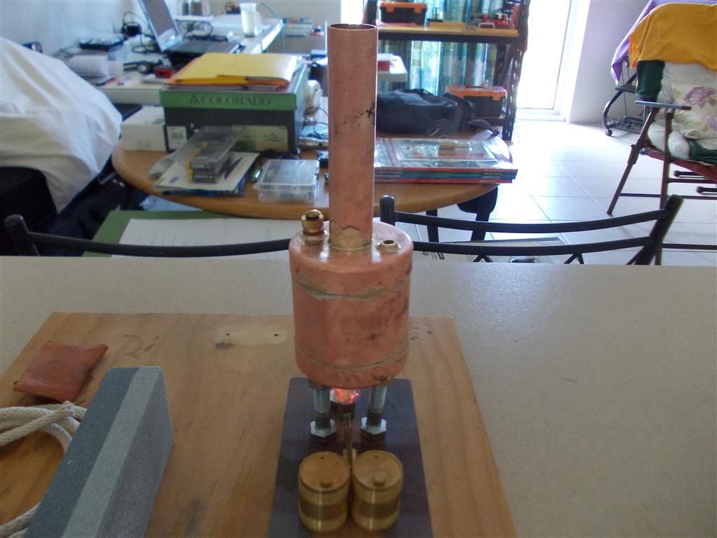

                    I went to the scrap yard this morning and a found piece of copper tube which fitted nicely over the brass tube. I also found some copper tube the exact same size as the brass chimney so next time I build one of these I will use a full copper chimney right through which is what Midwest should have done in the first place. I decided to remove the damaged part of the brass chimney ; I think this was a mistake as it would have helped keep everything upright by leaving the full chimney intact.
                    As you can see from the photos below, after the solder had hardened the chimney is not perpendicular…very frustrating as it was perfectly straight when I started soldering. I suspect that the top of the boiler may have changed shape and buckled a bit or the copper sleeve was not as good a fit as it could have been.
                    After putting it in the pickle for one hour a decided to give it a quick test to see if it actually produces steam as there would be no point putting the insulation and wooden lagging on if there was a leak somewhere. In the photos below it is not actually under pressure as I left the fitting out for the steam outlet but the water does boil and steam comes out of the hole so something should happen when I connect it up.
                    I really must buy another one of these and do it properly next time ; both the boiler and the engine could have been much better. I am not sure if it worth trying to remove the copper sleeve as that would require a lot of heat and it may ruin all the other solder joints.
                    NOTE : It does not look too bad in the photos but it is actually quite bad……seriously thinking of grabbing the blow torch and trying to remove it !
                    Edited By Brian John on 10/12/2014 03:10:04
                    Edited By Brian John on 10/12/2014 03:10:53
                    Edited By Brian John on 10/12/2014 03:34:07
                    #172126
                      Brian,
                      The copper should now be in a very soft state, A bit of broom handle down the chimney and very gentle, controlled pressure should see the chimney upright. Just be very careful not to dent or crease the boiler – you will need to find a way of holding it that gently spreads the load.
                      Neil.
                      #172179
                      Brian John
                        @brianjohn93961

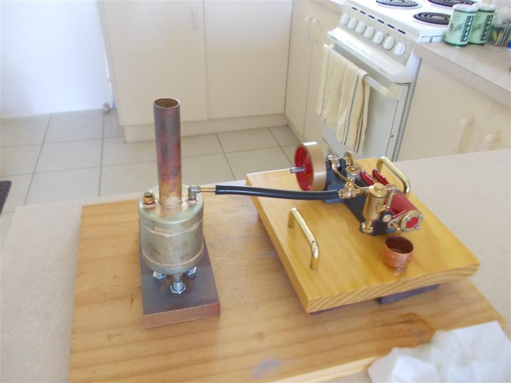

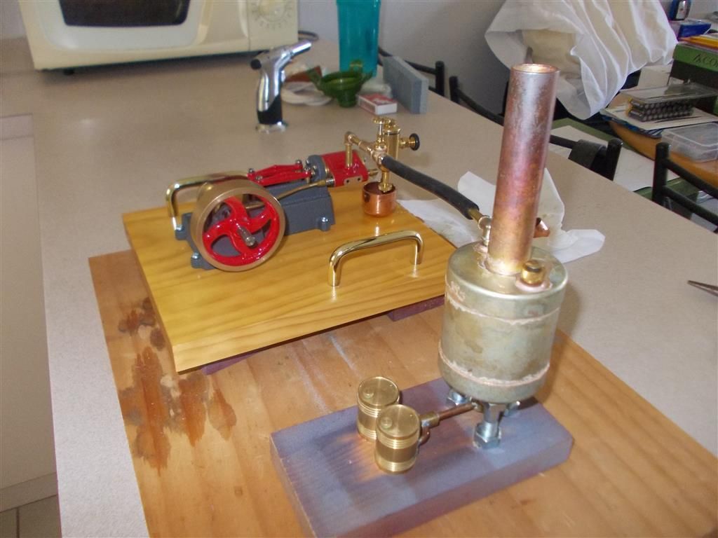

                        Thank you for that suggestion ; it worked well. I had a piece of wooden dowel which was a perfect fit and the chimney is now straight. So I decided to fire it up and see if it runs the 3BIM engine from PM Research. Nothing much happened for a while : there was a bit of steam and some water but that's is all. Then I noticed the boiler was turning a golden brass colour. I did not like the look of this so I removed the flame to see what the problem was. In all the excitement I had forgotten to fill the boiler with water !
                        I let things cool down and filled the boiler. This time I think I had too much water ; the steam engine was a water pump with water and oil being pumped from the exhaust but after a few minutes the water level in the boiler dropped and things started to run perfectly. So my first boiler is a success. I still have to add the insulation, wooden lagging and the brass stand.
                        I do have a few questions :
                        1. I used silver solder (hard solder) on this boiler even though I did not have to. When is silver solder essential ?
                        2. Why did the copper go a golden/brass colour ….what is happening there ? Will it stay that colour ? I notice that the chimney is now reverting to its usual colour but the boiler is not. I am just curious.
                        3. Have you ever done anything as stupid as not filling the boiler with water ? I guess it is like running out of petrol in your car…it is something you only ever do once in your life.
                        4. I was wearing full face protection and leather gloves during this testing. Do you wear eye protection at all times when working with live steam or am I being over cautious ?
                        Edited By Brian John on 11/12/2014 02:39:47
                        #172255
                        Brian John
                          @brianjohn93961

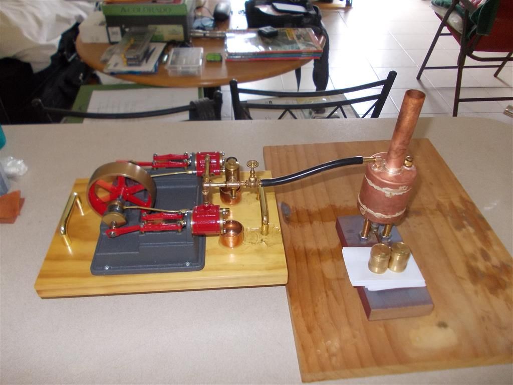

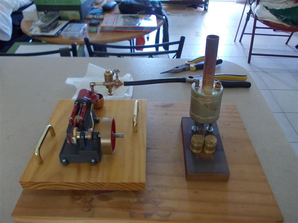

                          I dropped it in the pickle and the copper colour was restored ! I ran the twin cylinder 7BIM engine today and all went well. I did not forget to add water and only filled the boiler about 3/4 full. This engine really needs a slightly bigger boiler but it did turn over and ran quite well.
                          The little wobbler engine runs but only for about 15 seconds then it runs out of steam. I suspect that the piston is not a good fit. I mucked it up when soldering the piston rod to the piston. I have tried to build another piston (which was a perfect fit) but the problem is trying to drill a hole exactly in the centre to take the piston rod ; I am always slightly off-centre. I know it would be easy with a lathe but there must be some other way to get it right ?
                          Edited By Brian John on 12/12/2014 02:37:11
                          #172261
                            Brian, the change in colour was just the copper starting to oxidise, as you have found the acid soon takes it off.
                            One thing that will reduce the amount of water and condensate being spat out of the engine would be to have your rubber tube sloping back DOWN to the boiler, just stand the engine on something to raise it up a bit.

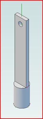

                              #172269
                                I think I an right in saying that there is no end cover on the cylinder so there really is no need for a concentric round piston rod, it just needs clearance to miss the crankweb. So take a bit of the rod you have that is a good fit in the cylinder, file the two sides to leave a narrow "rod" and then cross drill for the crank pin.
                                If you wanted you could also file the other two edges
                                Edited By JasonB on 12/12/2014 08:41:08

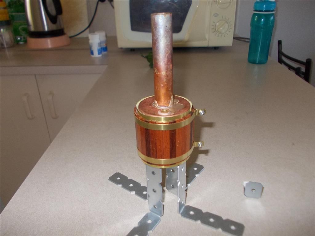

                                          I could not get the brass plate to cut neatly and it seemed quite flimsy anyway so I have cut away the bottom 40mm which forms the base. I will make a stand of my own either by cutting up the angle brackets shown in the photos or some brass strip (not sure yet). But I added the fibreglass insulation and the wooden lagging which is held on with the brass bands : you just about need four hands for this !
                                          First I added the layer of fibreglass insulation ; it stuck to itself quite nicely and held itself in place. Then I added the brass plate which I have now cut to fit the boiler ; it no longer forms the stand. This brass plate was held in place with masking tape which had to be left on. I hope it does not cause problems when I next heat up the boiler ? Then the wooden lagging (already painted with 3 coats of estapol) was stuck to a long strip of masking tape and wrapped around the boiler. It was held in place with the masking tape until I secured it with the boiler bands then the masking tape was removed. In theory I can now pick it up while it is still hot but I am yet to try it .
                                          I might give the chimney a coat of pot belly black heat resistant paint as it looks a bit shabby due to the heat.

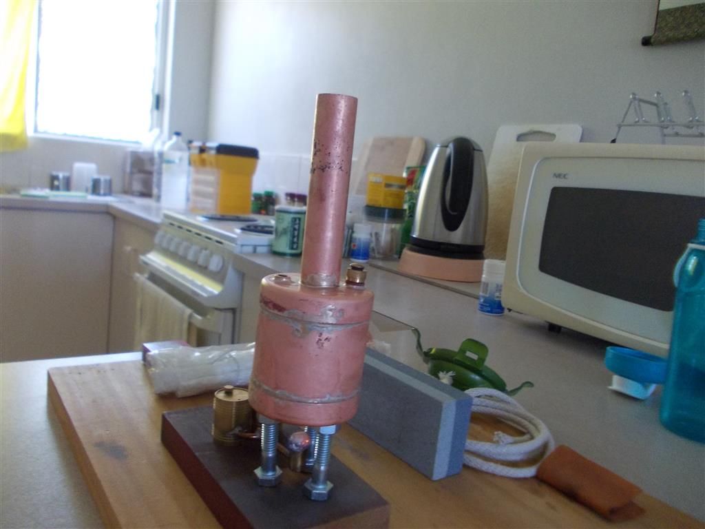

                                              I tried to paint the chimney today after carefully sanding it clean with 1500 wet/dry then wiping down with metho and letting it dry. The boiler itself was masked off. I had about six different brands of high heat paint to choose from all of which stated on the can ''no primer required''. I chose Hammerite High Heat Paint (black) in an aerosol can. Trust me to choose the dud brand ! It did not stick to the metal at all ; the chimney looks like it is covered in black fluff. I have no idea what went wrong here. I have done a lot of airbrushing on metal and I have never seen this type of result before. It even looked fluffy on the masking tape so I suspect a dud product.

                                                I used an aerosol BBQ matt black paint on my stove top hot air engine, it soon turned grey. Here it is when first painted, and before the fan guard was fitted. Ian S CStove top

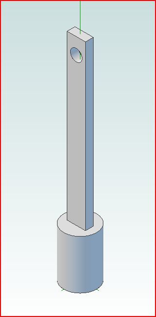

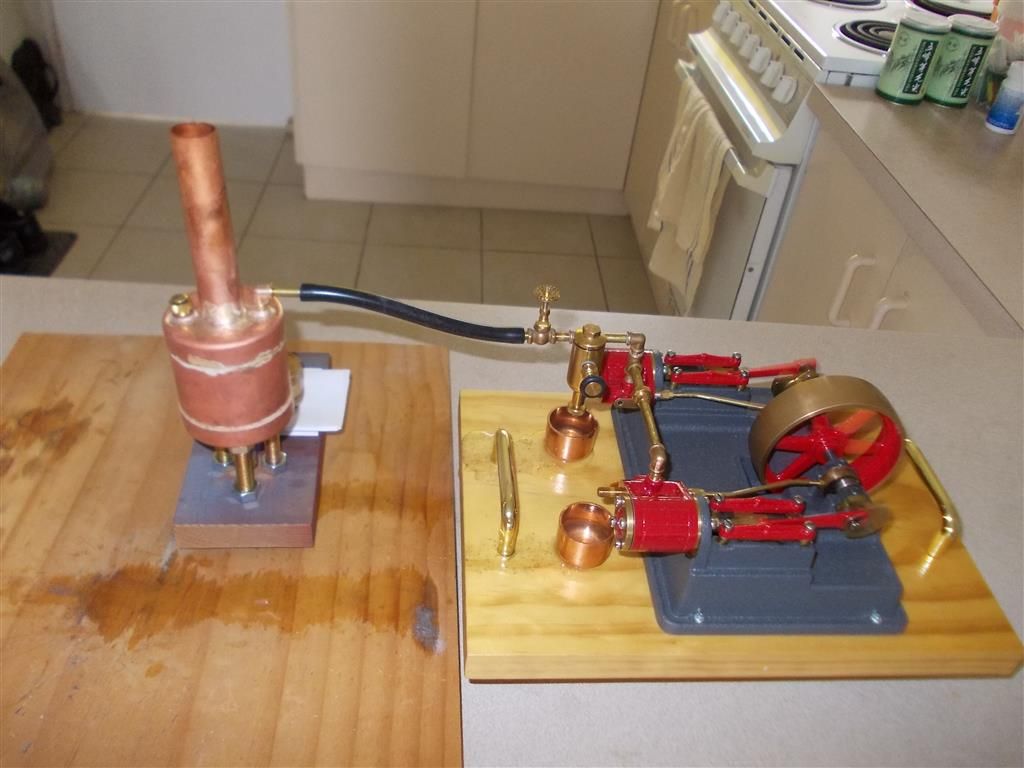

                                                      Some problems solved : I have remade another piston. Finding the exact centre is easy when you know how. First make a dot in the centre by eye using a fine tip marking pen. Then check it by putting it in a drill : look at it end on while you turn on the drill. If the dot wobbles about then you are not in the centre. ''Rub it out'' by holding the end of the piston on some 600 grit sandpaper while it is still in the drill. Do this again until the dot does not move when you activate the drill…it should stay in the centre like the North Star. Carefully make a punch mark on the dot and check this again with the drill. If you are in the centre then put the piston in the vice and drill the hole for the piston rod.
                                                      I did try using a centre drill to drill the holes but I found that these wander off-centre even more than normal drills. I think what is really needed is a spotting drill which is not something I have ever seen in any tool shops. Anyway the new piston is made and it works. It gives a much better seal than my first attempt. This time I fixed the piston rod to the piston and the big end using Loctite 263 which worked really well. A previous attempt using silver solder and a blow torch resulted in the piston rod bending like it was made of rubber …too much heat softened the brass !
                                                      I am still not finding any insulation material which is suitable for building boilers. What do they use when building model steam locomotives ?
