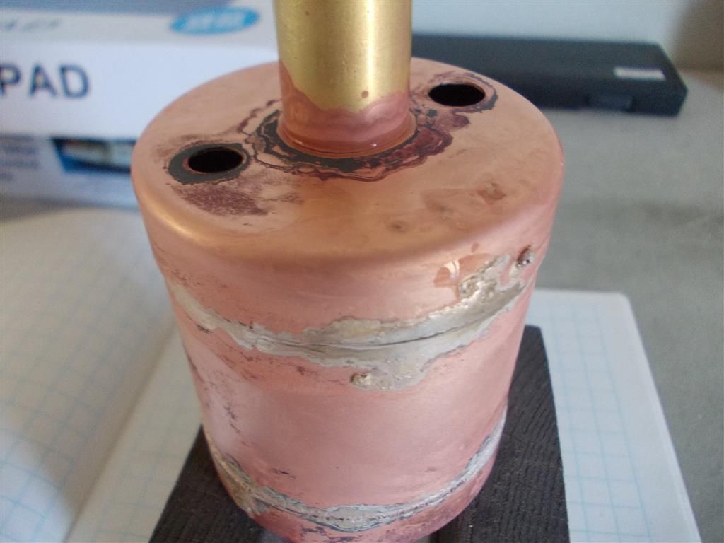

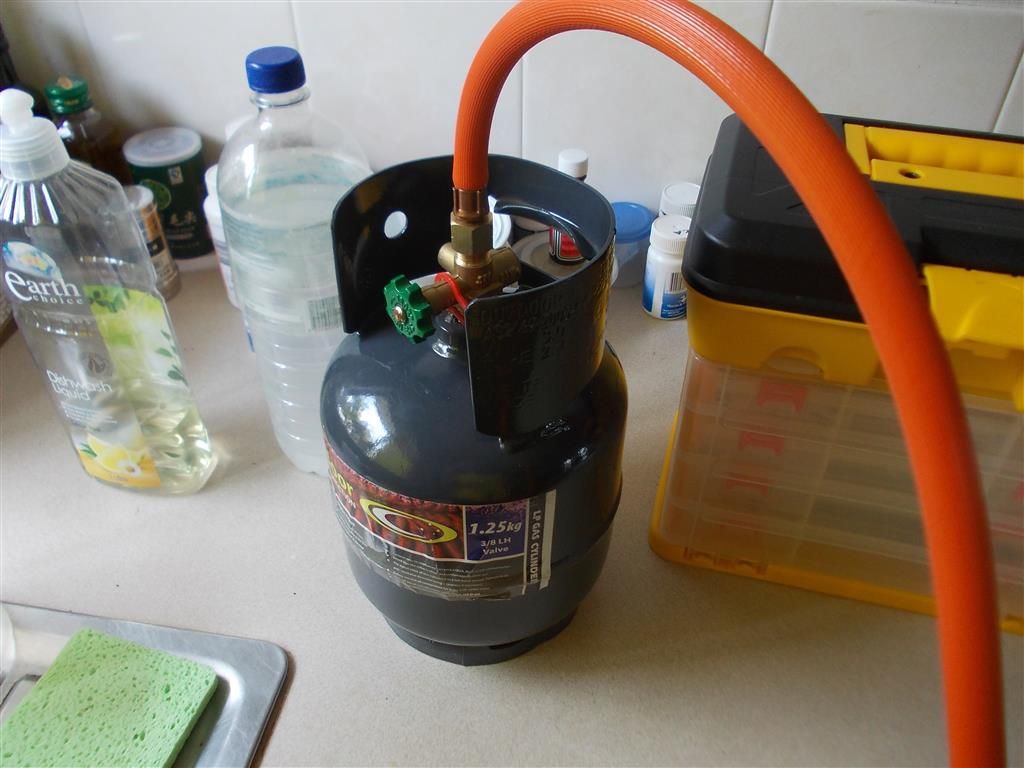

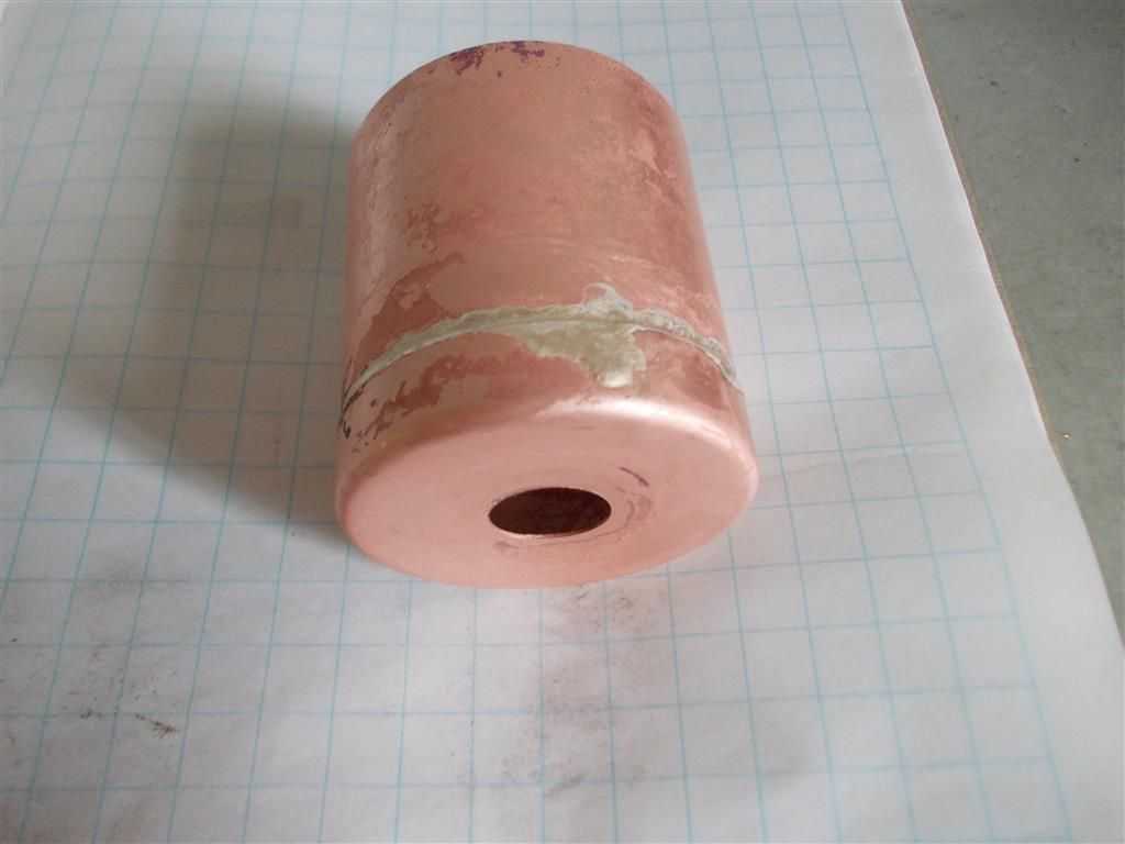

            Today I made the first attempt after purchasing the correct equipment. In the photos below you can see the full flame burner I used to silver solder the base of the boiler. Beside it you can also see the medium burner which I will use to solder the fittings (steam outlet and safety valve/filler plug). Tomorrow I will do the top of the boiler and the next day will be the chimney. I may do both the top and bottom of the chimney in one go…not sure yet.
            Everything seems to have worked well but there is a lot of heat. It uses a surprising amount of solder (expensive stuff). I am worried that when I try to solder the chimney it may melt all my previous work.
            I gave the soldered parts a wash in water then into the citric acid pickle for one hour before taking some photos. I have put it back in the pickle now. The solution has turned blue : has all the citric acid been used ie. should I mix a fresh batch and leave it overnight ?

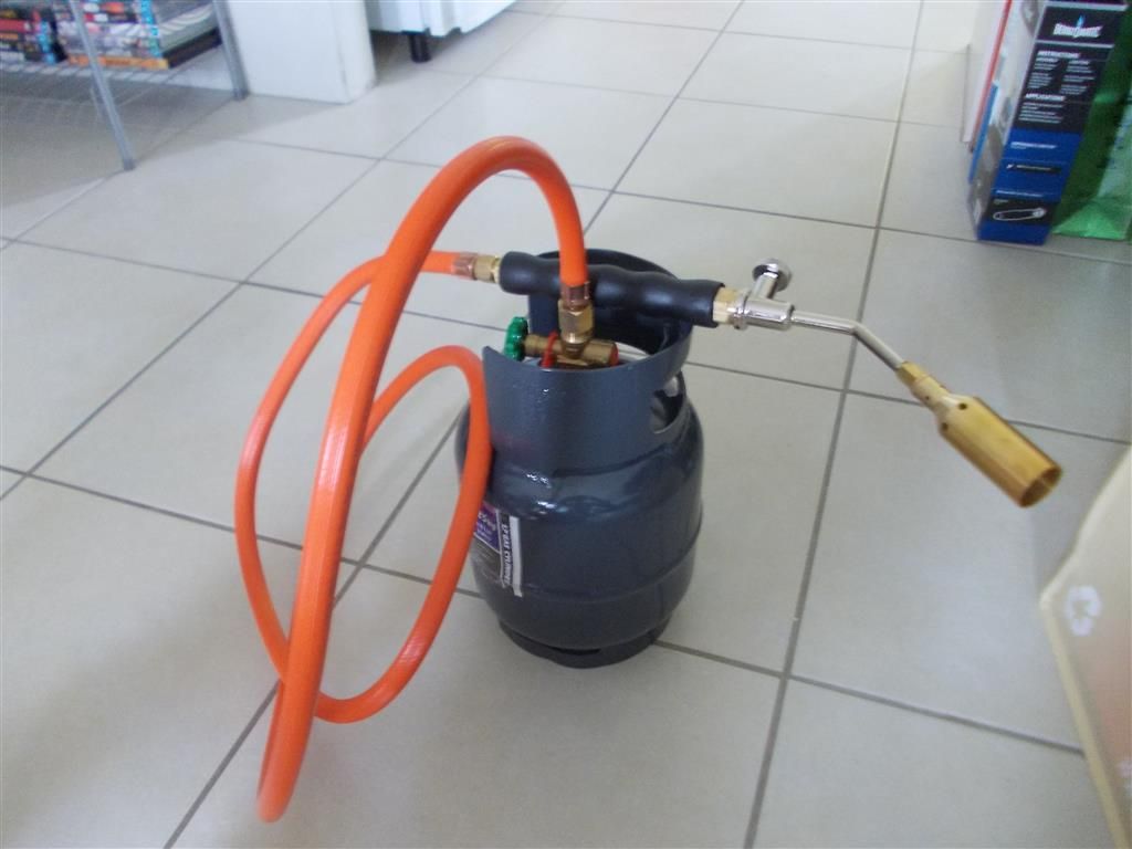

              Here is another photo of the new equipment showing the full flame burner attached to the handle. I have vented all the gas from the hose. I have been told that it is now safe to store it in this position….comments anybody ?

                That looks a very good joint for a first attempt, the solder has flowed very nicely around both sides of the joint.
                When you come to do the other joints just position the boiler in such a way that everything is supported and then you should not have too much of a problem with previous joints. Also once silver solder has melted it needs more heat to melt a second time so you should be OK.
                Some people prefer to place a few short lengths of the silver solder rod around the joint as that can be a bit more economical but I prefer to just feed in the stick once the job is upto temperature.

                        Brian, good to see you have got a good torch.
                        Just out of interest, you could not buy a cylinder like that one in NZ, dark coloured cylinders where banned last year, and only white (and I think yellow) cylinders will be filled. The cylinder I have for my emergency cooking set up is blue, and due for retesting, it will require a new cylinder. Reason, over heating when left in the sun, ie on the BBQ.

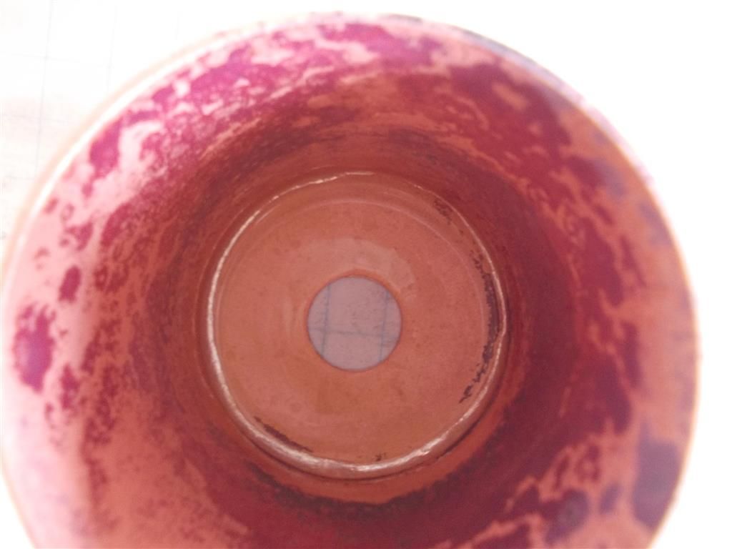

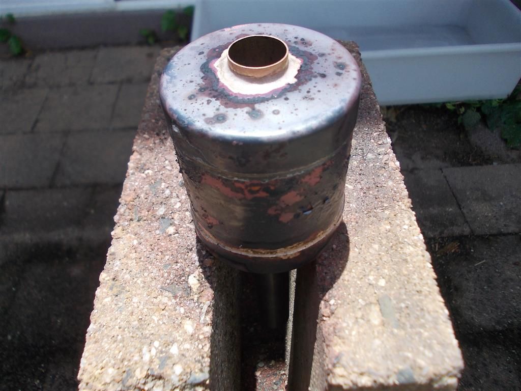

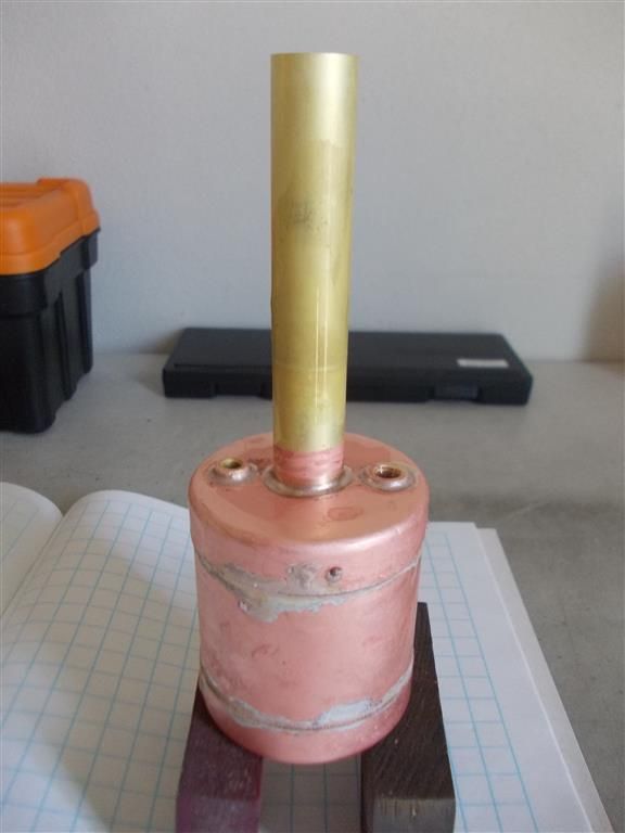

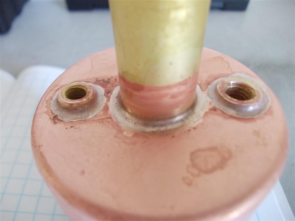

                                Stage 2 : I soldered the top cap (which is at the bottom in the first photo) and the bottom of the chimney (which is at the top in the photo). As mentioned previously, I fluxed the chimney and put some small pieces of solder around it. I then concentrated on soldering the top cap. Once I hit the boiler with the full flame it did not take long for the metal to get hot. By the time I had finished soldering the top end cap, the solder had already melted around the chimney : two jobs in one go. The second photo shows it cleaned up after one hour in the pickle.
                                In the third photo you can see what I have to solder tomorrow : the top of the chimney, safety valve and steam outlet which will all be done in one go. I think I will place small pieces of solder around the required areas and use the medium burner…not sure yet.
                                How do you clean the inside of the boiler ? I have to remove the black stuff from the outside by rubbing with a sponge which I cannot do on the inside.

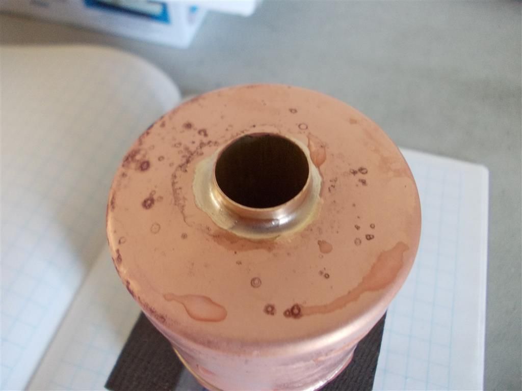

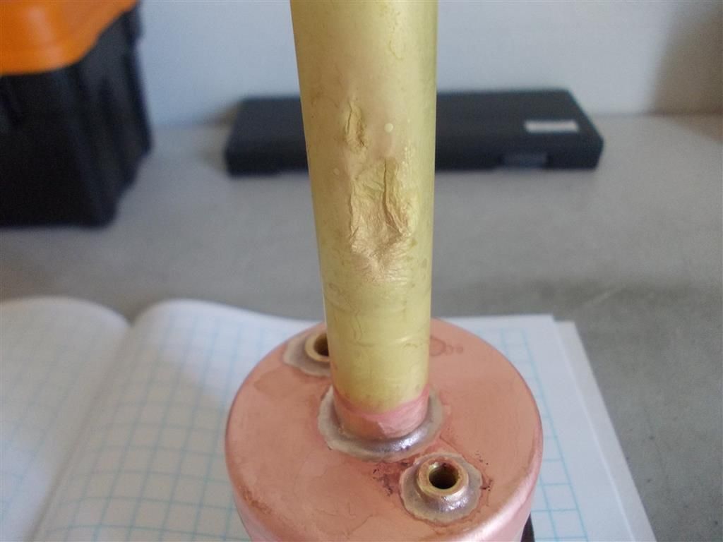

                                        I did use the full flame burner and the job is now finished but not without a slight problem. Look at the chimney in photo 2 : what has caused this…is it too much heat at this point ? I did not think brass would do this.

                                          Yes too much heat, the brass has almost become liquid and sagged under its own weight. I expect you were concentrating on the joint area and did not see the chimney getting hot further up. Solder joints a very good though.

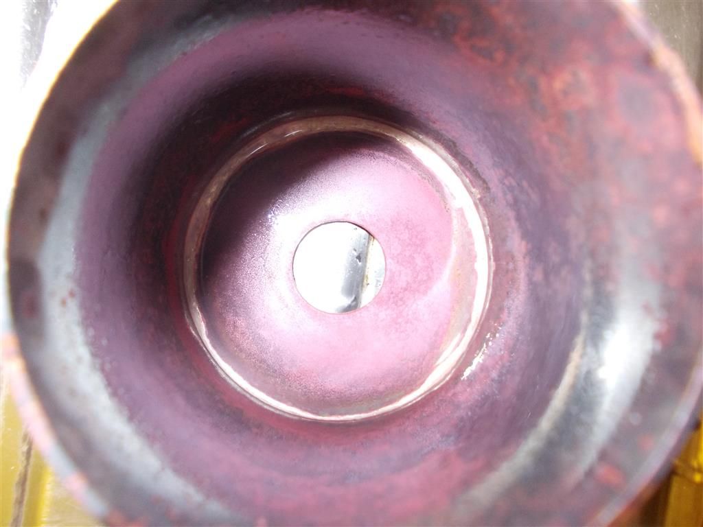

                                            So this burner can melt brass ! I did not think it could get that hot. Any thoughts on repairing the damage : a sleeve around the chimney perhaps or just leave it alone ?
                                            How do other people clean the inside of the boiler once all the soldering is finished ? I was thinking of dropping some small ball bearings inside and shaking it up.

                                              Brian, yes it will melt brass, often when I'm joining steel I use up some of a supply of scrap brass sheet, or brass wire if I can get it, my metal supplier doesn't stock it any more. I use a similar torch to your's.

                                                You need to reheat, remove chimney and fit new one. If you dont you will never be happy with it. Re soft solder, ensure you buy a reel which has lead in it. You can still get it and its loads better than the lead free stuff.

                                                  Something will have to be done ; overnight it has developed a small hole. My option are as follows
                                                  1. Remove it and get a new one. I do not really fancy trying to remelt this solder as I would have to melt both ends at once to get it out.
                                                  2. Cut it off and have a short chimney. This is probably the easiest option but it will look a bit odd.
                                                  3. Resleeve it with copper or brass tubing. The current chimney is 16mm OD (5/8'' = 15.875). I need something that will be a good fit. I will do this if I can find something to fit ie. ID is 16mm.

                                                    A bit of copper tube the same size could have a short length expanded at one end for a few mm, the damaged chimney cut off, and the copper one fitted over the stub and silver soldered on.
