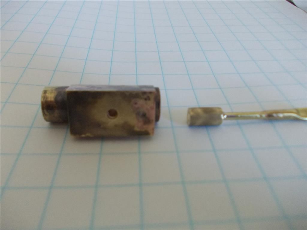

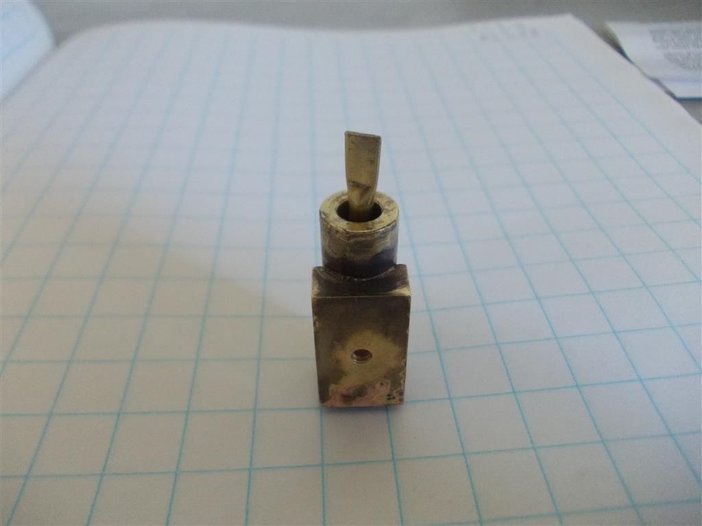

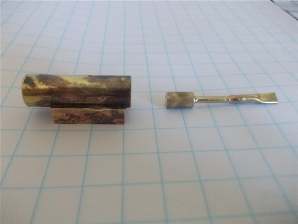

                I have had another go today. This time I changed things, I fluxed the joints then placed pieces of solder wire on this flux. I then applied the torch to the metal until it was as hot as I could get. The solder was almost starting to melt so then I applied the flame directly to the solder. I know this is not how it is supposed to be done but I decided to give it a try anyway. It seems to have worked but I doubt that I could use this method for soldering the boiler.
                Problems :
                1. I have managed to solder up the steam hole so I will have to drill that out.
                2. I have dipped it in citric acid for a few minutes then worked on it with the Dremel tool fitted with a wire brush. I will put it back in the citric acid overnight. Should all the pink colour be removed from the brass ?
                3. I may have stuffed up the piston. There was some solder on it and I removed it by placing the piston rod in a drill and applying 400 grit sandpaper to the surface of the piston. The piston may not be a tight enough fit in the cylinder now. I will have to try it and see. I should have used 800 grit which is what I usually use for this sort of job.

                  I cleaned it up and put it together and it runs like the clappers. The piston probably could have been a better fit but it does not seems to make much difference.

                              If the piston on your little wobbler is a bit loose, take it out and turn a bit of a groove just a bit below the crown of the piston, and wrap a twisted bit of Teflon plumbers tape in the grove, put it all back together, it probably won't go faster, but it will have more power.
                              In the 4 or 5 wobblers that I'v built, the cylinders have been built up using tin lead solder. The pistons made by drilling, and tapping, and the con rod screwed in, except for the little one where the piston/con rod are one piece stainless steel.
