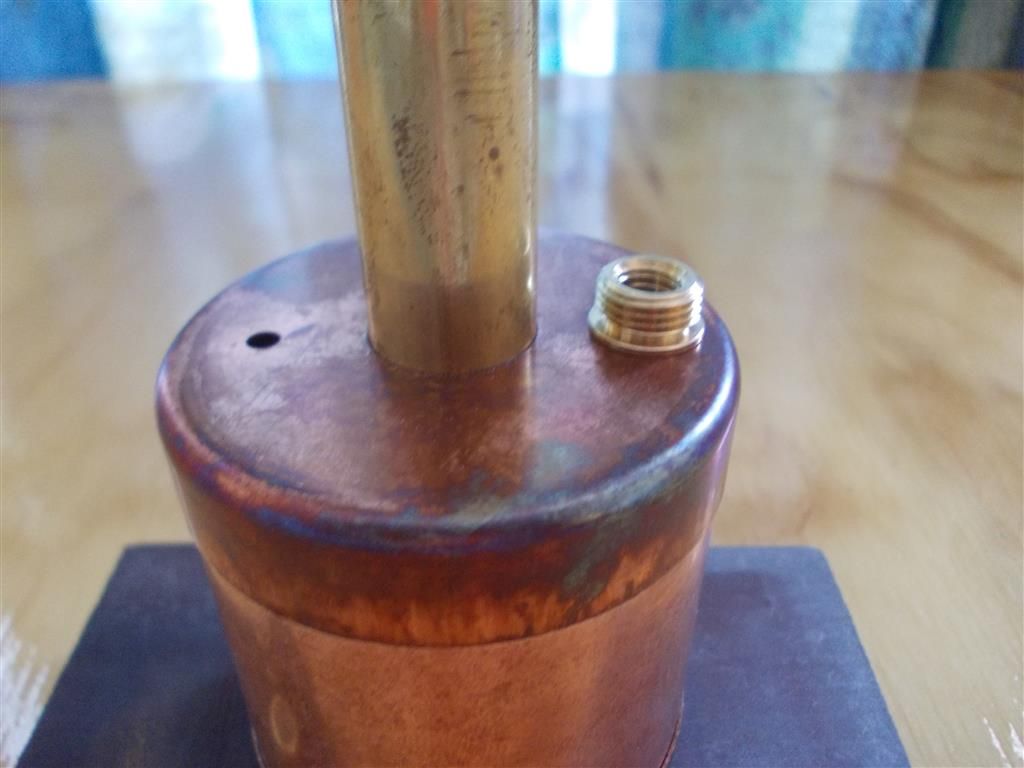

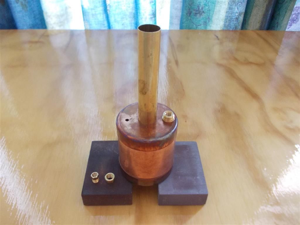

        I am building the Midwest Steam vertical boiler. I am hoping it will produce enough pressure to power my 3BIM and 7BIM engine from PM Research. I require some advice about soldering the boiler.
        1. I will be soldering the ends first then I will add the chimney then the boiler fittings (filler cap and steam outlet). I am worried that when soldering the chimney and boiler fittings that this will undo the ends which will have already been soldered. Should I be concerned about this and how do I get around it ? I was think of using a much smaller propane torch for the later stages.
        2. The small hole on the top left of the boiler is for a 1/8 inch pipe to be soldered in but I intend to replace this with a 1/4 inch boiler fitting with a 3/16 adaptor. You can see them sitting on the block of wood on the left.  Any comments on this plan ? Update : I have just found a 3/16-40 boiler fitting in my plumbing box so I will use this instead.

          Brian, what solder do they provide in the kit, I think its just soft solder rather than silver.
          If you solder the top first, then stand it as you have it now to do teh bottom & fittings they should not move. You may need to pack up the chimney so it does not drop through but the other parts won't move.
          Is the right hand hole just a filler with cap? if so you will have to add a safety valve as I think the idea with this boiler is that if the pressure gets too high the flexi hose will just pop off of the 1/8" pipe which gives the effect of a safety valve. This won't happen with threaded fittings

                  That one has added a safety valve due to using rigid pipework. And looks to be soft solder
                  #168223
                  John Bromley
                    @johnbromley78794
                    I think these boilers are desisgned for use with small oscillators in mind. So any excess pressure would push the cylinder away from the port face.
                    But if they sell the boiler kit as a stand alone product, then they should provide a safety valve.
                    I would recommend drilling the top cap for a safety valve bush if you havn't already.
                    If you intend to use this with non oscillator type engines, silver soldering it may be more suitable. Without knowing to much about this particular boiler, other than what can be gleaned from the video above, a max working pressure of 10-15 psi would seem plenty.
                    I built a small boiler not so different to this one and it runs at a max 15psi, plenty for most small engines.

                      1. No solder is provided with the kit. I have purchased the correct silver solder and flux from a model engineering firm.
                      2. Yes, the boiler is designed to run the small oscillating engine (provided in the kit) which I am also building. This requires some soldering of the brass parts as well so it will be a good learning exercise.
                      3. I had not considered a safety valve but it seems like a very good idea. Would a 30 pound safety valve be okay ? This is over twice the working pressure.

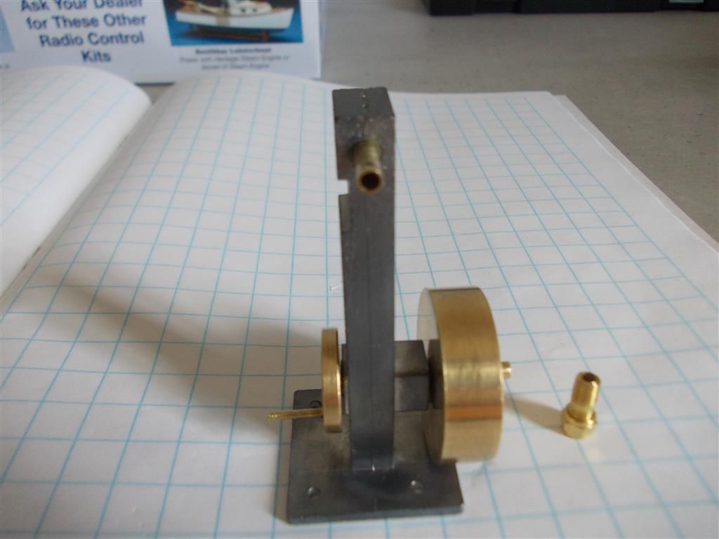

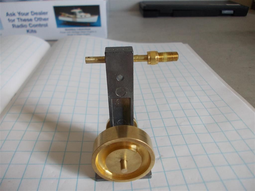

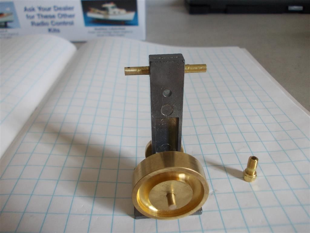

                                                      I would also like some advice on the engine side of things. I want to put a threaded fitting to the steam inlet pipe but I suspect that the mainframe is white metal. If I try to solder the fitting then the mainframe will melt. I sent an email to Midwest Products to ask what the mainframe was composed of but it bounced back.
                                                      What are my options for fixing this threaded fitting to the steam inlet pipe ? Photo 3 shows how I want it to end up.
