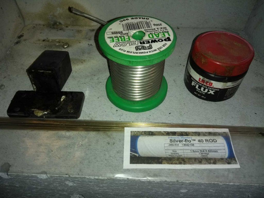

      I'm trying to do some silver soldering. I've done electronics soldering and plumbing soldering, but I seem to be getting this one wrong.
      Top right of the picture is what I'm trying to solder. a bit of 1 inch square mild steel onto a mild steel bracket.
      I've tried with the newly bought silver solder (and flux powder) and then with my plumbers solder and flux.
      In the case of the silver solder, I got the items to dull read heat, but the solder would not melt when placed on the join. It would soften in the heat of the blowtorch.
      In the case of the plumbers solder the metal was hot enough to melt the solder on contact, but it would not flow under the join.
      In both cases, I'd sanded of filed the surfaces back to metal. In the first try I'd raised little bumps with a centre punch all over to make sure there is a gap (having read conflict views in this forum, I thought I'd try both!). This was likely filed of prior to the plumbers go.
      My second question is 'can I use the plumbers solder and flux on steel and the like?'. As I already have it and silver solder and flux is not cheap.
      As usual any help would be much appreciated!

                  First off, plumber's solder and silver solder are very different things and require totally different temperatures and fluxes to flow. Plumber's solder melts at around 230-250C and silver solder around 650-750C. Both require a flux to prevent oxides forming when heat is applied, but the fluyxes are very different. Silver solder creates far stronger joints than plumber's solder., but although either can be used to join steel items, silver solder is the recommended way to go.
                  The flux for silver solder is usually sold as a powder that is mixed with a little water to form a thin paste with the consistency of thickish cream. A drop of washing-up liquid will help it wetting the work. It is also possible to get the flux as a liquid.
                  The basic process is to flux the surfaces that you want to solder and then start heating the joint area with a blowlamp. The joint area must be clean – solder will not flow over dirt or oxide. The flux does a certain amount of cleaning, but don't rely on it entirely.
                  Initially, the flux will bubble and become slightly foamy, but will clear with continued heating. Typically, the solder wire/rod is dipped into some flux and then touched onto the joint area. If the joint is hot enough the solder will melt and flow into it, otherwise remove the solder and continue heating. The solder will flow towards the heat, so it is important to heat the joint and remember that small items heat up quicker than large items. Play the flame mostly on the large item so that the joint area for both reaches the correct temperature at the same time. If the solder melts into balls that don't flow into the joint then the the joint isn't hot enough – or you have taken too long and burnt the flux. Two or three minutes is too long. If this occurs, cool the job down, remove the burnt flux, clean the joint and start again.
                  I hope this helps.

                    If the silver solder won't melt when touched to the work, then the answer is simple – it isn't hot enough.
                    Plumbers solder will work on steel, but is much less strong. The Laco flux is rosin based and I don't find it aggressive enough for bulk steel, try Fry Powerflow which is a paste that contains hydrochloric acid. Powerflo is not nice stuff and will cause corrosion if you don't claen off every trace of it afterwards.

                      First off – neither of the two fluxes in the picture are suitable for use with what appears to be silverflo 40. There is what appears to be a JM label but unless there has been a dramatic turn around I do not believe that the material was supplied to you by JM. They do not supply it by the rod! And CuP do not use JM labels!
                      So what advice does your supplier offer? I would be interested to know.
                      Secondly. You should be able to melt the silver solder with a plumbers torch – as long as you are generating enough heat.
                      If the steel is a dull red the silver solder should melt a 40% silver cadmium free alloy
                      Thirdly, if you can melt the silver solder but it doesn't flow then change your flux to one with a longer life eg HT5 from CuP Alloys.
                      Fourthly, if you can't melt the silver solder then use a lower melting point alloy eg 455 from CuP Alloys.
                      Why do I keep plugging CuP Alloys – because they are the company that can supply good quality materials and give the technical help to get the right results.
                      Silver solder is expensive ….. especially when it doesn't work!
                      Keith

                        Keith if you look closely at the "lable" it is infact a printed photo of a JM cardboard tube with the lable on it, common for e-bay sellers to use this when they split it down into smaller quantities eg 10 (short) rods.
                        Most sell with Easyflo solder which going by the size of the metal in the photo and a "blowlamp" was probably exhausted before the work got upto temperature.
                        Iain, Try it on something small and then that will rule out any fault with the flux, that then leaves you needing HT5 or Tenacity No5 and/or a bigger heat source.

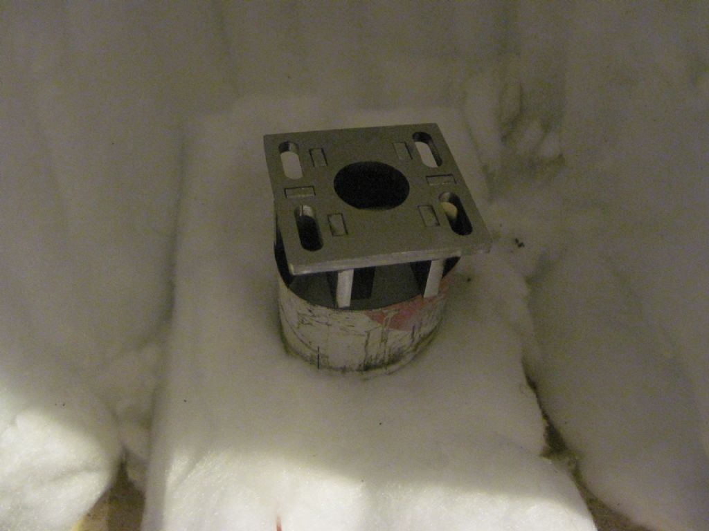

                                In terms of "sufficient" Iain – sometimes 'retaining' what heat you already have available can make enough difference between it working ok or not.
                                Ceramic blanket is not too expensive (I think I paid about £6 for my last one) and does help with larger pieces when brazing or silver soldering. It's not perfect for long term use like this but is a good solution if you don't want the bother of a buying a proper brazing hearth.

                                IanT

                                    Here is an example of a small fabrication that was brass brazed (which needs more heat than silver solder). It is surrounded by ceramic blanket (to throw the heat back) and also stood on a thin tin stand (which doesn't leech the heat away). So take a little time to make sure everything is both clean and set-up to retain as much heat as possible and then get the heat into the larger piece as quickly as possible – trying to avoid direct flame on the fluxed area to begin with – until you have heated the main mass. Someone else has suggested practicing with some scrap to get an idea of how it all works – and that's a good idea the first time around.
                                    Keep trying – not all of my attempts work first time around – even when you think you've 'mastered' the art. I just go back and clean everything back to clean metal and try again..
                                    Hope this helps – good luck.
                                    IanT
