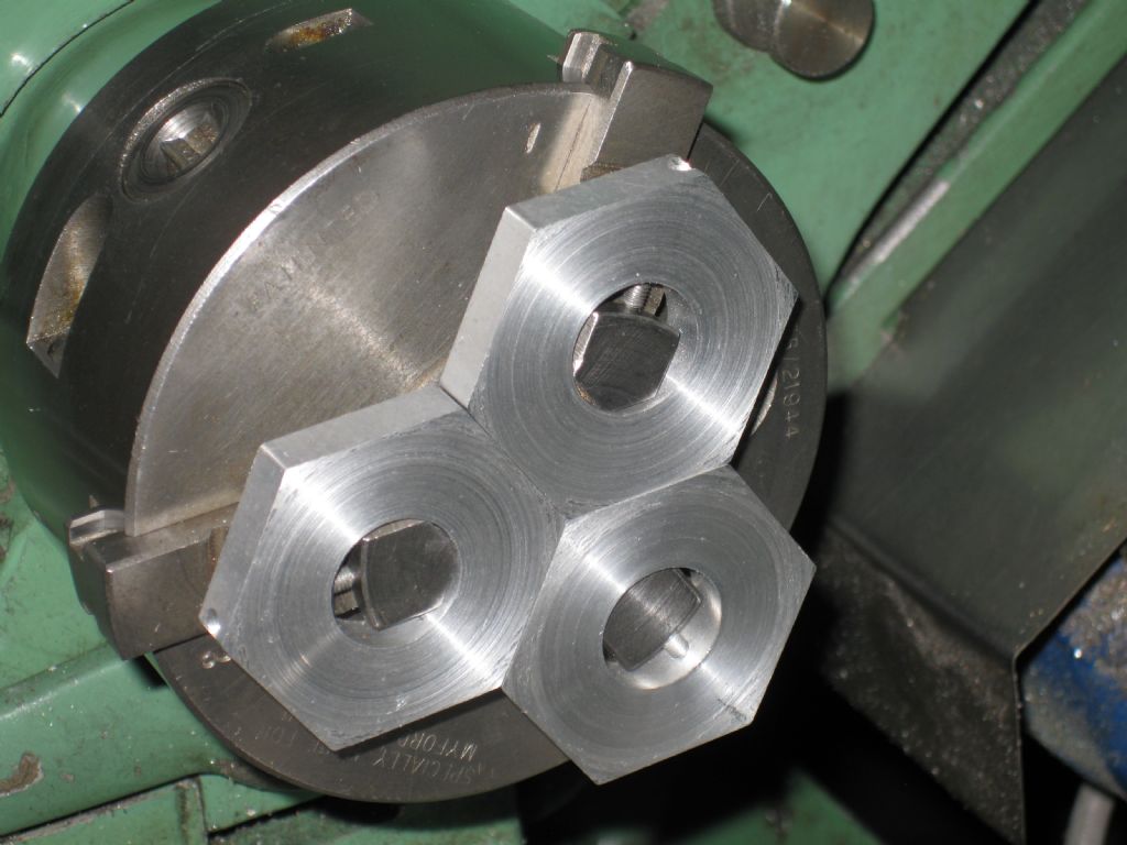

      Somewhere, sometime ago there was a description of how to make soft jaws for a 3 jaw chuck. The method used hex aluminium with holes bored through the centre to fit over each jaw projection and secured somehow to the jaws.
      Does anyone remember the design and where I would be able to find it? A Google search doesn't bring up anything for me.
      I have seen Harold Hall's design, but I don't want to drill the jaws of my Pratt Burnerd chuck.

                  There is another version here: https://www.cgtk.co.uk/metalwork/m250/hexsoftjaws and that references MEW 224.

                      Posted by DC31k on 29/07/2022 14:34:45:
                      That's it DC. Many thanks.
                      Also, your idea Mike was one I had seen before but had forgotten about.
                      Now to put some redundant ali hex to good use.

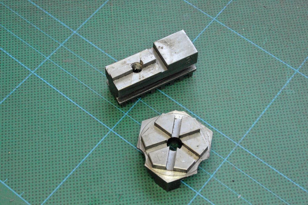

                                                  DC31k
                                                    @dc31k
                                                    Posted by ega on 03/08/2022 09:45:31:
                                                    The precise construction is not clear, to me at least, from the Myford leaflet
                                                    The photo below the Myford leaflet explains it very well. The groove in the hexagon locates in the tongue on the base jaw. The flat of the hexagon (which is perpendicular to the groove) locates on the step in the jaw, the back side of the cross-groove milled in the jaw.
                                                    It relies on the pressure from the work pushing the soft jaw against the step, so only five out of six degrees of restraint are provided, so you could not grip the inside of a tube with the jaws, but for normal, external gripping, it should be highly repeatable.
                                                    The concept is 50% of a traditonal tenon-and-groove two-piece jaw setup. See for example,
                                                    https://www.chestermachinetools.com/product/3-jaw-self-centering-2-piece-jaw-chucks-plainback/
                                                    Soft Top Jaws for Bison 2 Piece Jaw Chucks American Cross Tenant By Bison
                                                    For information, this type of jaw is made to ASA B5.8 or IS 15248 2002 or ISO 3442 (and the dimensions in the international versions are direct metric conversions of the original imperial units).
                                                    Have a look at 11:47 onwards here: https://www.youtube.com/watch?v=JplJAxX3buA

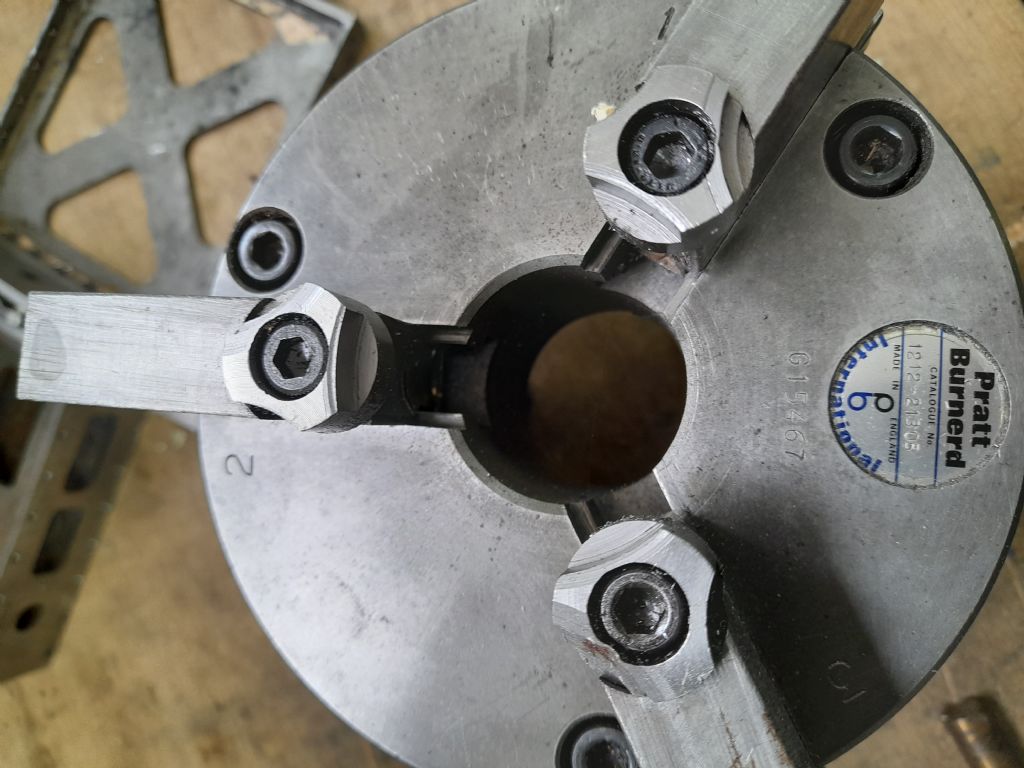

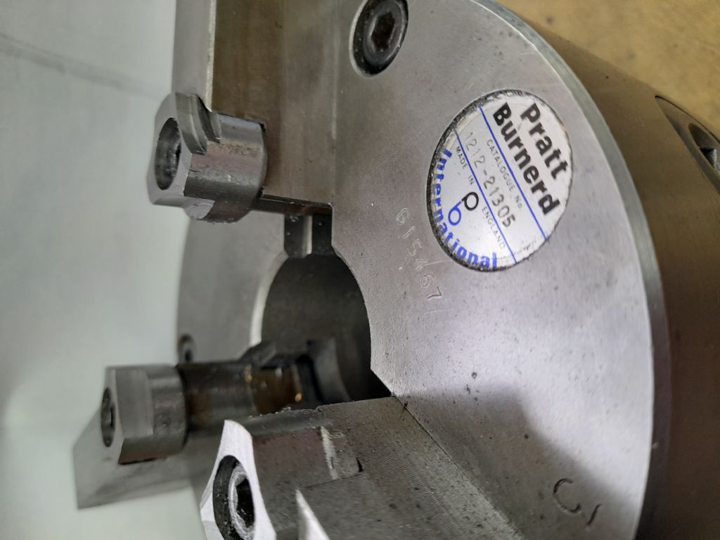

                                                      Just to show that I do follow up on the answers to my questions. Well, some of them!
                                                      These are my soft jaws. 2-1/4" Ali hex. The holes are .700" and the jaws are locked in place by M3 cap screws with the heads reduced in diameter a few thou. The front faces have deliberately not been faced.
