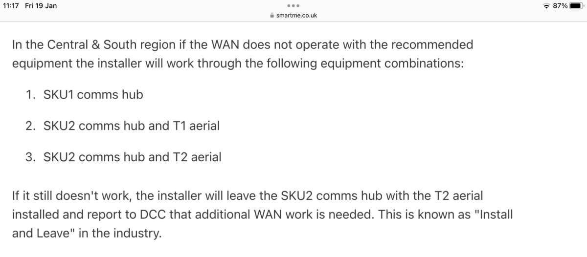

                    #708437
                      From my limited understanding … this [from the link that I posted] seems the most probable outcome:
                      IMG_9262
                      … But the situation might be saved by ‘the Mesh’ and it’s understanding at that level that I was hoping to gain.

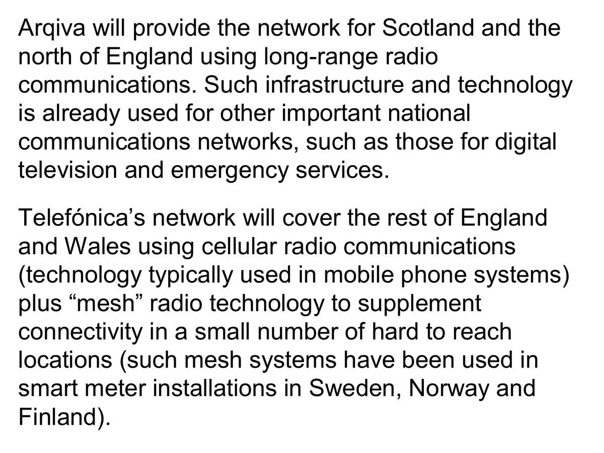

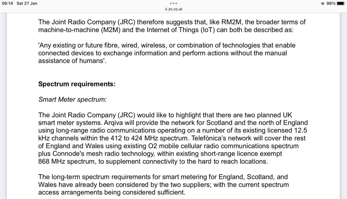

                                              Third: I found some references yesterday to ‘the Mesh’ and would grateful for a sanity-check by anyone familiar with such matters
                                              An apparently undated document from JRC
                                              https://www.jrc.co.uk/Plugin/Publications/assets/pdf/ICT-Promoting-Innovation-and-Investment.pdf
                                              IMG_9291
                                              A U.K. Government information leaflet
                                              https://assets.publishing.service.gov.uk/media/5a7497bced915d0e8e399740/Smart_Metering_System_leaflet.pdf
                                              IMG_9290
                                              These are both brief, but the messaging seems consistent … and at my location invalid 🙁
