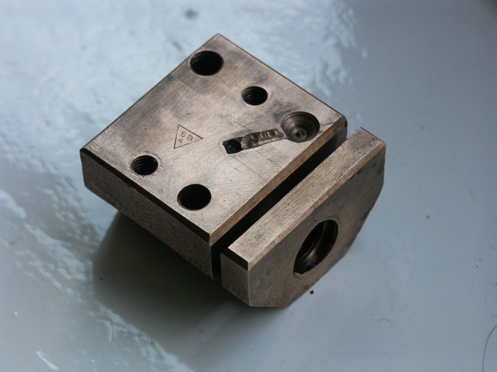

      Hi All
      I’m in the position of having to make a replacement nut for the cross slide on my Smart & Brown lathe.  I am puzzled as to the purpose of the slit at one end that penetrates halfway across the thread.
      Any ideas?
      Regards
      Brian G3oyu.

          Hi
          If you mean the full width slot at 90 deg to the thread axis – is there any provision for applying pressure the the “unsupported” bit to close it up and adjust the backlash – or possibly to insert a backlash “eliminator”? For the angled short slot – a lubrication path maybe?

            I’m not sure, but this may be a passive backlash eliminator. the thin end after cutting at the factory could have been given a press or bash to slightly deform it toward the main part of the nut. This would result in a very slight deformation of the thread pitch. When assembled to the leadscrew the thin end would spring back to conform with the thread pitch, but the interference force would take up some backlash. This would be rather rough on the leadscrew, but maybe they used a hardened leadscrew.
            On other antilbacklash systems in different machines separate springs and other devices do the same thing.
            The angled slot on top is an oilway as Keith mentioned.

              Thank you all for your suggestions, it is much as I thought.  No there is no means of applying pressure to the thin end of the slot once the nut and screw are assembled into the cross slide.  I think the suggestion that a good wack with a hammer to slightly deform the nut prior to assembly is the correct one.

                    Many thanks for the reply and thoughts.  I too have doubts about S&M making something that needed a wack to set it up!  My machine is a Model A and is otherwise a fine machine.  It already performs well on brass and free cutting mild steel.  The problem became apparent when I tried machining silver steel, because it is rather tough the cross slide clearly started to move around on the backlash.
                    I am looking at modifying the new nut to incorporate some backlash adjustment but just how to do this satisfactorily has yet to be decided.  Something similar to your suggestion Keith seems a good possibility.

                        Thanks for the comments Steve.  I’ve been doing some further research this morning and find that beneath some crud there is a socket head grub screw, in the top of the cross slide, with a cone shape at the bottom that when screwed in does in fact act on the slit thereby opening it out.  This will take up some backlash but how much I don’t know.
                        So no ‘bash’ with a heavy hammer needed!

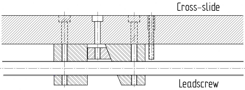

                              Turns out that my memory of the cross-slide backlash adjuster wasn’t quite correct. The one I described is how it works on the top slide, not the cross slide. But since the cross slide one is slightly more interesting, I did a very quick drawing of it, just so you get the idea. This isn’t my idea of a good machine drawing, incidentally – just quick and dirty to show the principle, and with all sorts of things like bolts left out (the bit on the right that I forgot to label and is irrelevant anyway is the oiler hole):
                              The bolt in the centre hole pulls the wedge block towards the cross-slide, forcing the threaded nut blocks either side of it apart – instant backlash elimination.

                                What I forgot to add was that I much prefer this version of a backlash eliminator to the one that distorts the nut, simply because there is an even axial force on the leadscrew, rather than a potentially distorting one that will cause uneven thread wear in the long run. I don’t know about you, Brian, but if I was going to fabricate a new nut, I would have thought that a version like this would not be too difficult at all to make. Looking back through the thread, it would appear that doing it this way is very similar to Keith Long’s suggestion – only adjustable in situ – always an advantage!

                                        Brian, you have correctly deduced the backlash adjustment on the Mdl A, the taper tipped screw opens the split to reduce the clearance. Make sure that you adjust the nut on an unworn part of the screw or it will bind when you do move to an unworn area. It is probable that most of the backlash can be adjusted out, but any remaining will be due to wear in the scew, not the nut. This will manifest itself as a variation in the backlash over the range of movement. If this is unacceptable, it is the screw more than the nut that needs replacement.
