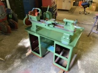

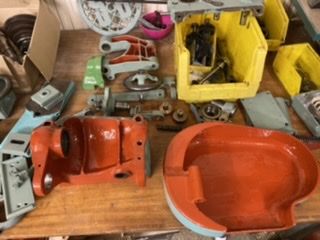

        I’ve been busy and finally got the new paint. I like it MUCH more thankfully.
        Reseda Green Cabinet
        Almost everything is primed now and I’ve started painting the parts that were originally left in red oxide in RAL 3011 brown red. It’ll be a nod to the red oxide but much harder wearing.
        RAL 3011 insides

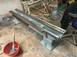

        The bed has come up very nicely as has the saddle but not was a pain to strip.
        I still haven’t fully stripped the worm drive. I think it had a circular ring screwed on with a hole to turn it but I’m not 100% there. Anyone recall how it comes apart?
        Bed primed

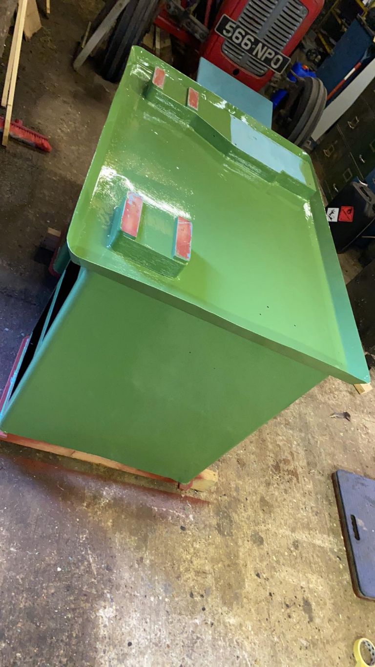

                  Almost finished the painting now and I’m pleased with the results.
                  really only got to finish sanding back the filler in the headstock top cover
                  Waiting on the delivery of the Southbend 9” service kit from the US but it’s in the country at least
                  Here’s some photos.
                  I wanted to keep this.
                  this came out really well.
                  And finally some idea of how it’ll be once done.
                  I have noted that the holes in the bed don’t line up with the holes in the cabinet risers. I’m hoping there’ll be some place in the cast blocks on the bed which are bolted In place.

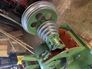

                    Assembled the motor pulley sub assembly which I’m pleased with. Do you like the red?
                    also got the 3/16×32 W LH die today and cut a test piece. Very happy to report that it fits, so if anyone else needs one, holler!

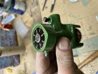

                    Question about the thread cutting indicator. When I reassembled it, the dial wasn’t indexed at all to the drive. Does it matter where the indicating dial plate sits on the mounting plate?
                    Cheers, Jim
                    #482215
                    old mart
                      @oldmart
                      The threading indicator top with the printing should turn with the gear, but be possible to slacken off the central screw to get it lined up with the datum on the casting. The datum will be a simple paint radial mark, yours probably goes where the top edge gets wider at 12 o'clock when it is fitted to the lathe. The dial must not slip relative to the gear, unless you are adjusting it. This type pivot to disengage the gear from the leadscrew to avoid unwanted wear when you are not threading.

                        Turn the leadscrew and the dial will turn to wherever you want it to be. Move the carriage along the bed and the dial will turn to wherever you want it to be. There is no datum to line the dial with the datum on the casting. If you are saying there is a mismatch between a point on the dial and the datum when the half nuts are engaged then the answer is it doesn't really matter as long as you know what the error is.

                            what I’m trying so say (badly) is that the painted plate on the thread indicator has come adrift of the driven plate below it.
                            there’s some signs of adhesive between the two or it could just be grime.
                            When screwed on, the etched plate is sandwiched to the driven MS plate below it, but does the relative position to it matter?
                            Should I glue them together as a sub assembly do you think, and if so does the relative position matter?

                              Commonly the dial is just a locked to the shaft by the screw so that it can be adjusted to line up against the index mark when the half nuts can be engaged. Drive forces are tiny so its not going to move.
                              One of my SouthBends (I think) was annoyingly far out. Fixed by loosening the screw, moving the saddle so the half-nuts could be engaged, resetting the dial to align one of the full, numbered, marks with the index line and tightening the screw.
                              Job done except I was bit over precise and set the dial so the marks came up to alignment at the first point the half nuts could be closed. So in practice the engagement point was just after the marks had gone past alignment. Still annoying asI'm much happier with just coming up to marks than just gone past it on, well, pretty much everything. But not quite annoying enough to be sorted.
                              Clive

                                thanks. I think that’s what I needed to know.

                                  If the dial slips on its shaft, then put a washer under the head of the screw. Don't fix it so that it cannot be moved when required.

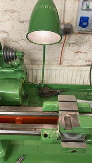

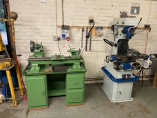

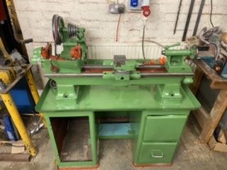

                                    Finished the electrics on the cabinet so have moved it to where it’s going to live.
                                    Also I’ve added a period looking lamp
                                    buggered if I can afford a proper MEM Light so this’ll have to do.

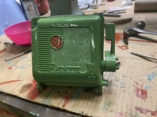

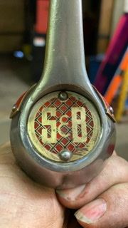

                                    And finally, I’ve been renovating the forward reverse lever labelling.
                                    Getting there.

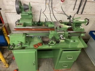

                                      Lots of progress since getting the Southbend service kit.
                                      worked until 3am this morning putting the gearbox and carriage back together and this is the result after a couple of hours tonight.
                                      it’s really coming together now and I’m loving the colour.
                                      The felts are a bit of a ba****d to install but all done (hence 3am). Only the headstock to rebuild and she’ll be ready to rock and roll.
                                      Looks well next to this weeks new addition to the shop….
