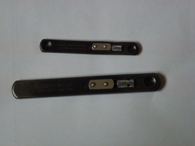

            Clive Brown 1
              @clivebrown1
              My favorites are the Eclipse 244 and 245. Covers 0-1/4". I find they give a very good feel with less risk of careless bending, and thus snapping, of small BA sizes. Can sometimes be found on ebay.
              I only use the chuck type if the extra reach is useful.

                  With the 244 and 245 "Super" type you might need a female spring-loaded centre as the smaller taps often have a male centre. They have the advantage of taking up minimum headroom, of course.

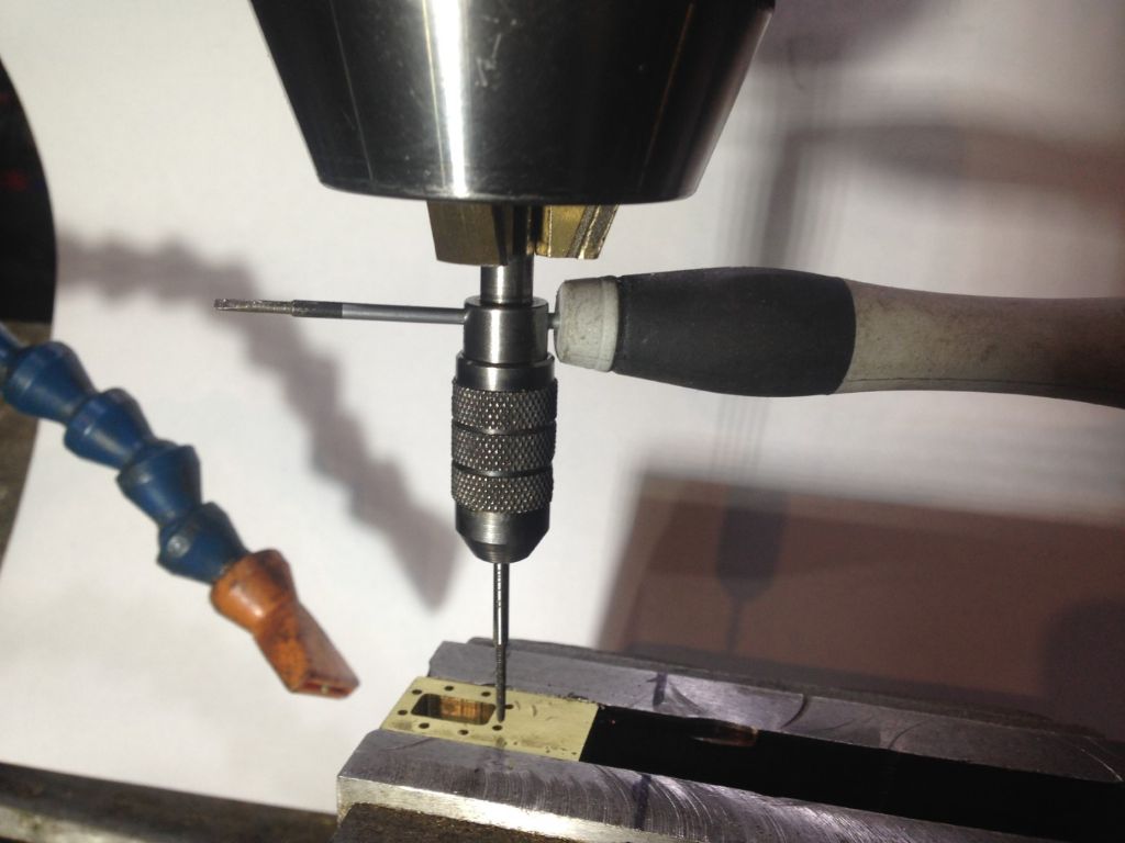

                        I use an Eclipse pin chuck for drilling small holes and tapping. It has collets which hold drills from 0.75mm – 2.5mm.
                        The collets have 4 jaws and suited for holding the square end of small thread taps. A hole thru the base is used for a torque bar when tapping threads. Drill chuck loosened and used to guide tap.
                        Paul.

                              Threading under power is handy but a sure way to break standard taps. Especially small ones. The one shown is cutting an M 1.4mm thread.
                              Paul.

                                  Posted by Paul Lousick on 04/08/2020 12:20:27:
                                  Paul.
                                  Edited By Paul Lousick on 04/08/2020 12:29:29
                                  That's a good idea Paul – I've got that exact pin chuck in my modelling drawer, so I'll use that. I just checked and it fits the smaller BA sizes very nicely. TBH I hadn't considered it because I thought it was a 3-jaw type.
                                  Thanks!
