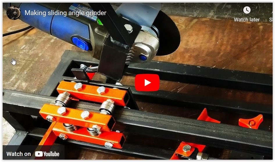

                          A bandsaw is a very handy tool in the workshop but an option is to use a sliding angle grinder guide. Lots of DIY builds on the Internet, Youtube, etc.

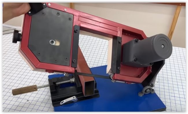

                            Video of a DIY bandsaw on Youttube using wooden wheels and a simple sliding angle grinder guide. . **LINK**

                              After seeing some Youtube videos I changed my mind, no more table saw. It is too dangerous comparing with the band saw. Some of the causes of accidents are not even that obvious.
                              I did some research and I found that for a 1mm thick blade you need a wheel at least 18" in diameter. That might be difficult to turn in my lathe. And I don't know from where to buy a bar with that diameter. I'm looking for some thick delrin plate, or another strong plastic.
                              The only progress so far is that I found a local company that sells carbide band saw blades at any length you want. So I'm not constraint to some predetermined diameter.
