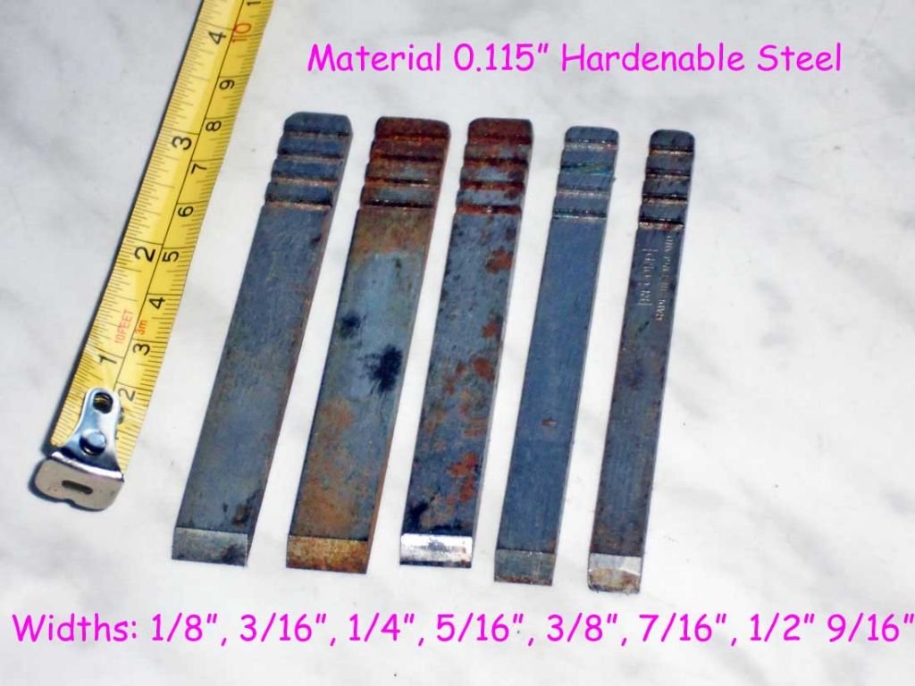

        Hi All,
        I have quite a few old plough planes by STANLEY & RECORD UK which all require sets of cutting irons. Although the two makers planes are essentially similar there is a difference in the way the adjustable irons work, also the numbers of irons in each set.
        In order to sell well they really need a full set of cutters, not just the one or two they usually arrive with.
        I have made a set in the past by hand on the milling machine and filing but as I need approx 20 sets made in at least 3 different patterns, that is 20 sets of EACH pattern CNC seems to perhaps be the way to go if economic.
        The original material is 'Tungsten Steel' but any suitable grade that can have the cutting edged hardened & tempered will be fine.
        Here is a photo of the ones that I need most urgently they fit a RECORD UK model:044.
        I can supply a drawing in Fusion 3D with the material laid out as a sheet with all the grooves running across the top and would need to know the way that the irons would be separated to width.
        Milled, slitting saw, brake press??????
        I would not trust my drawing to be useable for CAM though as I have never done this before. May need to be redone by the operator.
        Hopefully someone on here may take up the challenge at a price I can afford !?
        The other set I need urgently is only 3 blades per set with no grooves in 1/8", 3/16" and 1/4" widths; 3 1/2" long. 15 sets required.
        OR am i really in dream land?
        Cheers., Martin

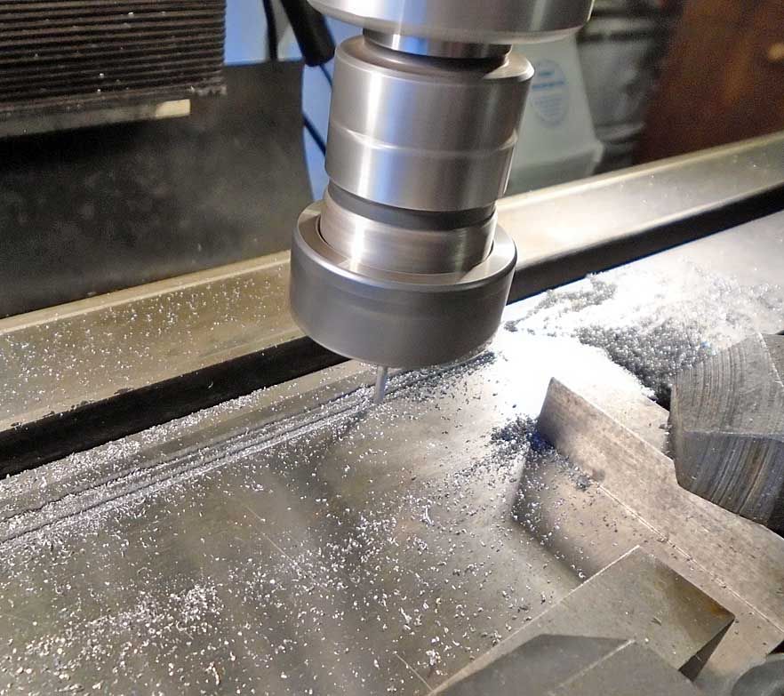

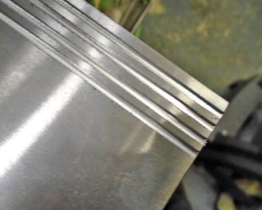

                                          I have had a go at milling these grooves myself and it has cost me about 4 carbide 2mm cutters so far!
                                          Bit of trial and error with speed and feeds has finally got it sorted out:
                                          Funnily enough faster feeds worked better although still pretty slow work. Most of the breakages were at the end of the cut accidentally bumping into the uncut previous pass. Fortunatly I have lots of small cutters that I have never had cause to use before. I trammed the work in with a Dti and total runout is only about 1.5 thou over the distance milled.
                                          It does look like I am going to have to get this done on a horizontal mill to make sense for the quantity I need.
                                          Some progress though, I will get these cut to length in the week and see how that goes.
                                          Cheers, Martin

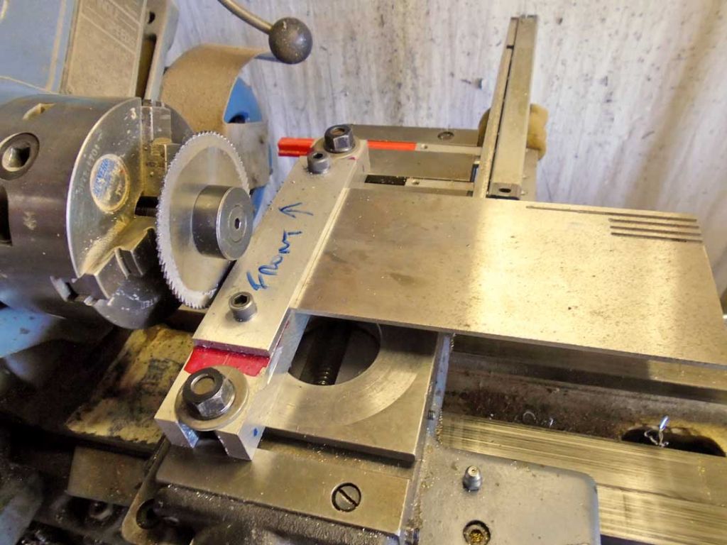

                                                  Finally got around to having another go at these plough plane cutters.
                                                  I have several RECORD & RAPIER 043 type small planes all with no cutters. These are quite wanted so had to sort it out!
                                                  I finally came up with this fixture made to hold the gauge plate exactly square, clamped by the top plate:
                                                  Using a 1/16" HSS slitting saw at low speed in back gear I was surprised how easily the cut went, no chatter, or nasty ringing sounds this time. I used lots of oil on the blade and a slow but constant feed. I fed the stock after each cut allowing for the blade thickness on the DRO.
                                                  3 cuts giving a 1/8", 3/16" & 1/4" blade set took exactly 8 minutes and the finish was way better than the chop saw method from before with the parts only needing a quick deburring. No bending or jagged ends like before.
                                                  I ground the bevels on each one then oil hardened and tempered to straw colour.
                                                  Fortunately the 043 irons do not have the grooves so they are very easy.
                                                  Now wondering whether the MYFORD would be man enough to gang up 2 or more saws and try the grooves?
                                                  Any thoughts on that please?
                                                  Cheers, Martin
                                                  #429534
                                                  Baz
                                                    @baz89810
                                                    The Myford drive train should be powerful enough for multiple cutters but i would imagine you would need a proper arbor and tailstock support, might also be an idea to cut your material in half lengthwise and put one piece on top of the other, that way you would double the amount you are cutting.

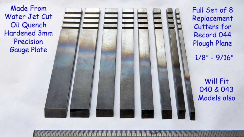

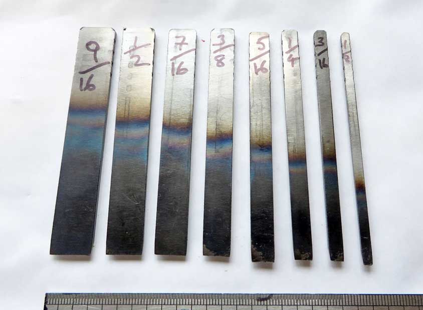

                                                      It has been a long hard road to finally complete these sets of cutters
                                                      Many thanks to Andrew Johnston for doing a sterling horizontal milling job on the grooves and bevel.
                                                      The real problem was in finding a water jet cutter to take on the job; tried several companies and they all either did not want the job or said it could not be done as the small parts would get lost in the tank.
                                                      Other companies wanted to charge between £250 and £1000 plus VAT to do them!
                                                      Finally found a guy who said he would fit them in between other work as time was not an issue and he wanted a bit of cash. 5 MONTHS later I called to be told he was going out of business and I was lucky to get my material back!
                                                      I was playing on the computer at MIDNIGHT on Friday and came across a company near Portsmouth, used their online enquiry form to outline the project and got a reply 8 minutes later saying "no problem I'll do them while you wait"
                                                      Went over there on Monday with full Covid observance and the guy did them for me at a VERY reasonable price; the set up took a a bit of messing about to avoid damaging the bevel end but got round that by reversing the work. He did a complete cut whereas all the other outfits said it had to be done with tabs, meaning more work for me.
                                                      Turned out like this after hardening:
                                                      I will post a video of then being cut later.
                                                      The guy is happy to do more and will charge a bit less for next batch as he now has the file on his system; also happy to help with some other projects that I have in mind.
                                                      Cheers, Martin
