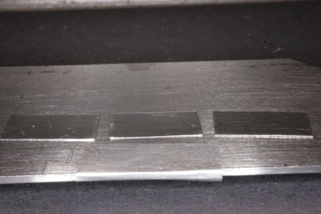

      Yes, 0.1mm mild steel is exceedingly thin and is very easily bent between fingers. For my purposes right now I have been needing to cut 10mm x 5mm little rectangles of it. And the resulting steels need to lie "absolutely" flat (i.e. flat to within 1 thou – call it 0.02mm).
      Hi, John, well these three pieces are approximately 10mm x 5mm, didn't get too fussy with the size, but I'm still not claiming they are absolutely flat and you might be able to make out the 0.015mm thick piece of kitchen foil in front front of them. Best I can do I'm afraid.
      They are sitting on the back of my 6" Moore & Wright straight edge.
      Regards Nick.

              Oh dear! John, I was not for one minute suggesting that you use kitchen foil, it was the only thing I have in the house that has a thickness that is within your 0.02mm gap tolerance and I used it in the photo for comparison to give you the sense of size of any gap you may see between those three pieces of steel and the straight edge they are on, the three pieces are not on the kitchen foil.
              Regards Nick.
              P.S. if you click on the photo to see it in full size, you should be able to see the kitchen foil is in fact in front.

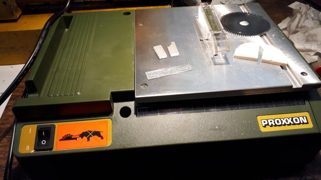

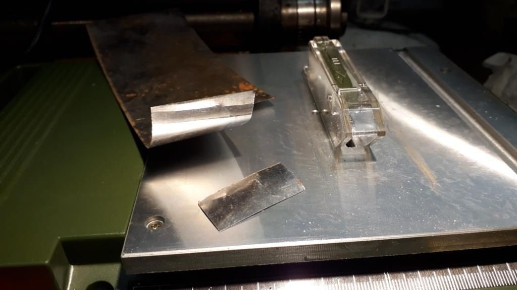

                      I thought that the KS 230 might be useful for one of my next projects and as, with various offers I could get one for the price of a tank of diesel, I decided I would see what one could do.
                      The supplied wood blade happily cut a couple of plywood offcuts as expected. I then fitted my well used 28020 blade and cut an offcut of 3mm aluminium. This loaded the motor a bit, but I don't know how worn the blade is. There is a warning label about feeding too fast.
                      Next up was a piece of 0.5mm galvanised steel, no problem, and finally some 0.1mm stainless steel shimstock. This was already not flat but the saw didn't seem to produce any further distortion. There is a small burr, but as I said I don't know the condition of the blade.
                      I have ordered some new 28020 blades (this supplier did not stock them) and will wait for them before any further trials.

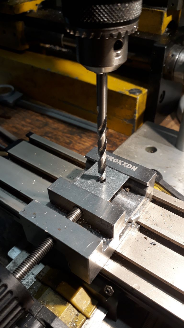

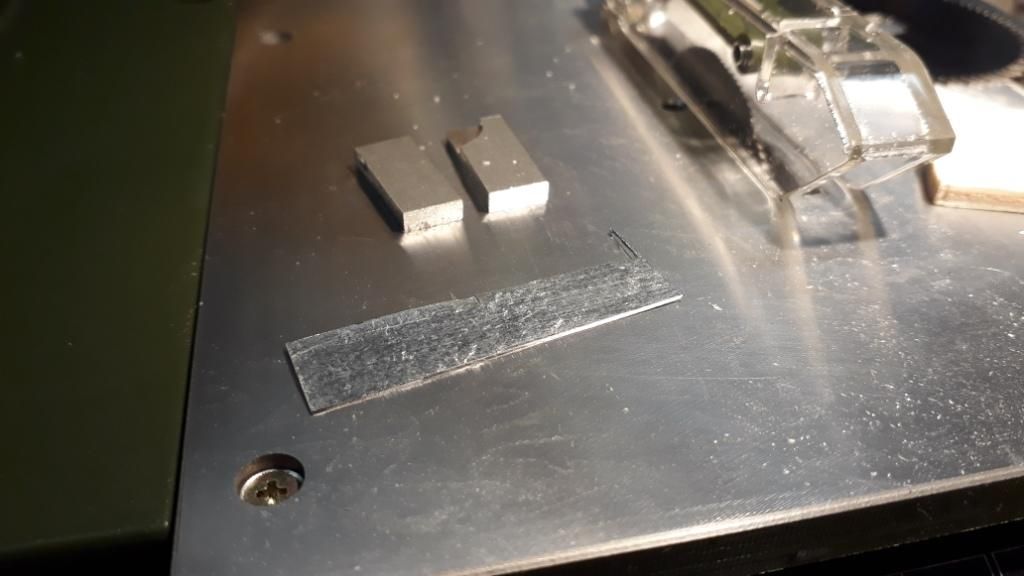

                              I got the new blades and tried them to make a couple of pieces I needed. One was a 25mm square from 0.5mm steel as a shim to go under the toolpost on my FD150 and the other was an 8mm wide strip of 0.3mm phosphor bronze for part of the injection pump on my twin cylinder engine.
                              Both cut easily and were true to better than 0.1mm. There was a small burr but both remained flat. The videos are here:
