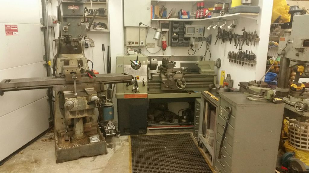

                                          Thanks for all the replies. One thing has stuck, which is to hopefully get one with the R8 Spindle. The wall I will be putting up will be 4metres long (the width of my garage). With a door at one side wide enough to get my motorcycle in for servicing etc. So I should have an effective free space of just shy of 3 metres. So I guess size is not a factor.
                                          The war against old British to Chinese does not really come into the equation, as I can see some of the ARC ones look pretty good. I guess most of the old British & German etc will be very heavy, which is why I discounted them. But it does look like they made smaller ones.

                                            That Beaver you mentioned, is it really too big? These things come to bits and are much more manageable. We took the Tom senior right to bits, and there was no part that two people could not manage. Moving it from a friends place could be done a bit at a time.

                                              Posted by old mart on 24/02/2020 19:16:00:
                                              Ah I see what your doing there. I built it one piece at a time. No but honestly to me it looks huge. Way past what I was thinking. When I was contracting the workshop where I did a lot of jobs had one. The fitters were always making some part or other on it. But that was a massive workshop. Just looking someone quoted 970kg. Another said 1500kg. I think my back has just gone out in sympathy.

                                                  If you have the room grab that Beaver, you only move them once and it will do everything you want with ease, call it ‘Future Proofing’
                                                  Surprising how quickly you run out of room if doing bike bits etc, and having to take light cuts is seriously tedious.
                                                  Another thing to consider is 40 int tooling is cheap and readily available.
