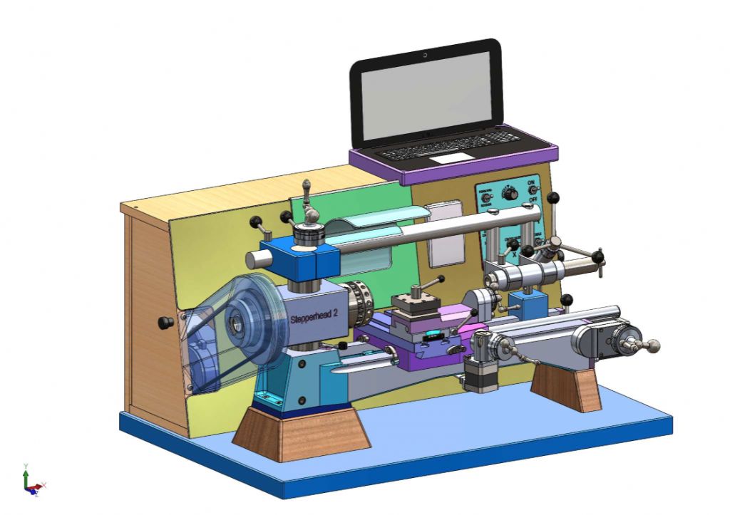

        #642963
        Alan Jackson
          @alanjackson47790
          In MEW300 I proposed a small adaptable lathe that could be easily changed in stages from a simple basic lathe through to a version with powered axes then finally onto a fully CNC lathe that could also be used manually or a mix of manual/ CNC as desired. The version show has a cast iron bed but this could be simplified with rectangular steel bars. I attach a screenshot. There are many more screenshots in my album.
          Alan
