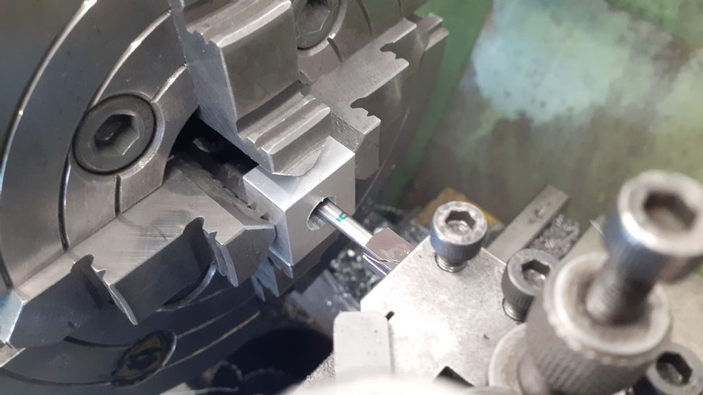

      Hi – a quick question.
      I need to cut a 10x1mm pitch internal thread so would like a 60* tool that will fit up an 8.5mm (-ish) hole.
      I've noted the little sets of pre-ground round-shank HSS for square holders, that come in sizes down to 6 or even 4mm.
      Does anyone have these & know what size holes they 'start' from?

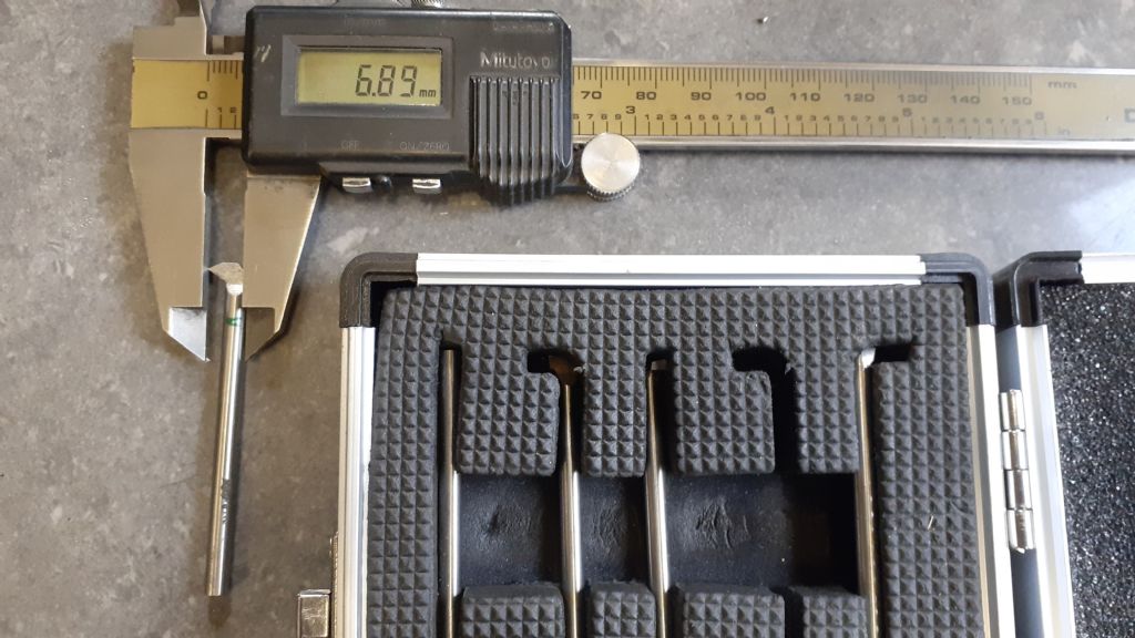

          The baby ones I have need a start hole approximately twice the bar diameter. So you are down in the 4 or possibly 5 mm range. A carefully ground from solid special can have a shank of mostly near 6mm diameter. Much stiffer.
          Its a long time since I used them. For me mine turned out to be a bit of a white elephant as I've not got on very well with them. Primarily, I think, because they are made with a fixed length round shank each end of the central square section provided to hold them by. Shanks are way too long and too flexi. Should I ever need to use them again the square bit will get turned down pronto and a clamp down holder made so the projection can be set to something more reasonable.
          For your job I'd just buy a tap as being far easier.
          With 20/20 hindsight getting general purpose tooling for a special job with the intention of using it for other suitable jobs that may arise has, over the years, often proved a fiscal mistake. I have a number of such things which struggled to to the job I got them for and have not, so far, found any other application.

            #614852
              My set of 4mm ones are about 7mm front to back and mine will enter a 8.5mm hole without rubbing. Looks like I may just have ground a little off the underside to get clearance when on ctr height but the top cutting edge/angle is untouched
              Edited By JasonB on 25/09/2022 10:22:36

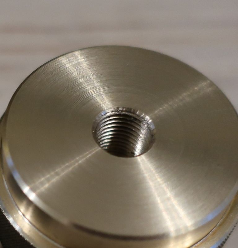

                                        @diogenesii
                                        JasonB yes
                                        Found a 7×1 tap (unused since 198?) in a box, clamped it in a toolholder, eyeballed a likely-looking approach for the cutting-edge to the (brass) work, ran it in by hand to test – think it went in 5 passes in the end..
                                        Thanks all for your help & suggestions
