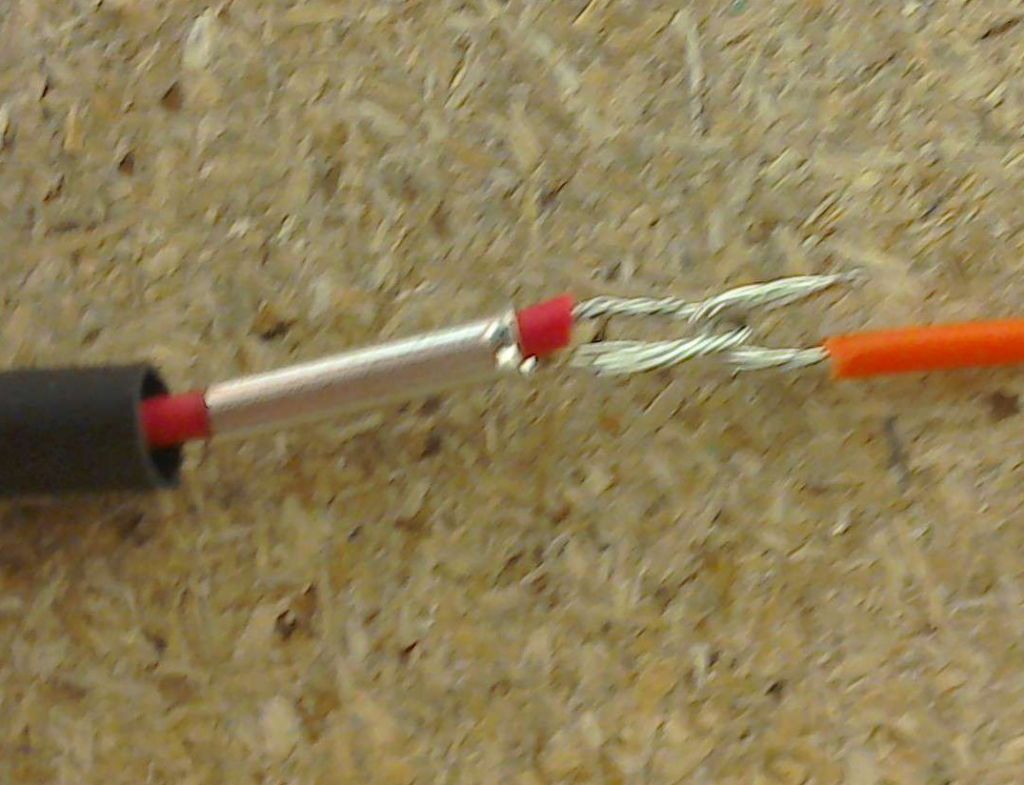

                                Crimping is the way to go. Use a bootlace ferrule and cover the join with heat-shrink sleeving, not the quickest method but reliable:
                                Used this to extend cables for the 3D printer.

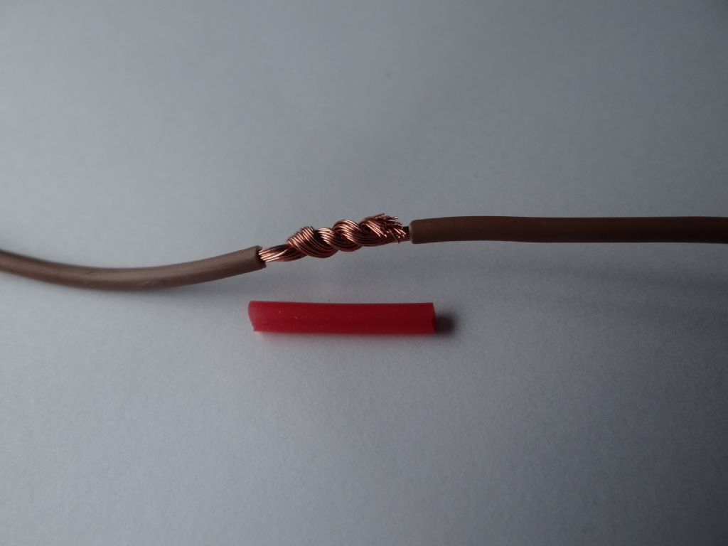

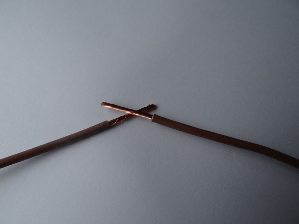

                                        I call this a Post Office Splice and I think it may be what Clive calls a Staggered Joint in his post.
                                        First strip and lay the two wires crossed end to end.
                                        Then twist the two wires together, ideally finishing with a couple of tight turns at each end. (My example isn't the best!)
                                        Finish by soldering and insulating with heat shrink tube or tape. As you see in the photo I made the classic 'Electricians Mistake'. This is forgetting to fit a tube, grommet or shroud on the wire before making the connection such that you have to take it all apart again.

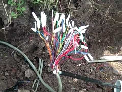

                                              In the last place I worked they bought a CNC spark erode with 4 axis control in an auction and some nice person had disconnected it with a hacksaw instead of unplugging and unscrewing the cables between the control cabinet and the machine body. I was given the job to re-connect all the wiring and after a few days got it working. After a few trials I found that using bootlace ferules that had the plastic end removed by holding it on to a grinding wheel on the end for a few seconds you can slide the remainder off and just crimp the cables not forgetting to have a piece of shrink tube over first. I used various sizes as the cables were not all the same and some were control and some were power for the drives etc. I then wrapped the joint cables in each bundle with spiral wrap and a tape to join the original mesh cover.
                                              David

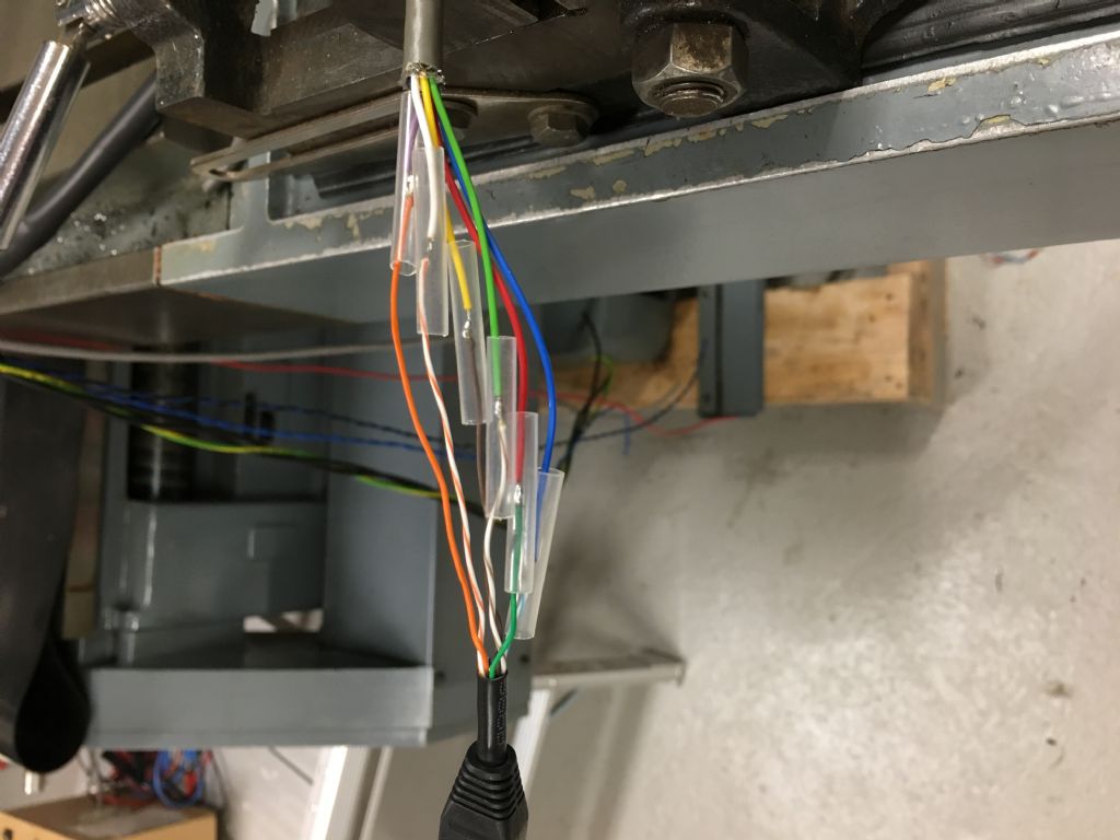

                                                Simple-ish way to splice together multi core cables, using small heatshrink (for individual wires) and larger heatshrink (to finish the externals). If you use adhesive lined heatshrink for the outer cover, it seals the joint against ingress of dirt and fluid. Obviously you will be well grieved if you solder all those wires and then realise you forgot the outer…..
                                                Forgot / can't be arsed to fight Windows and rotate the pics. This was for the servo encoders on my CNC machine, to interface with the new controller.
                                                Murray
