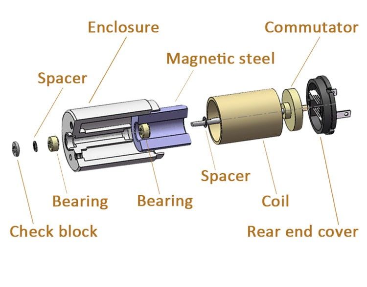

                          Just to illustrate the reason for magnetic detent ..
                          The conventional RC brushless with magnetic core:
                          And the Corelss style – The 'coil' being the rotating part, with no magnetic material. Note that this image is for a DC coreless motor, but the principle remains.
