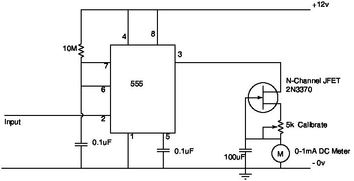

      For completeness, this is the NE555 circuit I was thinking of. It's from Don Lancaster's TTL Cookbook.

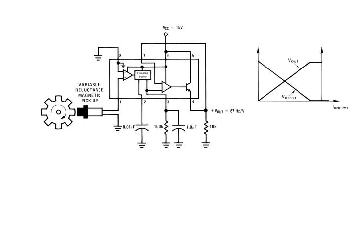

      Actually I prefer Les Jones' suggestion which uses a purpose made chip and is simpler. This is the LM2917 circuit recommended by Texas Instruments in their Application Notes.

        Why not use a signal from the low tension side of the coil feeding either 555 or LM2917. It might be very spiky, some-one will know
        The FET in SOD's 555 circuit looks a bit superfluous, a 555 will output 200mA, enough to blow the cover off a little meter.

            One of the many things I like about LM2917 solution suggested by Les. The chip cleans up the signal with a built in comparator so you don't have to. Excellent!
              Edited By duncan webster on 10/08/2018 11:05:58
              I thought so too and a little digging reveals it's not strictly necessary. What the FET does is allow the meter to be calibrated so that max rpm registers at full-scale thus getting best use out of the meter's scale. A useful touch if you don't mind adding the extra components.
