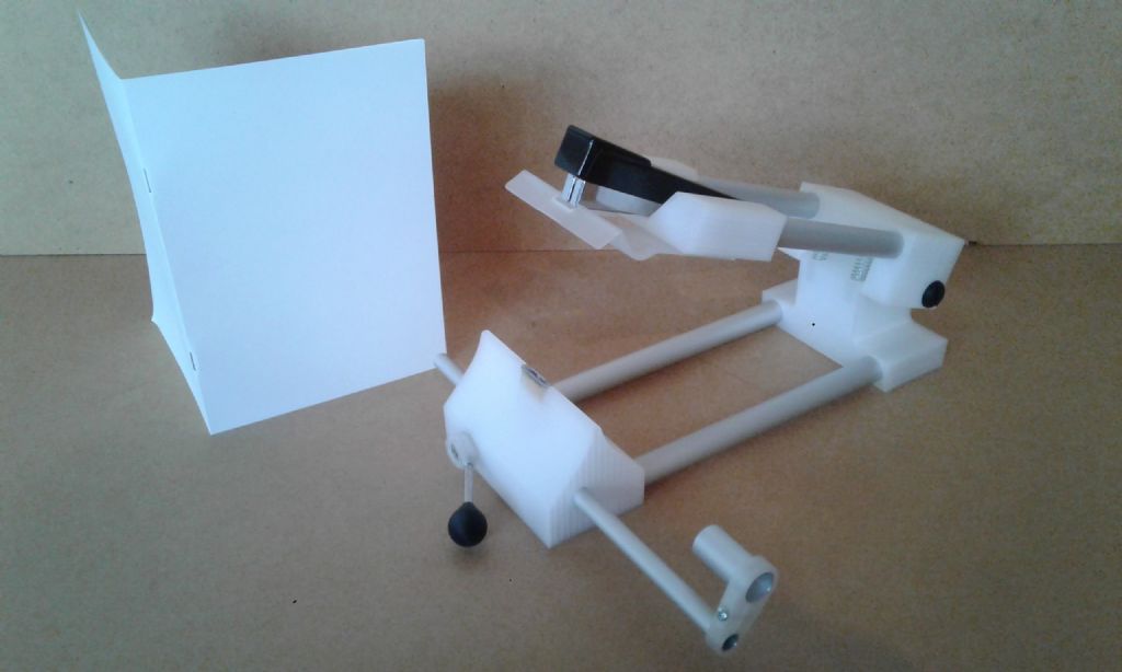

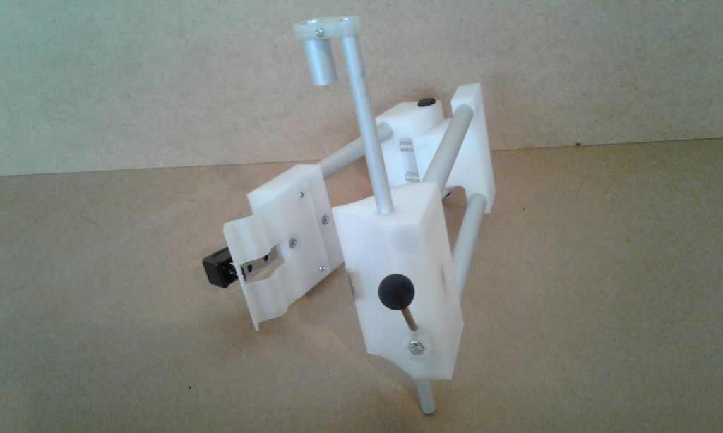

      Soee
        @soee
        Based on a simular one seen in my fathers printing workshop (made of cast iron) have I intented to make one for my daughter. She like to make and drawing in small booklets. It is made from part from an on the shelf stampler, aluminium tubes, some 3D printed parts and a stick of wood.
        It is cabable of stapl booklets made of paper sheets up to the size of A3
        The outcome ended up looking as seen below:
        #633998
        Martin Connelly
          @martinconnelly55370
          Looks good, no need to redesign something that works when you can just use different materials and modern manufacturing methods.
          I have never had enough need for something like this so I use the felt method. Place the sheets down on a thick enough layer of strong felt, open the stapler out and use it to put the staples through the fold and into the felt. This does not fold the ends over so you just do that part by hand with a steel rule. Some carpet types also work instead of felt. Not good enough for professional results but fine for the odd personal job.
          Martin C

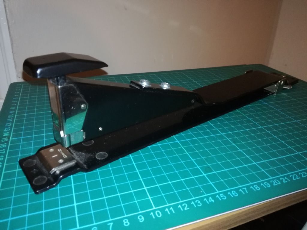

                Nicholas Farr
                  @nicholasfarr14254
                  Hi, like Peter Greene, I bought a long reach one some twenty years or so ago, where from? well Staples of course.
                  They still sell them, albeit a different model, but mine does the same amount of pages. Log Arm Stapler
                  I can see the advantage of the one above with the "V" guides, as like Clive says, it can be tricky to get the staples in the correct place, but mine does have an adjustable back-stop to help.

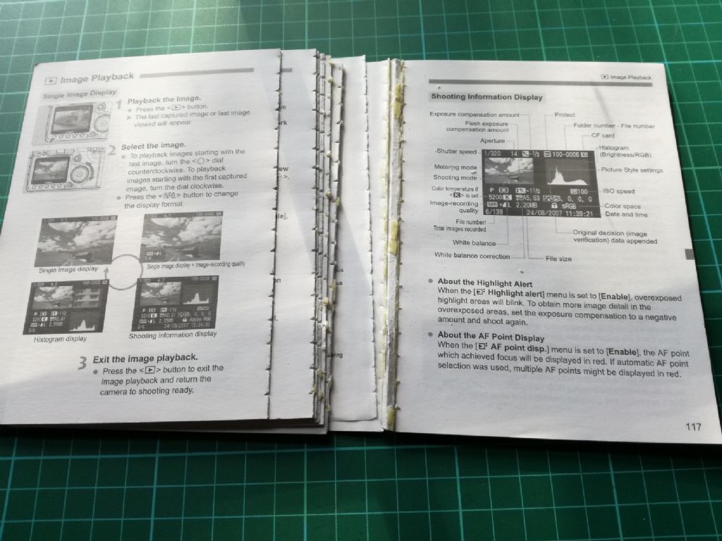

                            #634164
                            Nealeb
                              @nealeb
                              I was donated a long-arm stapler from an office clearout years ago and it is really useful for the odd instruction manual and things like that, to save paper. Elegance of binding not an issue! However, its simple guide is not very effective – tends to slip and does nothing to keep the paper square.
                              This thread had been useful in prompting me to think about a 3D-printed guide to both clamp to the "long arm" more securely and to act to keep the paper square. Thanks!
                              #634180
                              Nicholas Farr
                                @nicholasfarr14254
                                Posted by Clive Foster on 19/02/2023 09:24:28:
                                ….l. Simple glued spines, like paperbacks, don't have that issue. But they don't last well.
                                Clive
                                Hi, hence two at least of my camera instruction manuals look like the one in the photo below.
                                Regards Nick.
