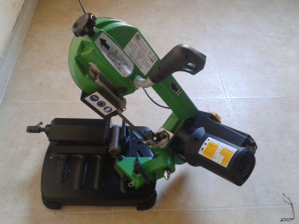

          I got this band saw from Nebes and had it for 4 years now, one of the best investments for my shop. The wheels are cast iron with no rubber so you can lubricate freely extending the blade life. It also has variable speed and is extremely silent. I wouldn't be without it. I have also seen conversions to make it a vertical band saw with a table which I plan to make. The Femi is similar to the Nebes I believe, but not sure if it can take lubrication.

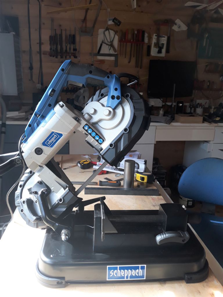

            Just got myself the Scheppach MBS1100 bandsaw, curently available from Screwfix and also Tool station for the same price. My first impression, after two test cuts is very positive. Very sturdy, well made.

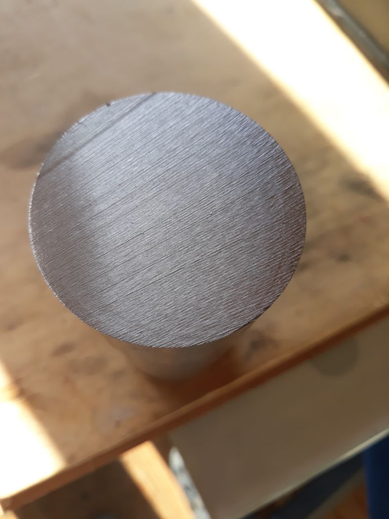

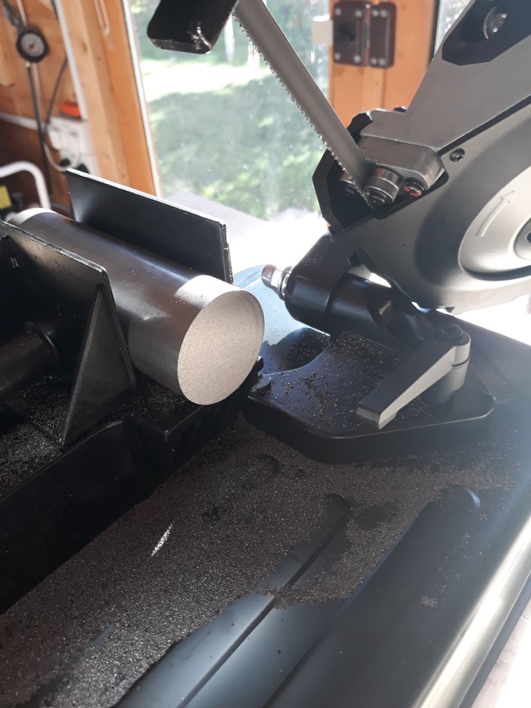

            I did cut a 51mm mild steel bar in 50 seconds, a 25mm square bar (obviously a slightly harder steel quality) in less than 30 seconds.
            The surface looks good, of course we will see how long the sawblade lasts.
            The only negative point I have is a slight angle failure of probably 1 or 2 degrees, which comes from the clamp allowing angles up to 45 degrees. The zero marker is somewhat useless, so what I do is I will cut a few parts just to set up the correct zero degrees and then mark them on the machine with a scribe.

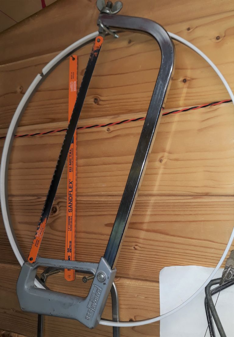

            And finally: This one will get used only sporadic or for some really small jobs in the future…

              This is the same machine as my Aldi one bought a couple of years ago and I agree totally
