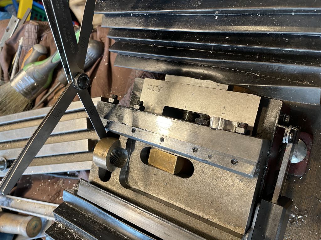

      I have been chasing some annoying backlash on the x axis (in particular). There is an annoying snatch at times and there is about one turn of the wheel to take up the backlash.
      I took off the table and looked at the D shaped brass(?) nuts. The Y axis nut is well jammed into the apron(?) but the X axis nut has about 0.6mm slop in it. (See attachment).
      I was proposing to use a brass shim to eliminate / reduce the slop. Any reason why not? I can't see how that nut can have become loose as there are no signs of damage on it. The previous owner was presumably making do with how it came from the factory.minimill table screws.jpeg

          The nut should be firm.

            There's got to be more to your problem than 0.6mm end float in the nut to account for a whole turn of the wheel to take up the backlash. I would be looking at least a combination of worn leadscrew/nut combo and/or leadscrew axial location. I'm unfamiliar with your particular mill, but that much backlash should have a glaringly obvious solution, somewhere, if only one knows where to look.

                    "There's got to be more to your problem than 0.6mm end float in the nut to account for a whole turn of the wheel to take up the backlash."
                    One mm is 1.5 turns iirc so that 0.6mm talks directly to the drive.
                    This afternoon, I took a 1.5mm copper strip and beat it out to around '.6mm and cut out a D shaped washer / shim. With a bit of persuasion, I got it down in the slot with the nut and it's pretty rigidly home. That seems to have taken care of the backlash for the moment. Time will tell if the copper will creep; it was work hardened after the final annealing and bashing sequence and there is no deliberate movement in there (not any more there isn't). As no one has suggested a possible problem I will leave it in there and see how it goes.

                      As I said in my reply, I'm not familiar with your mill, but now we know that the leadscrew has such a fine pitch, that would correspond to the perceived backlash. I was erroneously assuming the the screw was of the order of 2 or 3mm thread pitch.
                      I can only apologise for the divergence my comments on the forum software have brought. I hope you get some positive input to help you solve the problem, but in the meantime, your shimming seems to have provided a solution, albeit a temporary one.
