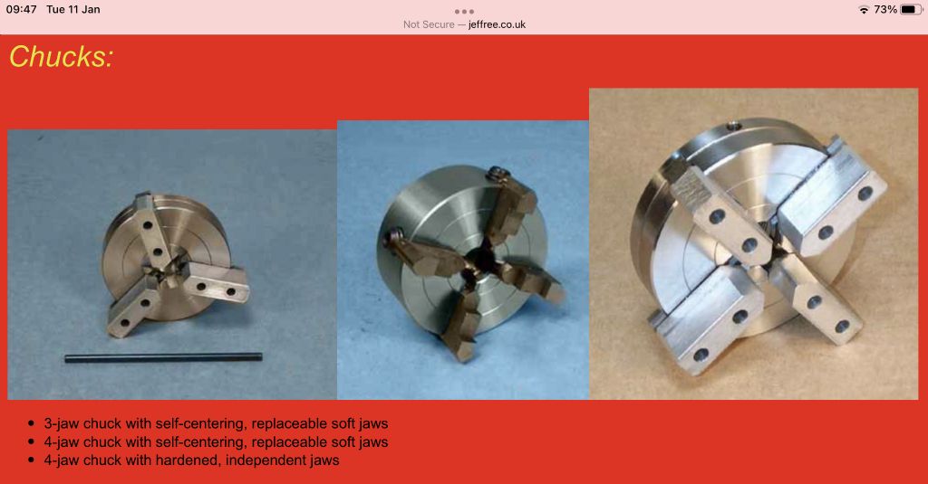

            Posted by Dr. MC Black on 10/01/2022 08:54:35:
            It's a Taig Lathe (marketed as Peatol in the United Kingdom)
            I was trying to cut a step in Soft Jaws so that I could mount a steel disk that was too large for the jaws of the 3 jaw chuck as supplied.
            I referenced this image on p1 … but [with due credit to Jeffree/Peatol/Taig] thought it worth posting here:
            In attempting to machine the soft jaws … Surely MC is trying to use the machine as the manufacturer intends

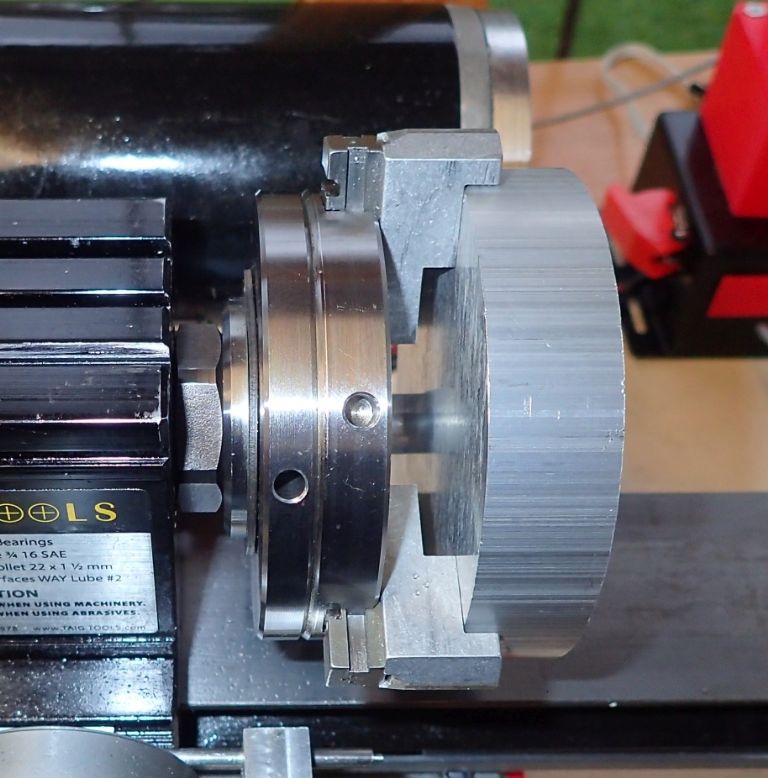

                                        I have stepped the soft jaws on my three jaw very successfully
                                        aluminium billet in modified 3 jaw.jpg That is a 90mm lump of aluminium, but I have swapped the induction motor for a DC one, and machined the jaws the other way round ( as inside jaws clamped on a steel rod) with a final light skim when reversed.

                                          With a scroll chuck, there has to be the risk that the impacts from an intermittent chuck will tend to loosen the jaws.
                                          An argument for taking shallow cuts, particularly with a low powered machine.

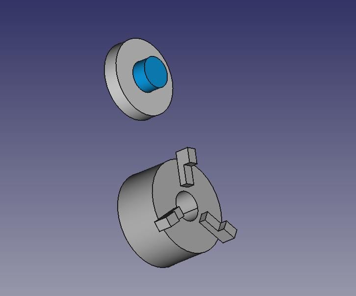

                                                I was trying to cut a step in the Soft Jaws of my Taig lathe so I could cut a chamfer on the outside edge of a approximately 40mm disc.
                                                It already had a co-axial hole through the centre.
                                                I closed the soft jaws around a M8 Penny Washer and (eventually) used a Boring Bar to cut the step from the inside.
                                                The vibration due to the intermittent cut (I surmise) loosened the jaws.
                                                I was only able to cut a step around 3mm deep but I would like it to be about a third of the height of the jaws.

                                                  If the step was only for a 40mm dia disc then don't worry about the speed 400rpm will be no problem.
                                                  Thin penny washer was not teh best thing to use, something a bit thicker would be best.
                                                  There is no real need to wast that much jaw depth for one job, 1 to 1.5mm depth would have been more than adequate as a "disc" assumes your steel is reasonably thin so little overhang. Just take light cuts off the steel
                                                  As for pictures you have already got one in an album so add some more and then when you get to where you want the picture in teh post click the little camera icon along the top of the box you are typing in, select album and then image and click insert
