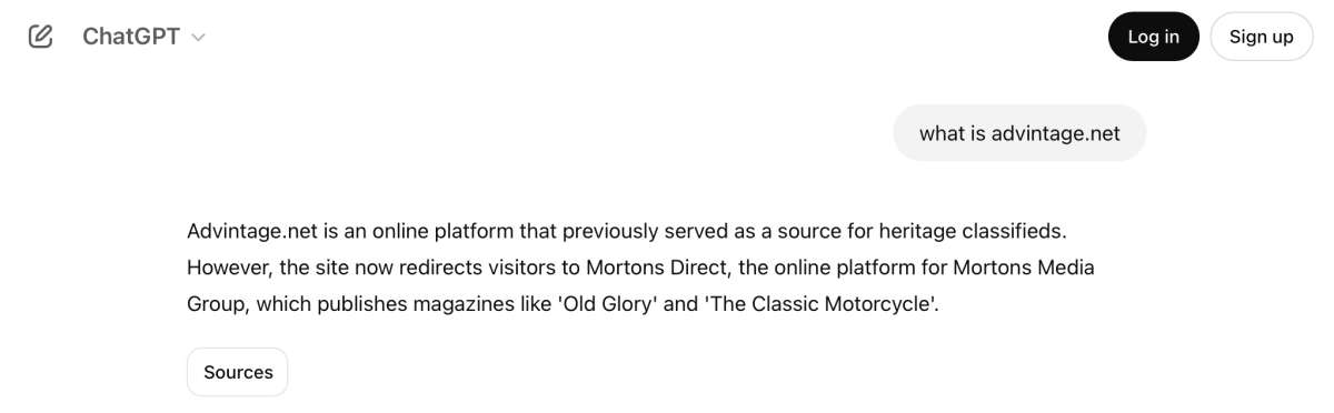

                        ChatGPT wasn’t much help … but at least it wasn’t wrong
                        This much I knew already:
                        IMG_0651

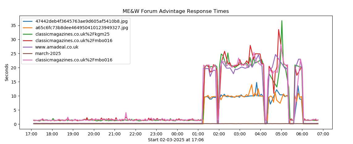

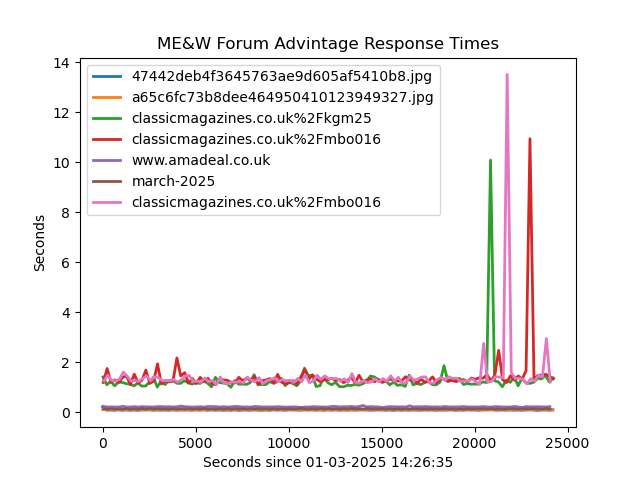

                                  Bedtime report, I wrote a program that calls a group of 7 advintage adverts every two minutes, with a 12 second delay between each.   Throttled well back so as not to flatten advintage.net with hard work.
                                  Graph is revealing:
                                  Figure_1
                                  Advintage does a good job with 4 of the seven; they consistently reply within 0.2s.   Much less satisfactory are the 3 calls to classicmagazines.  At best these are always sluggish (1.5s or worse, poor) and inconsistent.
                                  At the right of the graph (between 9pm and 10pm) the classicmagazines group go really pear-shaped, taking up to 14 seconds, again inconsistently.  14 seconds is very poor.
                                  The 3 misbehaving classicmagazine links all call php scripts.  Not straightforward, whereas the fast responders are all simple images.   I think the php scripts roll a selection of adverts, which is more complicated.
                                  Broken code or a corrupt list of adverts maybe.

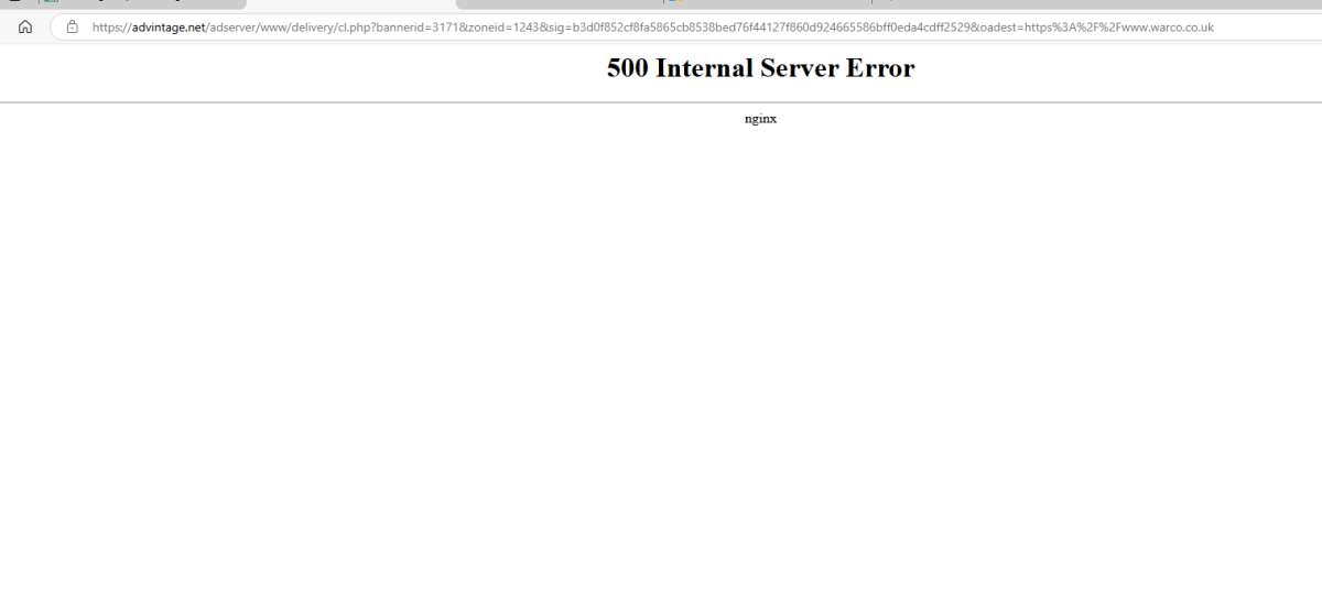

                                                  Very slow again – as time-stamped.
                                                  Edit: as I went to browse Warco instead, managed to grab this screenshot on the way over .. ..FWIW..
                                                  Screenshot 2025-03-03 030312
                                                  #786980
                                                  Diogenes
                                                    @diogenes
                                                    ..and now Warco’s banner has disappeared.. ..should be at the very top, no..?

                                                      Busy with the family yesterday but I ported my monitor program to a raspberrypi and set it running.  Engineering reason: raspberryPi’s use much less electricity than a PC or laptop and can be left running headless (no screen or keyboard) in a corner, continuously.
                                                      Every two minutes it measures how long ‘the forum’ takes to respond to 7 different adverts, plus a delay of 12 seconds between each individual call, so the advert times are taken once every 204 seconds.   Simulates a fast-ish human typist tirelessly browsing the forum with a stopwatch and it takes no comfort breaks.  And is super-human in that it records the time taken by internal calls, not just the whole page.    Engineering reason for measuring internal calls is that it helps pin down what’s amiss rather than simply noticing “the forum is slow”.
                                                      As I type this the forum appears to be in good order, responding quickly, though AdBlocker is ON.   My individual observation doesn’t mean much because whatever is slowing the forum down is intermittent.    It was OK for me Sunday morning, and again when I logged in briefly before bedtime.   All fixed then?
                                                      This morning’s graph suggests not!
                                                      Screenshot from 2025-03-03 07-16-58
                                                      • No problem between 1700 and 0100
                                                      • Just after 0100, there are 4 separate major slow-downs, with brief gaps, making the forum unusable for 5 hours
                                                      • A few minutes after 0600 today, just before I logged in, the forum started responding normally.   Long may it last.
                                                      The first run of this program strongly suggested the classicmagazine php adverts were causal.  The latest graph shows all  advintage adverts are affected.   The Amadeal advert normally vends in less than 0.2s, last night it was taking 10s, an x50 hit.  The already slow classic mags group normally taking about 2s average 10x delay, and one of them takes over 36 seconds to arrive.
                                                      Last night’s performance figures are dreadful.   Cause unknown to me.   Possibly overnight maintenance, not necessarily human.
