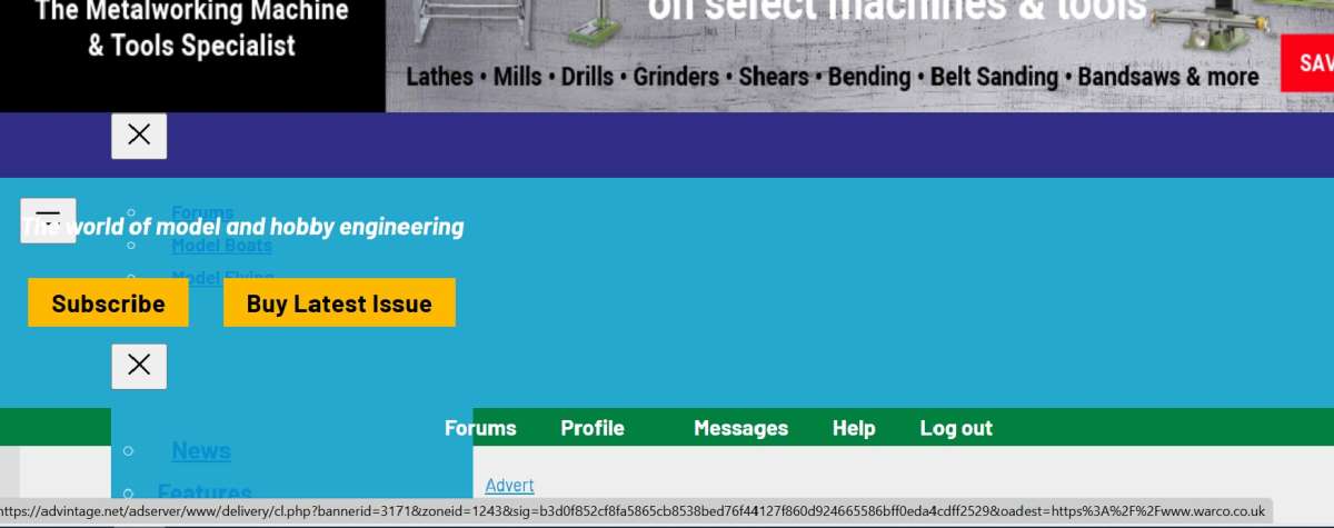

                          jim1956
                            @jim1956
                            This is a quick screen capture of where my MS Edge window paused for a long time when trying to load the page.  Might be related to the advert service, note the URL at the bottom of the screen.  Regards Jim
                            screen capture
                            #786253
                              On jim1956 Said:
                              … Might be related to the advert service, note the URL at the bottom of the screen.  Regards Jim
                              Normally, in moderator mode, I access the forum with my AdBlocker ON.   (In normal user mode I switch AdBlocking OFF, because Ads are useful, but often forget!)
                              AdBlockers tell the browser to ignore links to adverts.  Ads are typically served by a third party, who may retrieve them from elsewhere.  In Jim’s example, it appears the forum sends a link to advintage, who then connect to Warco.   So if advintage, warco or the network are wonky, there will be delays.    Maybe the forum is OK for me because my browser doesn’t follow links to adverts.
                              I would describe the forum as advert heavy.  A common mistake in my opinion, due to advertising managers naively assuming more is better.  Not so, too much advertising leads to most of it being ignored, and anyone with a slow computer and/or network is annoyed by delays caused by the additional payload.   Counter-productive, and liable to result in users blocking ads entirely.
                              I also run “Privacy Badger”.   It zaps 5 calls the forum asks our browsers to make to tracker sites.   Though I block trackets because they breach my security policy, not calling them also improves performance.
                              Anyway, to test Jim’s hypothesis I’ve switched ad-blocker off.   Result: I confirm ads are slowing the forum down, but by less than a second or so, not awful.  Ads don’t make the forum unacceptably sluggish here in so far as I’ve been able to test it.   Unfortunately I won’t have time today to test it properly.
                              Are those suffering delays AdBlocking or not?  Might help pin down the problem.

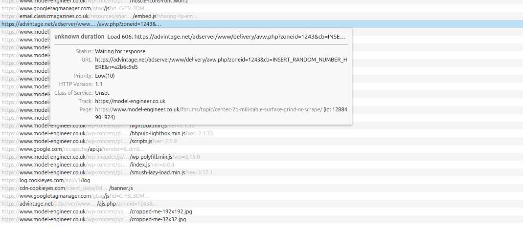

                                                  This morning, with AdBlocker switched OFF, I am experiencing slow loading.
                                                  Turning Firefox’s Web Developer tool ON shows instantly that it headlines “Waiting for advintage.net” repeatedly.  (i.e excessive delay waiting to download an advert.)
                                                  Using the developer tool to dig deeper into how long each element of a page takes finds examples like this,  note “unknown duration” and status “waiting for response“, all advintage.net, everything else reasonably quick:
                                                  advintage
                                                  After turning AdBlocker back ON my performance returns to normal.   It’s because AdBlocker tells the browser to ignore links to adverts found inside a webpage, so my view of the forum isn’t delayed by advintage, and the forum flies.
                                                  The evidence against advintage.net is strong.  A problem with advintage.net, either server or network.
                                                  Of course, SOD’s Law being what it is, possible this is a double fault.  Something out-of-spec done by the forum that upsets advintage.net.   Although the calls look ok to me, the code is complicated!
