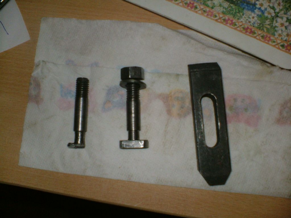

                                                    …Usually the milling slide is the weakest point, I had to beef up my ML7 one on my M series Drummond with a better chunkier cross slide t-bolt and I also use stops to prevent it from twisting under load
                                                    I must get around to doing this on my Myfraud vertical slide. That and a support under the dovetail area to sit on the table and hold the working bits in place. What sort of stops did you fit to stop it twisting under load? It definitely is the weak link in the set up when milling.
                                                    #256364
                                                    Ady1
                                                      @ady1
                                                      I just t-bolt in anything I can find from the milling clamp set, those slotted finger clamps work fine
                                                      The original weedy (and failed) ML7 t-nut is on the left, my replacement t-nut is in the middle and a small clamping set finger on the right
                                                      The extra support from the clamping set seems to be just enough to allow a decent milling job to be done without it twisting. (I couldn't believe it when I first saw my slide twist under load, grrr)
