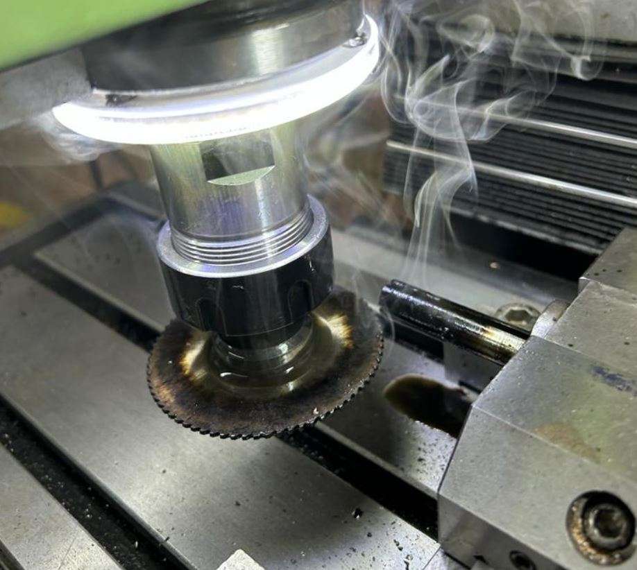

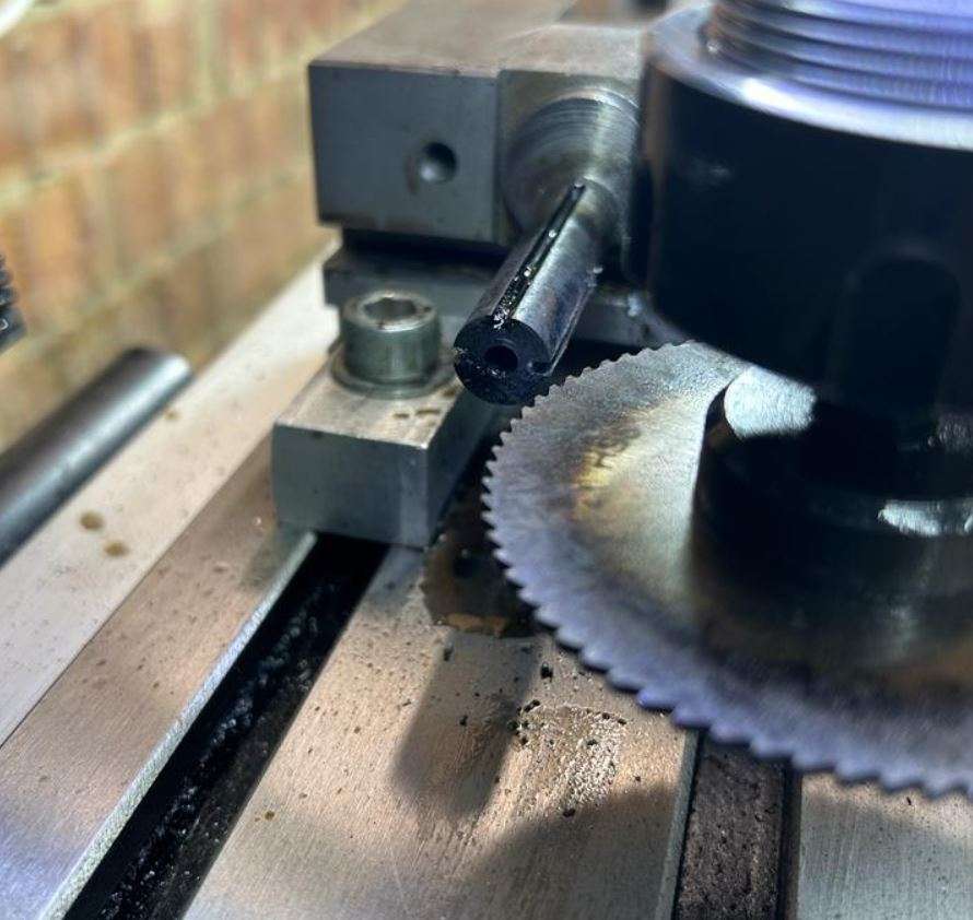

                      Well I did not have any 1mm wall steel tube so turned and bored some ERW tube which is about as nasty a steel to cut as you could want. 80mm x 0.7mm thick 32T saw which is the closest I have to your 28T x 1/32″ which turned out to be a particularly eccentric example at that.
                      Speed is about as slow as I could go without a stall and feed rate approx 3″/min again any faster and you start stalling. Would be more likely to stall if the blade were thicker on these type of machines which are not at their best at these slow revs.
                      First blind cuts in the end of a tube, I then moved round the saw round to the front to complete the second cut. If only doing one side then you will have to accept an angle to the bottom of the cut. Secondly a full length slot on a short length.
