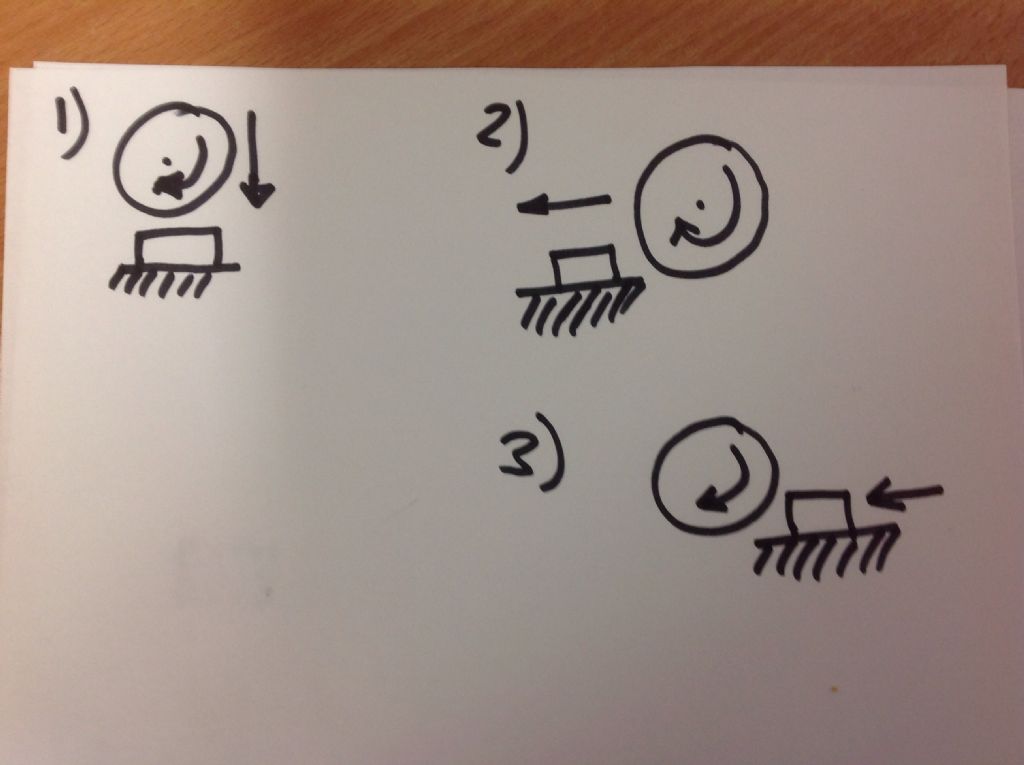

                                image.jpgSorry all, back to slitting. I hope to be able to find a bit of time at the weekend to open the slitting saws that Santa bought me and have a go at my 10V crankshaft. Just a bit of advise from the wise on how I should feed the saw into the workpiece. I have tried to sketch my understandings of the options in the PERKO-CAD sketch, which are:
                                1) plunge cut
                                2) up cut
                                3) down cut
                                #145448
                                  Bob,
                                  I would use (2)
                                  #145466
                                  ian cable
                                    @iancable23486
                                    without any doubt number 2 ,the other 2 are called climber milling which allows the cutter to grab the work piece and try and drag it in .like others have said slow speed personely I use between 60/100 rpm on small up to 2" then half that for large ones, also high speed will just burn out your 10 quid cutter ian c
                                    #145471
                                    JA
                                      @ja
                                      Briefly
                                      1. Perhaps, slow feed with great care. Best avoided.
                                      2. Yes. This is the normal way to use any cutter
                                      3. NO. This is climbing and will probably break the saw. Simply the saw, or cutter, will try to climb over the work and put excess loads on the tool and machine. In a few cases, such as some high alloy steels that work harden, climbing has to be used.
                                      Cutting details. Assuming the crank is mild steel I would use a maximum cutting speed about 80ft/min (400mm/s). For a 3" slitting saw this would be 100rpm. The feed should be slow, very slow. I do not take a deep cut when using a slitting saw, usually using less than 1mm depth. OK it takes time but I am not on piece work. Use cutting oil/coolant. If in doubt reduce reduce speeds and depth of cut. If the crank is cast iron lower the speeds and do not use cutting oil/coolant.
                                      JA
                                      #145474
                                      Roderick Jenkins
                                        @roderickjenkins93242
                                        In general I think 2 is best but I would feed in the other direction so that the backlash is taken up by the saw always pushing against the leadscrew. Of course, I'm not sure if the arrow in your diagram refers to the saw or the job but the principle is the same: always feed so that the pressure from the rotating cutter is pushing back against the job moving towards it.

                                        #145488
                                        Bob Perkins
                                          @bobperkins67044
                                          Thanks all for the feedback. As usual one question leads to at least one more. The Conrod is brass, and I have to cut through a thickness of 8mm. Will a slitting saw do this in one pass with a slow feed, or will it need several passes with a shallower cut?
                                          #145493
                                            Posted by Bob Perkins on 28/02/2014 13:35:38:
                                            Bob,
                                            It should be fine in one pass:
                                            Do bear in mind that the combined effect of the number of teeth and the diameter of the blade will determine the appropriate speed.
                                            I would suggest experimenting on a bit of scrap Brass first, to get a feel for what you're doing.
                                            #145494
                                            Clive Hartland
                                              @clivehartland94829
                                              Bob, I always initially do a small cut and then start again with another cut, the idea is that the initial cut will stop the slitting saw wandering. 8mm sounds a lot but on Brass not so, slow manual feed and do lubricate it with kero or WD40. The frequent lub. application will also flush out the swarf and keep it cool.
                                              Clive
                                              #145495
                                              Stuart Bridger
                                                @stuartbridger82290
                                                Bob,
                                                My 10V conrod was my first serious use of a slitting saw.
                                                I may have been over cautious, but I took it VERY gently. Multiple shallow cuts with slow feed worked fine for me.
                                                It did take time,but there were no tears.
