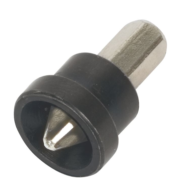

                              +1 for Philips heads on plasterboard screws.
                              These depth stop versions aid the cam-out as well to prevent overdriving.
                              Neil's explanation was probably right originally but the problem with almost all posidriv woodscrews these days is that they are through hardened like nobodies business. It's not really necessary for 99% of applications IMHO but it certainly buggers up your bits if the driver slips and it's not harder than the screws.
