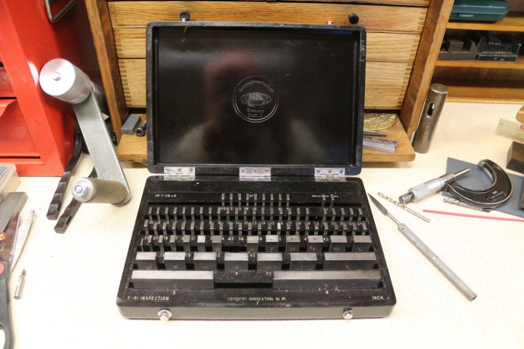

                  I got this old bakelite box of Coventry Matrix imperial slips on the auction site for peanuts. It was one of the best buys I ever made. Invaluable for all sorts of measuring/calibration but they really come into their own when used with my cheap Chinese dig height gauge for marking out / checking etc. I would not be without them!

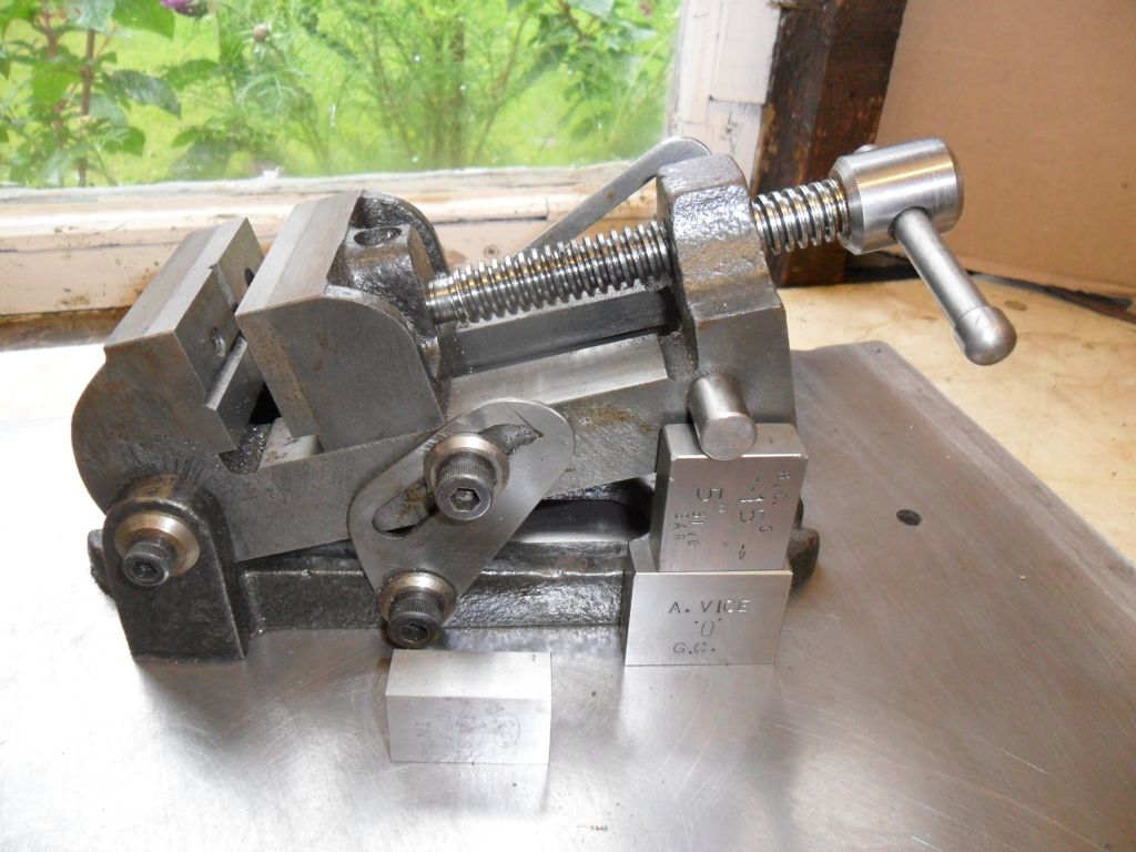

                          Hi Guys
                          AS  mentioned on anglesthis thread .  slips/ gauge blocks can be used with sine bar to set correct angles
                          Regards Nobby
