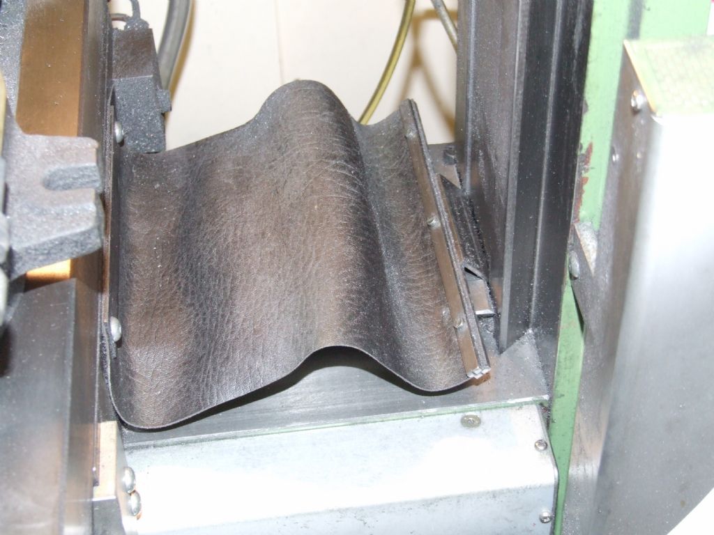

      I’ve got a warco vmc miller and the method of protecting the vertical column and the Y slideways is a length of rubber sheet. This does an ok job when the knee is in the low to middle area of the vertical slide but as the table is raised it all gathers up and restricts table movement. The problem gets worse when you want to move the table back as the rubber either gets squashed or has to hang over the table onto your job.
      Does anyone know where I could get a concertina guard wide enough or has anyone made something that would do a better job than the original?

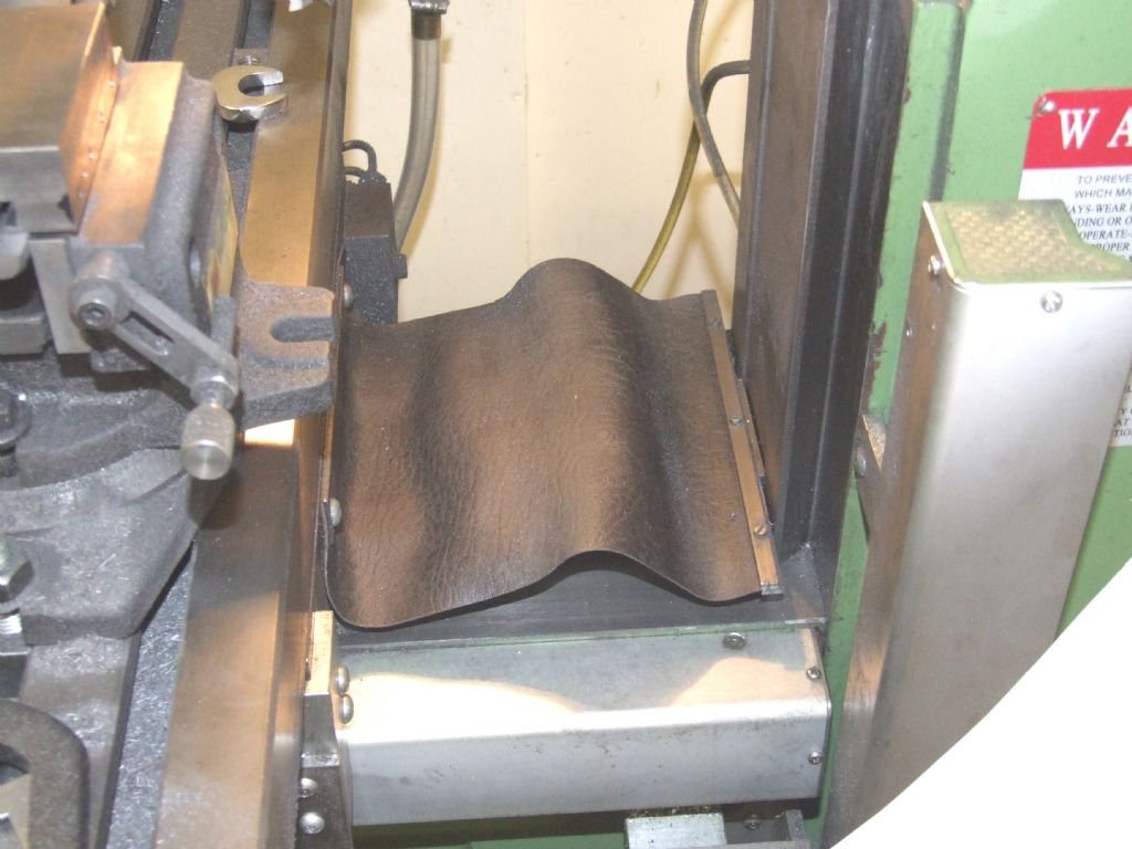

                  Hi Mike
                  Had exactly the same problem – managed to destroy my rubber cover within a few days from new.
                  I made a simple cover from leathercloth and a piece of angle iron which covers the Y-slide (but not the vertical). I felt that the real problem was stopping swarf from getting into the gearing which elevates the knee and this has provided the ideal solution so far (18 months).
                  The angle iron simply clips into the ‘slot’ formed between the knee casting and the ‘recess’ in the centre of the Z-axis slideway. Hope that the photos explain all.
                  The leathercloth is thinner and more flexible than the rubber and allows the slide to go back against the stops, maximising travel. An added bonus is that the Z-axis slide is uncovered and provides an ideal mounting surface for a magnetic clock stand.
