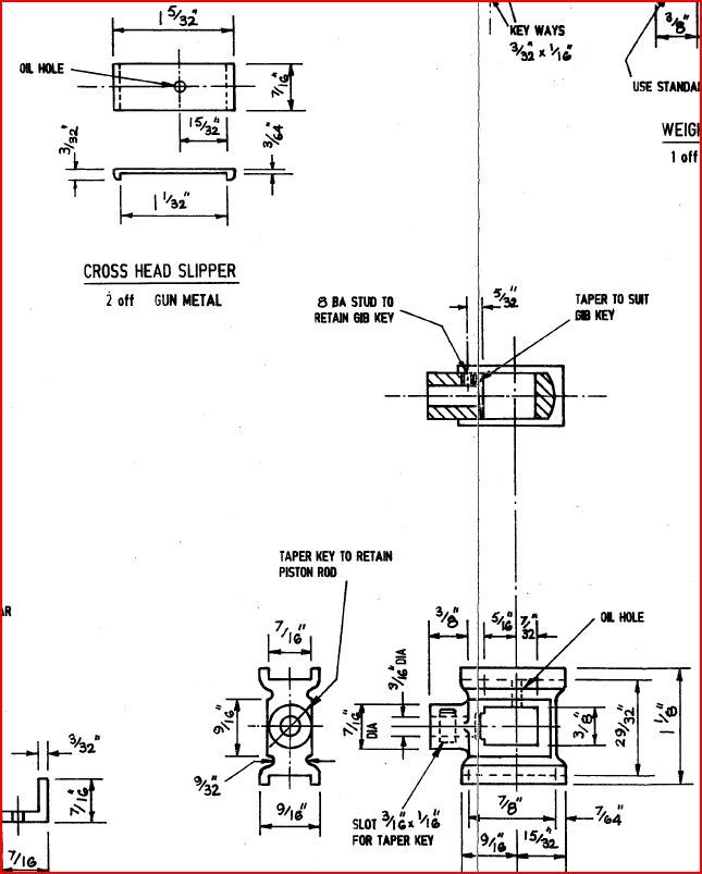

                                What about Jason's suggestion of fitting bronze 'slippers'?
                                #165216
                                  If you are going to have to machine the cross head then it will be quite easy to fit slippers. The easiest way would be to mill away a bit more thickness than needed, soft solder on some bronze and then machine that back to your required thickness.
                                  A bit more tricky is to make separate slippers which fit into teh gap between slide and crosshead and have a recess in the back so they don't slip out, if they wear then a bit of shim behind them will take up any play. You can just see the bronze slippers on my fowler in these shots
                                  Doing it with slippers will save having to worry about case hardening, the small area of steel crosshead that contacts the sides of the slide bars is not worth worrying about.
                                  Out of interest what type of oil were you using?

                                    #165253
                                      3/64" this should show them, click the image to make it bigger
                                      #165294
                                      Mark Tyldesley
                                        @marktyldesley75376
                                        Hi Jason
                                        many thanks for diagram, looks an easy item to make up, I shall give it ago, it mentions gunmetal but brass will be the option togo for, may make them alittle thicker to
                                        cheers

                                        #165296
                                          Brass is not the best bearing surface use bronze or GM. The easiest way to get it would be to buy suitably sized round stock and saw it lengthways down the middle then machine your rectangular section from that.

                                            #165312
                                            Mark Tyldesley
                                              @marktyldesley75376
                                              Jason
                                              whats the best way to mill out that recess, been thin how do you hold it down to milling table, read you can use double sided tape, be interested to know how you did it
                                              cheers
                                              mark
                                              #165315
                                                You can buy gunmetal in square bar but its hard to find, so cutting from round is often easier if the part is not too large. Bronze block is available but again easier to come by round.
                                                Machine the sliding face and then soft solder to something that you can hold in the vice, mill the recess, melt the solder and rub on some wet n dry to remove solder.
