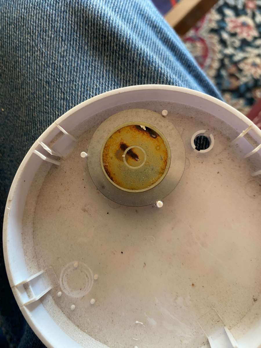

      This little disc is the siren out of an old smoke detector.
      How would I wire this up to an Arduino to get it to work and what sort of frequency range would I need to output to get an audible sound.
      Thanks
      Bob
      Siren

        I have an old alarm with the same style sounder. It runs on a 9v battery. There don’t seem to be enough electronic components in it to be producing a drive signal, so it may simply make a noise when supplied with 9v.

          It looks like a piezoelectric disc type.  If so it needs an AC drive at it’s resonant frequency to get decent volume.  You could drive it from two Arduino pins with antiphase square waves but would need to experiment to find the best frequency.  An alternative would be to use it in an oscillator circuit around an inverting logic gate in which case you’d need to experiment with capacitors to get it to work.  Look at the circuits used for ceramic clock oscillators.

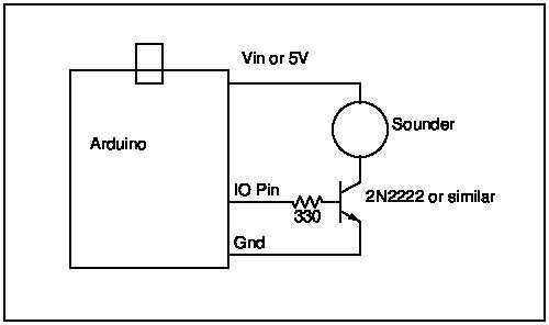

          #752528
            I suspect alarm sounders are resonant at a particular frequency for efficiency and output will be low unless the Arduino is tuned to it.   About 1500Hz would be my guess.  If I can find one in my junk box, I’ll experiment.
            The Arduino tone() function is the easiest way to generate the frequency : should work with any IO Pin
            As IO Pins are current limited, may be necessary to drive the sounder with a transistor connected to the 5V rail.  An external power supply would provide even more volts.
            sounderDriver

              There appear to be 3 contacts (certainly 3 on the PCB of the detector) – of course, one contact could be just for mounting.  In the photo, there is the centre “disc”, the ring outside of this, the “Middle ring” and the “outer ring”.
              Dave, any idea which rings to use and are they polarity sensitive ?
              Bob

                SOD’s circuit will work but not very well. The device is capacitive this circuit only charges the capcitance. There is no discharge path. Typically they are driven form a AC or differntial DC source.
                They also need to be mounted in a resonant or impedance matched cavity to match the disk and driven at the resonant frequency.
                The device pictured has a third connection this allows feedback to the drive circuit so it automatically operates at the resonant frequency.

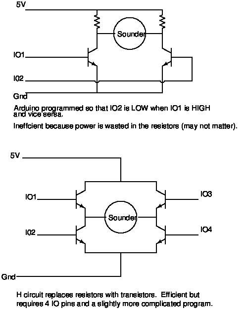

                              Following Robert’s guidance, I offer two improved driver circuits:
                              sounderDrivers
                              The second circuit, called an H-Bridge, is extremely common as a chip, like the L298N, normally used to control motors.  An experimenter not wishing to get into making electronics can buy them pre-assembled as a plug-in Arduino module.
