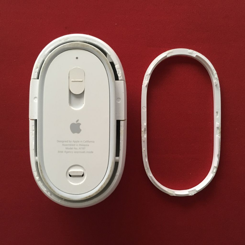

            On the off-chance that anyone is interested … here is a real-world example of the ‘perspective problem’ found when using non-telecentric lenses:
            Taken this morning, with my iPad … it shows an age-related glue failure:
            The relevant point being that the trim-ring is further away, by the height of the mouse, and therefore appears to be significantly smaller than the face to which it was previously attached.
            Taking measurements from such images can be deceptive !

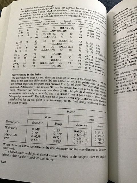

                          Thanks for all the replies, I think I have opened a can of worms , I have received my copy of Trubal cains book and this is helpful.img_1716.jpeg
                          but it still doesn’t answer the question of unknown thread forms pre 1900 , could be Thury or could be something developed by individual clock manufacturers, all the clocks I restore I like and try to keep them as original as I possibly can and as much as possible use the original fixings but sometimes I have to make copies of screws but they need to be to original specification ( if possible) , yes BA, metric, and Thury, are all very similar because they are all based on metric measurements and it’s possible to re tap but then the next person to dismantle the clock has one original screw and one non original but both look the same , what one goes in what hole but if both or more are identical then no problem, so it’s not just for my benefit.

                            Nothing does! Up until about 1850 workshops and craftsmen made their own threads, to whatever approximate diameter, form, flank angle, and pitch they thought best. Using standard threads caught on slowl, and British clock makers were ultra-conservative.
                            The only way I know is to measure them. With luck they will be found to match to a standard for which taps and dies are available. Otherwise they have to be bespoke. Not difficult in principle, but fiddly. Female threads can be imprinted on a soft wooden dowel by screwing it into the hole. The professionals use shadowgraphs and other gizmos to do this accurately. However, males can be measured at home with a caliper, v-angle gauges and a loupe. A USB microscope and pixel measuring software would speed the process considerably if more than a few need to be investigated.
                            Once the thread's properties are known, a tap can be made in the lathe. And from the tap, a die.
                            I guess (but don't know!!!) that pre-standard clock threads will be similar. For practical reasons, thread applications have a limited range of useful pitches and diameters. – for example, fasteners all have thread angles between 48° and 60°. Thus, a fairly small set of home-made taps and dies might cover most clock repair requirements.
