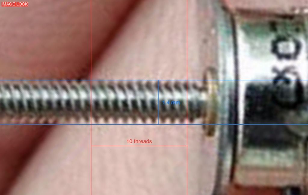

                                                    Just as an example of what can be achieved with modest optics and free software:
                                                    This is the lead-screw on a very small stepper motor
                                                    The image is sufficient to identify the two-start left-hand thread … but not to define its profile.
                                                    Edit: __ the blue text is barely legible here … it’s 1.4 mm
