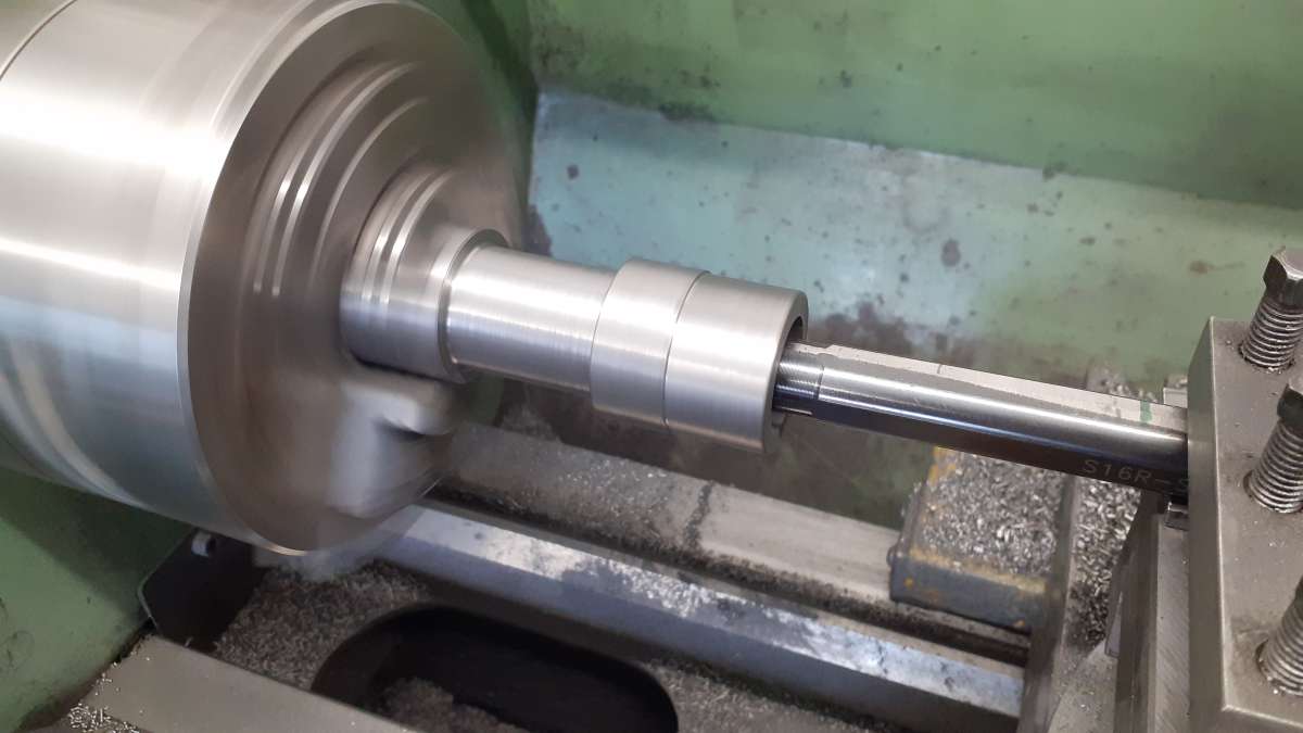

          Well I can turn a parallel OD but do sometimes get a tapered bore, I put it down to additional flex due to the distance the cutting edge is from the toolpost.
          When turning an OD I seldom get any material removed when I wind the tool back to take the next cut unless I’m taking heavy cuts. But when boring the tool will usually leave the tell tale spiral on the bore as it is wound out quickly.
          The only thing I can see that is different is that I may have 100mm from the toolpost when boring but 10mm when turning.
          That cylinder I showed above had some taper but I know how to deal with it, either by using the brake cylinder hone or in this case as it was a bit more pronounced I used the Emery method. Does not seem to be a problem, this is the engine quickly assembled and as you can see there is a good bounce when it comes up to compression. I should say that for this video I had not yet fitted the Viton O ring, no gaskets fitted, no springs on the valves and I even had the valves in the wrong way round so they had not been lapped into their respective seats. Squeaks a bit as the air get spast my fingers which are covering the plug and valve access holes.
          I don’t tend to bore cylinders on the mill as it is hard to feed consistantly so prefer to use the lathe either with the part in the chuck if it’s a small engine or bolted to the cross slide if large and use a between ctrs bar. The later does not produce a taper so again it suggest the problem is specific to using boring bars in the toolpost.

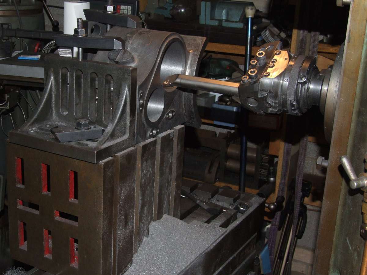

                  I bored the cylinder and liners for my engines on the horizontal mill as it wasn’t practical to use the faceplate or cross slide on the lathe. Far too much faffing about to get everything aligned and square, especially on the faceplate with a very heavy casting. Manual feed was a bit tedious on the horizontal mill, but centring on the bore was simply a case of moving, and then locking, the X and Z axes. A complication was two bores that needed to be accurately spaced, ideally within a thou or two. I had a lot of problems with chatter due to the length of the boring bar, but the bores were parallel to within a few tenths, over 5.5″ as best as I could measure with an internal micrometer:
                  2020_07100002
                  When I bored the seperate liners I had less trouble with chatter as the boring bar didn’t need to be long enough to avoid hitting the cylinder mounting flange.

                    This has been the question that usually comes up. I don’t have the equipment to measure what may only be a 0.001″ difference over 4″ to be able to see if the “taper” is constant or more of a trumpet shape, I can just about measure the 0.001″ difference.
                    But you mentioning “spring” is also what is usually said about boring so even if a lathe turns parallel on OD there is something that stops a boring bar turning parallel on it’s first pass and the fact there is “spring” suggests flexing somewhere.
                    That bore in CI bar was drilled 22mm and then bored out to 24mm with a 16mm insert bar held in a 4-way toolpost so should not really be a lot of flexing of the bar.  Maybe a fixed steady would have helped if it is the work moving and not the bar, but probably not as bore was smaller at the chuck end.
