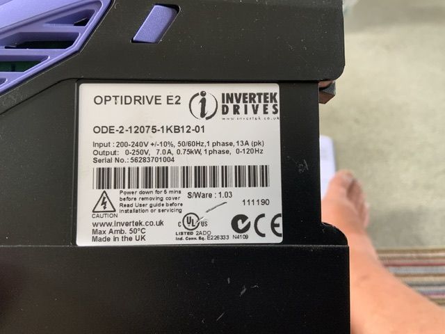

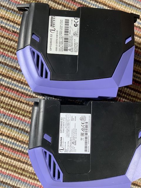

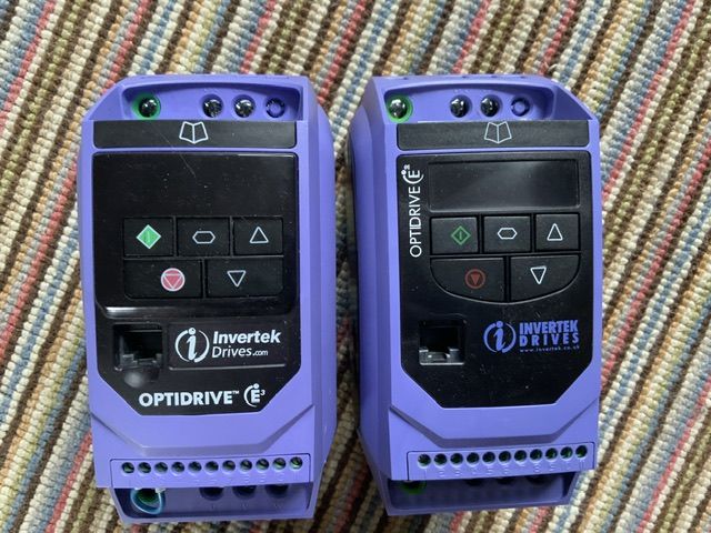

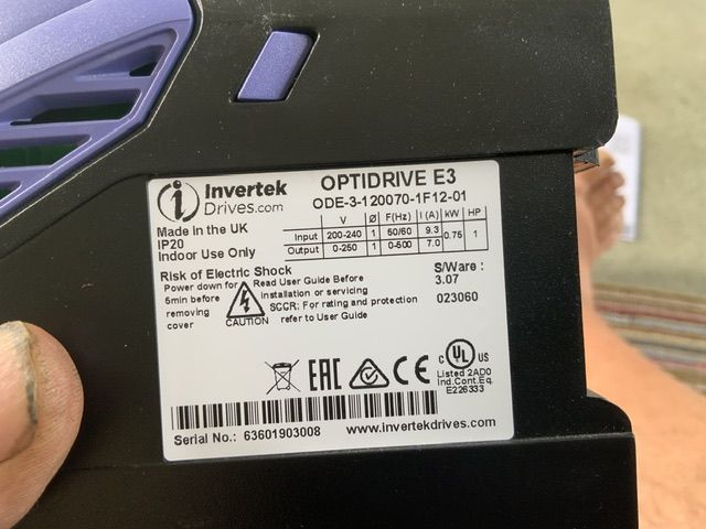

                                Kenl
                                if you want to try a single phase inverter i have a few secondhand units in as new condition
                                #661054

                                  Hmm, those appear to be 3 Phase output, single phase input VFDs. The OP needs a single phase OUTPUT VFD.
                                  #661059
                                  Ian Parkin
                                    @ianparkin39383
