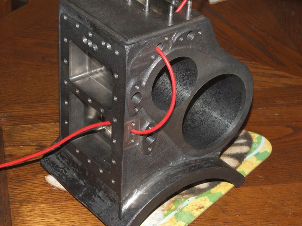

                      The steam flows from the regulator chest (bypassing the regulator) through passageways in the cylinder to the back of the valve. As per the red wire:

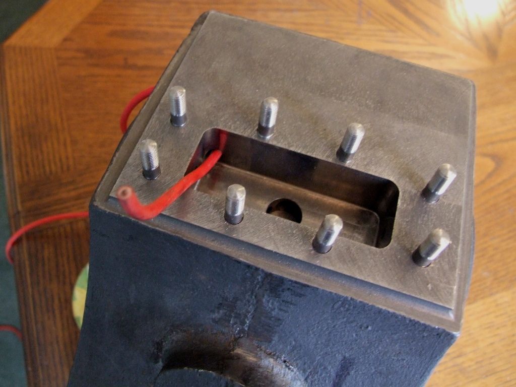

                      In the CAD model the valve is shown closed. When open the steam flows through the valve to the downward facing union to a pipe. The pipe then connects to a flange on the cylinder rear face and a hole that goes into the LP valve chest, again follow the red wire:
                      Although not shown in the CAD model the valve is spring loaded shut. On the fullsize engine the pipe from the valve outlet to the LP valve chest is 3/4" OD, which has a small area compared to the normal flow through the valve passageways.

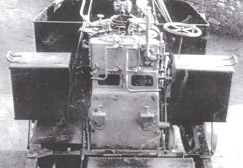

                        The photo below was one taken by the manufacturers, looking onto the back of the inverted-vertical engine with the HP cylinder on the offside end.
                        The steam take-off on the boiler is the dark-shaded elbow followed by a globe-valve I take to be the regulator, not obvious on this picture but shown by the bolted flange. From that the steam enters the upright column rising from the rear face of the HP valve-chest, with a displacement lubricator above.
                        What I take to be the sampling or starting-valve is the fitting on the valve-chest face itself,. with the short, vertical lever that on the original would have been to the driver's side. (The curved lever below seems to be the reverser.)
                        The cylinder drains are clear enough but the object on the lower outer corner of the LP valve-chest is something of a puzzle.
                        The flywheel is partially visible, down below the driver's seat.
                        The two small covers on the engine's main cover-plate (which is "quickly detachable" it says in the catalogue) are clearly extensions to give room for the expansion-links, but what the little "periscopes" on them do, is anyone's guesshindley engine.jpg!
