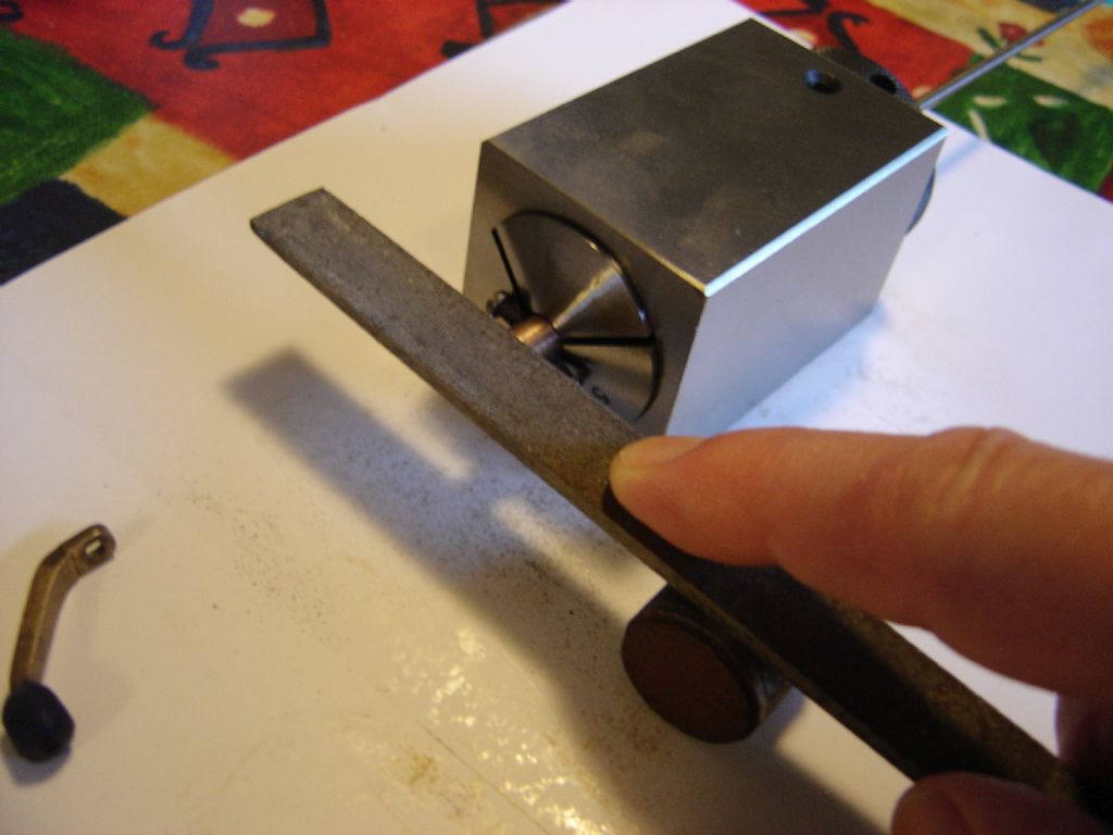

            You can quickly put good 'squares' on the end of 1/8" regulator rods and similar parts by holding them in a square collet block and using a piece of short round stock approximately half the height of the block to roll/guide a file over the end of the rod. Very quick and simple to set up.

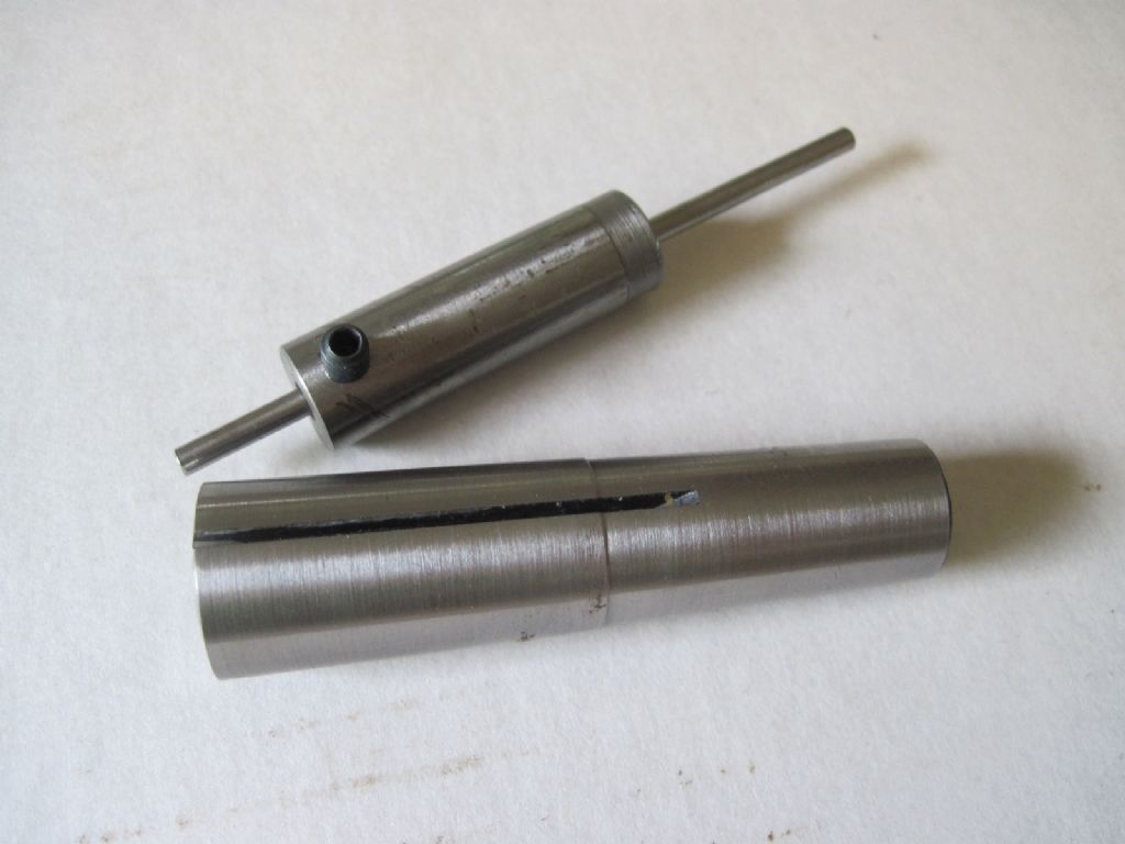

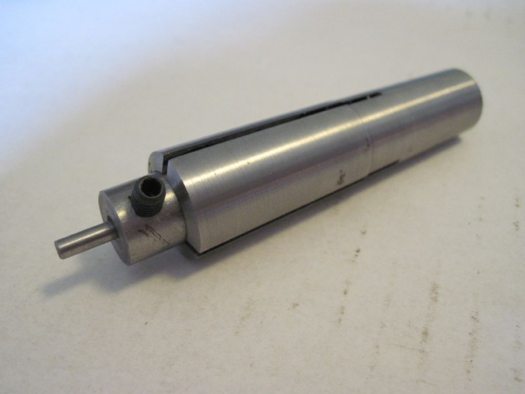

                                                  Sorting through some old G3 GTG photos earlier – and found these two (misfiled) images.
                                                  Long before I had my ER collets (and the previous Chinese 'standard' ones) – I purchased a couple of MT2 taper collets to hold milling cutters. With the arrival of something better they fell into disuse. However, I was doing something (long forgotten) that needed repeatable lengths setting up in the lathe chuck and I hadn't got around to making a chuck back-stop. I was pondering this problem when my eye caught one of my old MT collets on the shelf. A bit of swift drilling and tapping into some spare stock later – and I had the required back stop!
                                                  I keep meaning to make some more 'sophisticated' stops – ones that screw in & out and have different head diameters (etc) but I'm afraid I haven't done so thus far – although I did buy a MT1 collet recently (same holding diameter as the original one) so that I have the same facility on my small EW. That's it – a simple thing but it works quite well and can be improved if required.
                                                  Regards,
                                                  IanT
