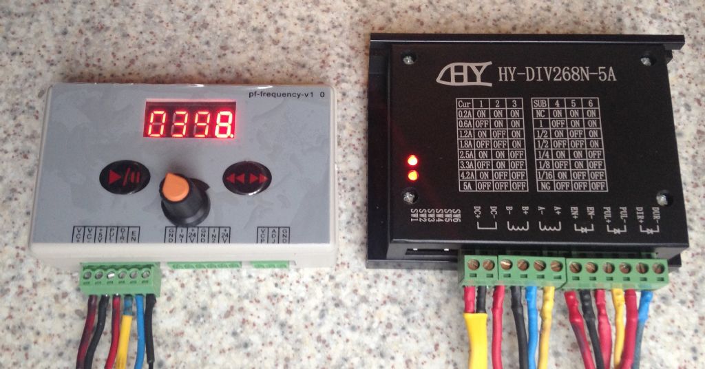

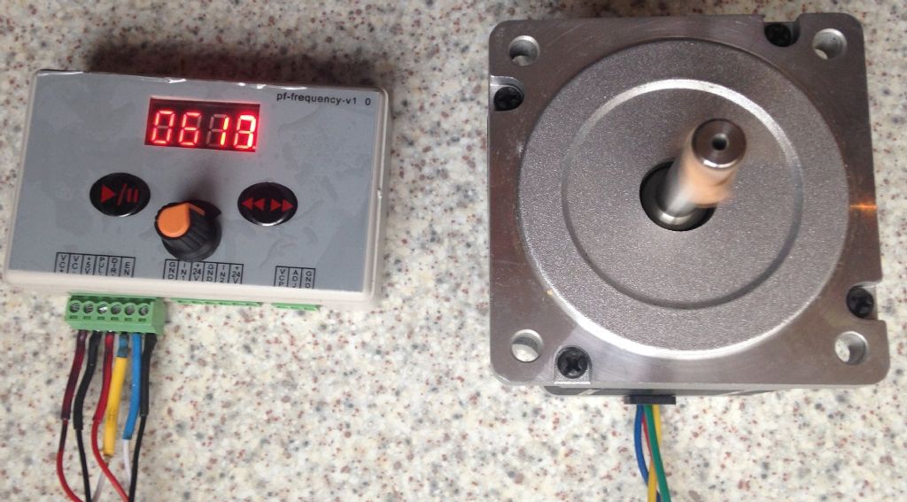

            ray jones 1
              @rayjones1
              me2.jpgUPDATE ON PROGRESS
              Following all of your kind advice, I purchased
               a stepper controller , pulse generator , as photo and connected them up to a 6 AMP supply and my NEMA 34.
              After playing with various Amperage and dip settings, the motor runs "reasonably smooth" – at most speeds – ( but not perfect) .
              Using the control box, the motor can be started, stopped , forward and reverses – with ease.,
              The slowest speed is approx 5 RPM the fastest approx 200 RPM only. is this normal?
              The frequency indicator goes from 0 – 900, The motor runs happy from 0-600,,but once you turn it  past 610 the motor grinds to a halt
              Should it run faster or smoother?

                Hi Ray,
                The problem may be that the voltage of the power supply is not high enough for the current to build up in the motor winding as the pulses get shorter at higher speeds. This is because of the effect of the inductance of the motor windings. For more details read this web page.

                #184909
                ray jones 1
                  @rayjones1
                  i have the motor connected to the mill, although be it on a very temporary fit..
                  using the speed control on the box, the the feed hand wheel will turn from
                  approx 2 RPM ( for very slow feed) up to 150RPM (for rapid return).
                  which seems just perfect.
                  I assume the digital readout on the box refers to Htz.
                  it reads from ZERO to 900.htz
                  The motor responds normally from ZERO up to 620htz? then grinds and stops
                  But restarts when below 620htz
                  Steamgeek ,did you have this problem?
                  will keep you advised of progress
                  Thanks RAY
                  #184918
                  Steamgeek
                    @steamgeek
                    Hi Ray
                    I have never gone above 500, I am using mine for a power feed on an ML7 cross feed so slow is the name of the game for me.
                    I have just been down the workshop to try it and I do have the same fault.
                    I am using a 24v 5A transformer to power the unit, and briefly switched it over to a 12v 63a leisure battery and the fault was the same
                    Regards
                    David
                    #184925
                    Keith Long
                      @keithlong89920
                      Ray I suspect that at the higher stepping rate the motor simply cannot follow the steps due to various factors such as inertia and the available torque falling off. Jim Cox's book "Electric Motors second edition" has some graphs of "%age torque" vs "steps/second" the fall off rate is quite remarkable.
                      #184927
                      John Stevenson 1
                        @johnstevenson1
                        The technical term is egg bound.
                        You need gearing to get within the boundary's you need, within reason that is.
