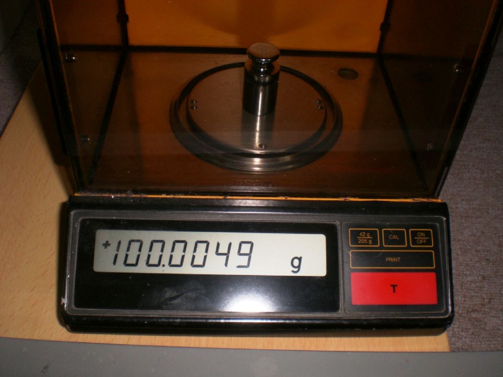

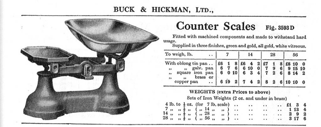

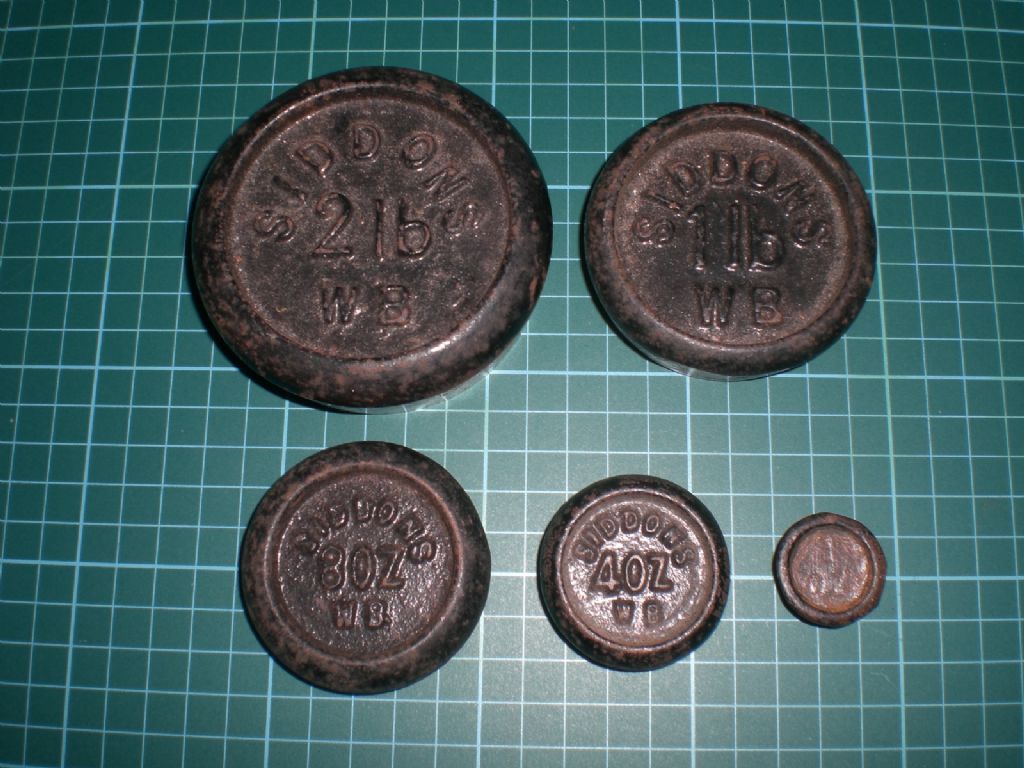

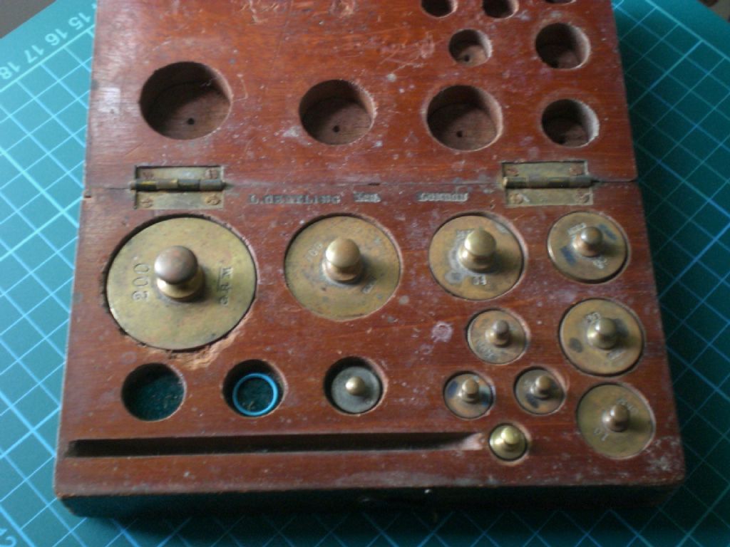

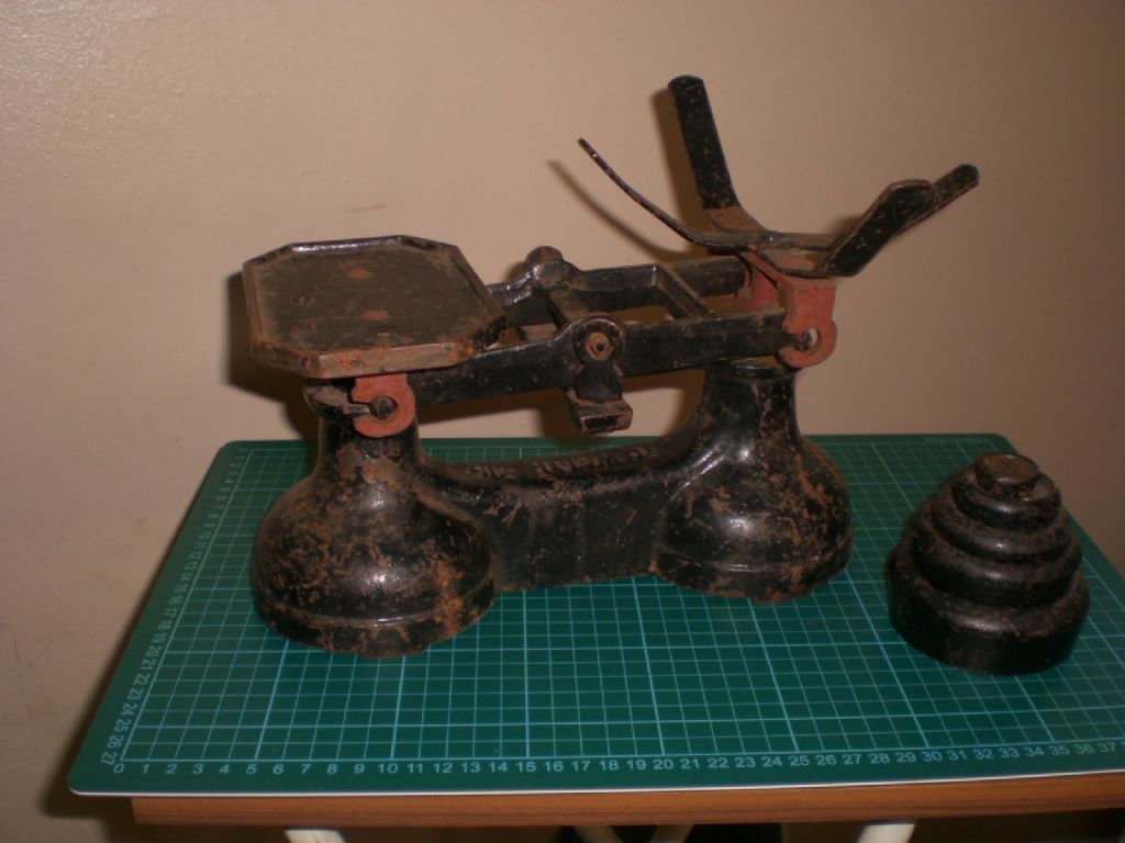

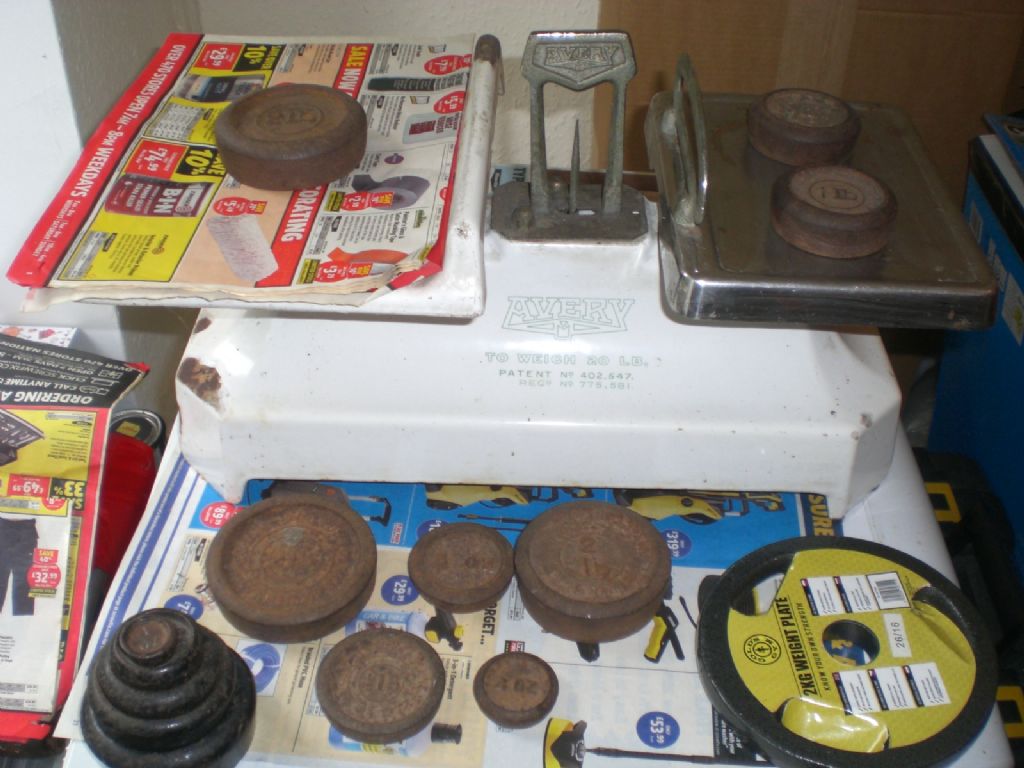

                        Hi, I've dragged this counter scale form its hiding place, which I got off ebay several years ago, which looks very much like this 1964 B&H catalogue one.
                        It came with a rubbish pan that wasn't an original and five weights and although four of the weights have the same name on them, I doubt that the 1 oz belongs to the same set.
                        This one weighs to 7 LB, which according to the catalogue would've had weights from 4 LB to 1/2 oz and from 2 to 1/2 oz would've been brass. I haven't ever really used these scales, but the weights have been an addition to those that I got with this Avery scale that I guess would have maybe been used in a butchers or fishmongers shop and even then were not enough to use for full capacity but the 2 Kg lifting weight helps bring them closer, but I don't think the rusty ones were originally for the Avery anyway. I do have a 5 Kg electronic Salter scale with a stainless steel platform for the kitchen and none of the weights that I have, weigh exactly what they say on them, but I also have a fairly populated box of L. Oertling weights bought from a car boot sale 20 years plus ago and had them all checked for weight by a lady in the Lab where I worked years ago, on their highly accurate electronic scales that were checked regularly for accuracy by a company like Lloyds British, and all of them were quite a few milligrams underweight, which I checked yesterday on my Sartorius Research R 200 D electronic semi-microbalance and are pretty much the same as they were when checked before, although the 1 gram one was missing, so I made that one and had to take it back to work a few times to get it checked before I was satisfied it was close enough.
                        Making other size weights from one known weight is OK, but of course you need to know what your known weight actually is and what accuracy you want to achieve. The calibration weight on my Sartorius is one that came with a PS-200B pocket scale (1 to 200g) bought from Maplins a long time ago, is very accurate for a budget scale, the Sartorius has its own internal calibration and the machine can be set on four different stability conditions from very stable, stable, unstable and very unstable, I have it set on stable as I don't have a place currently where it can be considered to be very stable. The paper on the Avery scales has to be in place to bring it into the level position before anything can be weighed, which is what shops did with their bags or wrapping paper, butchers and fishmongers never put their products directly on the weighing platform in the shops that I've been in years ago, but I don't know if they do that now as I don't go in such places now.
                        Regards Nick.
