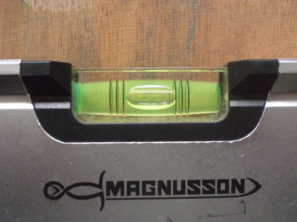

      Good morning All,
      Do regular/domestic spirit levels have curved vials?

        Thor 🇳🇴
          @thor
          I think they have a slightly curved inside, the more accurate/sensitive levels have less curvature than a coarser one.

          #642102
          Nicholas Farr
            @nicholasfarr14254
            Hi Bo'son, if you mean the type from DIY stores, many of them have slightly barrel shaped ones.

            #642104
              I don't think you can generalise. Most of mine of the rough levelling type are definitely bent, others are straight and probably barrel ground. My collection varies tremendously with vials ranging from dubiously bent plastic to well-made glass. They all work, but the cheap ones are only OK for finding a rough level, untrustworthy if an accurate flat is needed.

                      #642192
                      Clive Hartland
                        @clivehartland94829
                        Yes, the internal diameter of a precision vial is hand ground to a curve. I seem to remember that a 20" bubble had a radius of 60'.
                        #642218
                        Nealeb
                          @nealeb
                          I think the sums are pretty easy here.
                          Let's say that 20" of tilt give a 1mm movement of the bubble – about right? So we need to find the radius of the curve in which 20" of rotation is equivalent to 1mm at the circumference. Think of a giant toroidal tube if you like, of which the vial is the tiny bit that you can see. Clearly, rotate the toroidal tube and the bubble will move, giving the numbers we are working with. 20" is equivalent to 1/3', 1/(3*60) deg, 1/(3*60*360) revolutions. So the full circumference is 1mm times (3*60*360), which my calculator makes 64800mm
                          Radius equals circumference/2*pi, =10313mm.
                          So approx radius of vial is about 10m. Substantially less than the radius of the earth?

                              #642236
                              Anonymous
                                Precision vials are made by very slightly bending a straight tube in a fixture. A straight hole is the created and honed. When the tube is released the result is a hole on a very large radius.

                                Grindstone Cowboy
                                  @grindstonecowboy
                                  To answer the original question, yes they do (or at least they used to, they may have been superseded by the barrel type shown by Nick). Precision / engineer's levels are another matter
