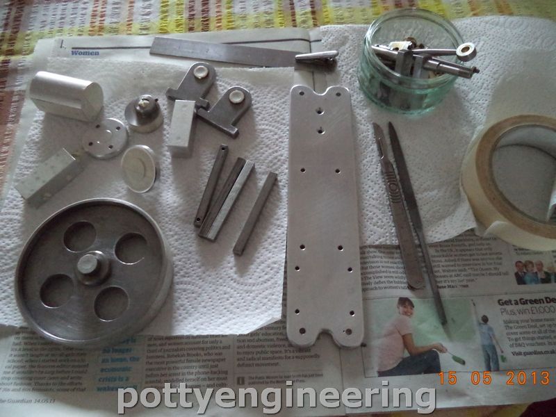

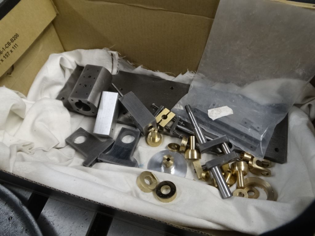

                    Hi hope this is the correct thread for this, couple of photos of my attempt to construct this engine, I have never used a lathe from leaving school and I plan on retiring in two years so you can work out the sums.
                    This is the start of my further education, the engine is still to be completed and is in rough stages, the threaded bar to be cut to correct length, washers added.
                    May not be to the same high standard I see on this forum, but I am pleasantly please with me efforts, when I get it completed and running I will then spend time making it look good
                    Best thing about it is, I have had a great time leaning new skills.
                    Just thought I would share

                      Looks good from over here

                      Stewart Hart
                        @stewarthart90345
                        Posted by Neil Wyatt on 28/10/2017 18:06:29:
                        Looks very good from her
                        Nice work Jim
                        Its always great to see one of these engines being made by a beginner, as it was designed as a beginners engine, there must have been quite a lot made by now.
                        Can't wait to see a picture of the finished engine or even a video of it running
                        Cheers
                        Stew

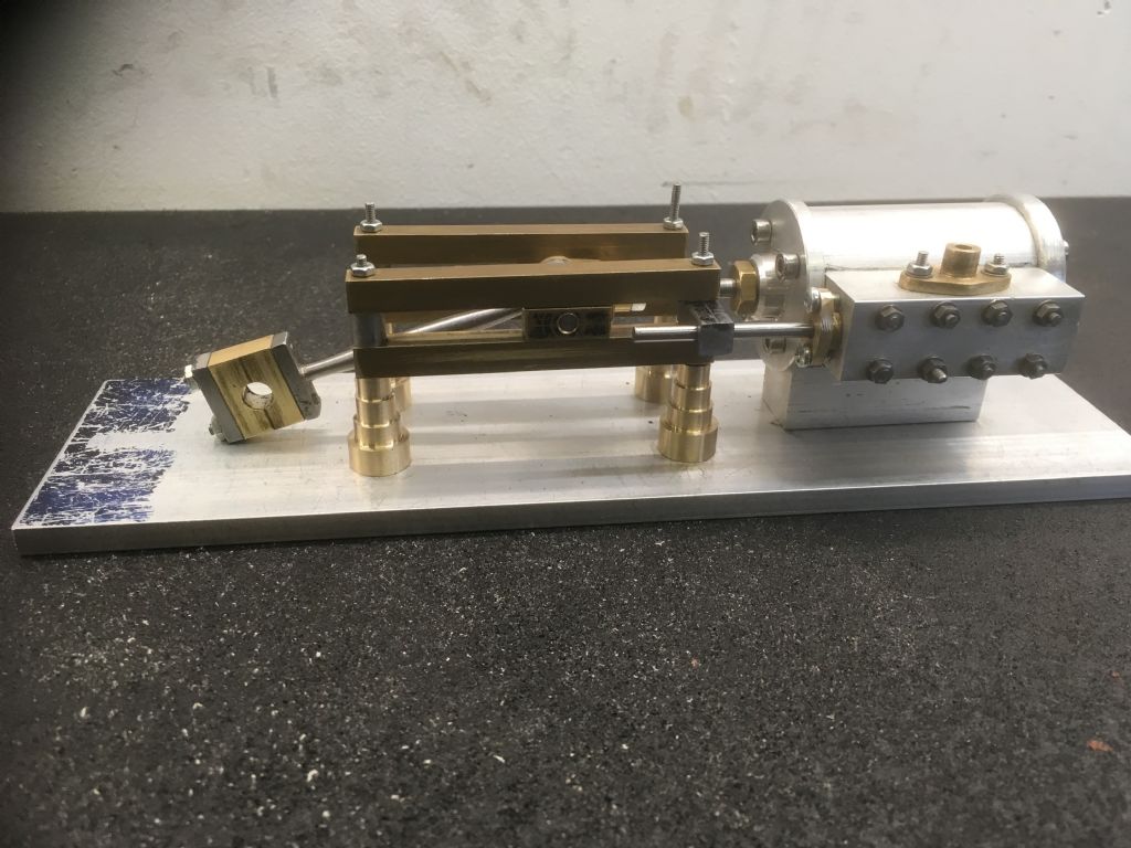

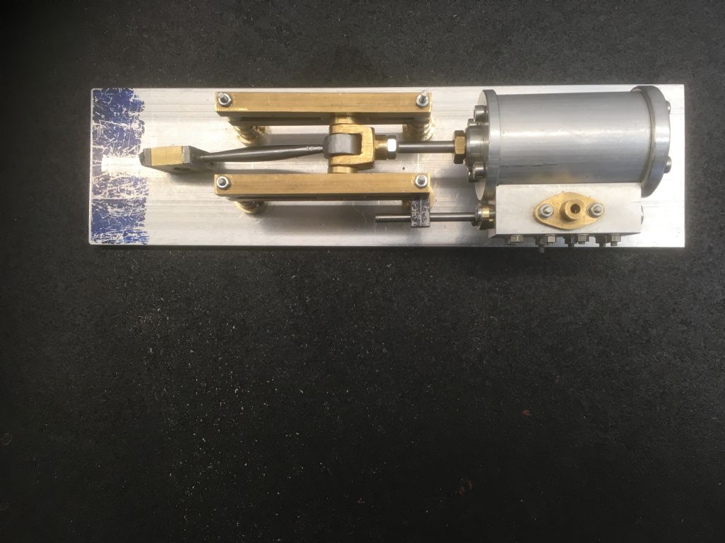

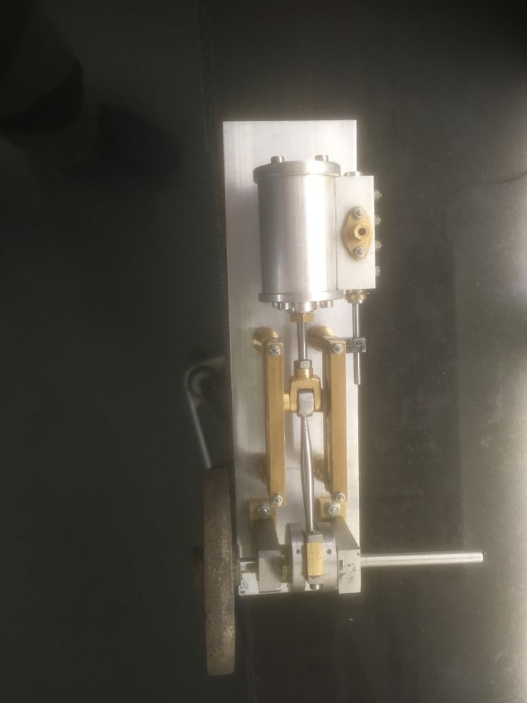

                            #338565
                            Dullnote
                              @dullnote
                              img_0788.jpgimg_0789.jpgJust thought I would update, slow but getting there
                              #338574
                              Jim Nic
                                @jimnic
                                That's looking very tidy Jim. Do she run yet?
                                Jim
                                #338589
                                Dullnote
                                  @dullnote
                                  Not yet still got eccentric to fit. The flywheel does turn the crank around and everything does what it should do but feel unit is tight, think I will need to tweak it a bit to get smooth movement but plan to do that when everything is fitted, hope to get some workshop time tomorrow

                                  #338608
                                  Stewart Hart
                                    @stewarthart90345
                                    Hi Duffer
                                    Sorry I missed your post on 30/10/17 I was on holiday at the time and got behind with following the forum.
                                    Your build is looking good, have you got her running ?.
                                    Stew
                                    Hi Jim
                                    That,s looking good too, best way to shake out the tight spots is to loosen all the screws, then tighten them up one by one any screw that causes it to bind needs investigating and the cause fixing.
                                    Look forward to seeing the completed engines and a video if posible
                                    Cheers
                                    Stew

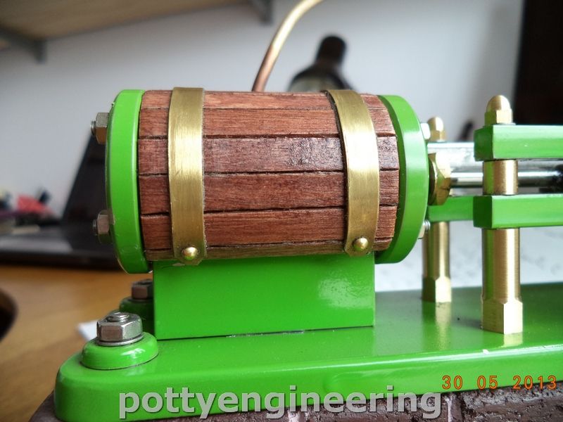

                                    #338655
                                    Hopper
                                      @hopper
                                      Posted by Stewart Hart on 16/03/2015 08:08:04:
                                      Stewart, on the brass bands around the wooden lagging strips on the cylinder, are those brass rivets' holes drilled into the metal cylinder, or are they just into the wood?
                                      Also, where's a good place to buy the graphite packing for the piston ring and glands?

                                        Stewart Hart
                                          @stewarthart90345
                                          Posted by Hopper on 28/01/2018 11:50:00:
                                          The method I used on the brass banding wasn't one of my better ideas I used two way sticky tape the rivets are just dummy, but the darn stuff starts to peal off and I have to press it back down, for the follow on engine I drilled through the banding into the cylinder and used some small M2 dome headed cap screws to fasten it down, you can get the screws from model fixings http://www.modelfixings.co.uk/
                                          I had terrible trouble the first time I tried to clad a cylinder then someone told the trick of first gluing the batons with copydex to a piece of cotton material then cut to shape and fix the whole lot to the cylinder, the batons are coffee sterers.
                                          You can get the graphite from Macc Models or Blackgates but you could use ptfe thread tape that you get from plumbers merchants just twist it into a string and use a graphite packing works just as well.
                                          Hope this helps
                                          Stew

                                            #338674
                                            Hopper
                                              @hopper
                                              Posted by Stewart Hart on 28/01/2018 13:02:06:
                                              Thanks. LOL, trust me to ask the awkward question!
                                              I've used the rolled thread tape dodge I don't know how many times on full-sized steam plant years ago, glad to see at least some of my skills transfer across to the smaller scale stuff. At least it was a step forward from my old boilerhouse foreman's dodge of pulling a string off the floor mop and using it to pack a leaky gland with.  laugh

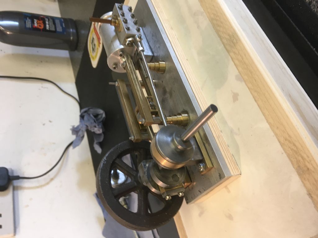

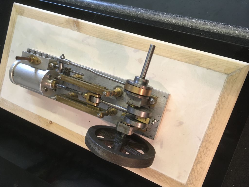

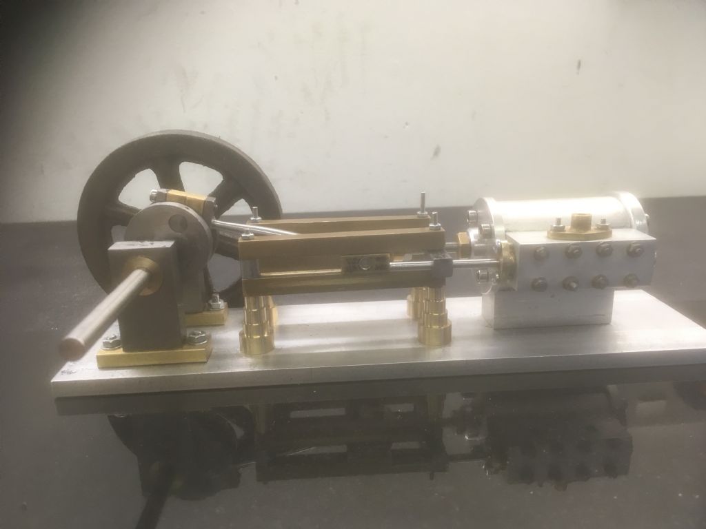

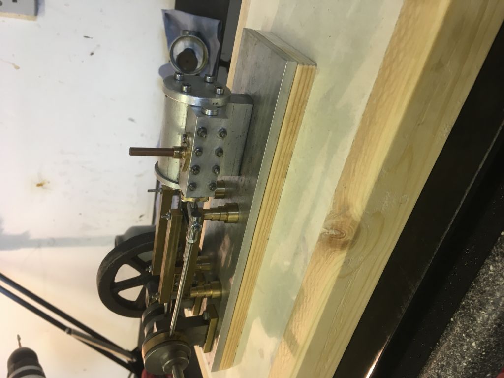

                                              Dullnote
                                                @dullnote
                                                Hi completed the engine and had it running on air, did a vid but not sure how I can post it yet, will look into it.
                                                Started to make a base, some timber laying around and a price of wet wall, going for the marble effect, so it is now strip the engine, clean up and tidy nuts and bolts, paint and polish.
                                                Think I will arrange for the inlet pipe to bend and go into the base then I can have air pipe hidden, contemplating a control valve .
                                                Will post when completed

                                                  Stewart Hart
                                                    @stewarthart90345
                                                    Well Done Jim a great runner I hope you enjoyed the build
