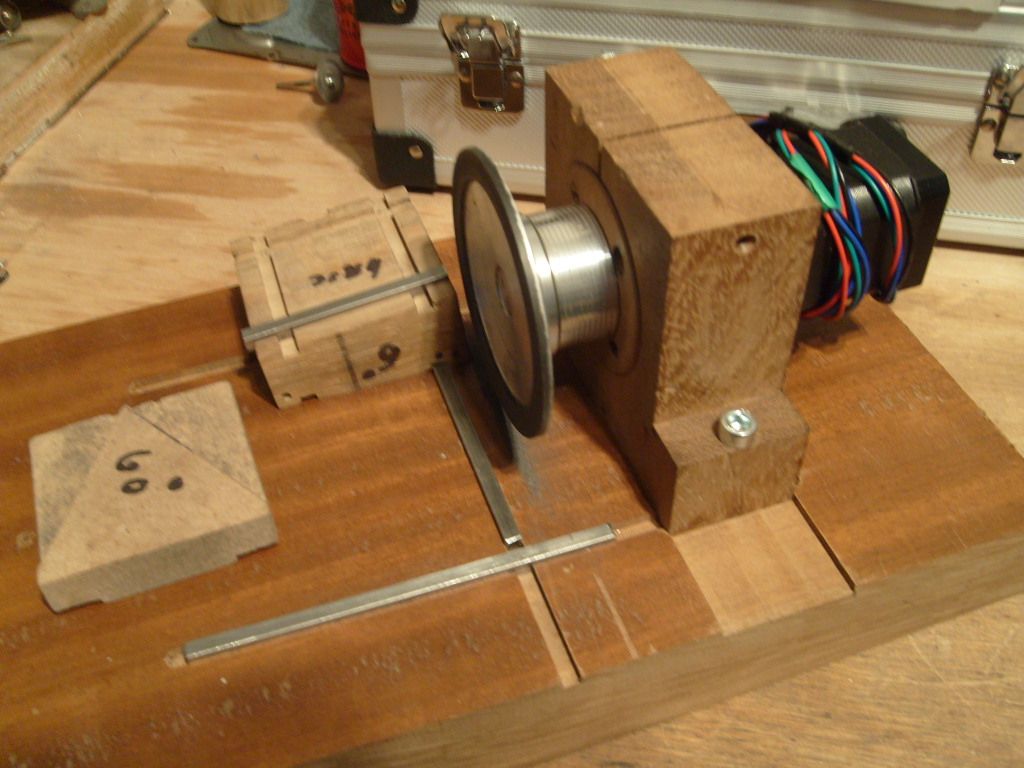

                I do not grind tools by hand (only for rough grinding). I made this tool grinder that uses holders. I made different holders for different angles. I can stack the holders to combine Horizontal and Vertical angles. I regrind a tool in just a few seconds. I takes more time to replace an insert.
                The "diamond" disk is driven by a low torque Nema17 stepper. When ever I use to much force, the stepper will stall, preventing damage to the disk.
                #590700

                  Looks like a good system Huub.
                  Another easy one is to think of the periphery of a circular grinding wheel. If the top of the tool is exactly on centre the contact point will be at 90 degrees. But if you raise it up a bit the curvature means it will be at an angle. A bit of calculation, or drawing will let you know the height/angle combinations. Then all you need is a block of wiid and some thin strips to pack it up.
                  #590705

                    You are right about that.
                    I want to be sure I always use the same angle. That way, there is very little grinding needed. That saves time and tool life.
                    I have counted my "angle blocks", there are 2 vertical blocks and 6 horizontal blocks. For inner turning tools, the 2 vertical blocks are stacked for a greater clearance angle.
                    More complicated grinding (mills, drills, taps, rotary broaches, slitting disks, etc) I do on the small CNC lathe.

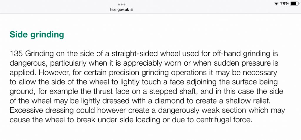

                      I am unsure about those grinding rests designed to rest tools on the side of a conventional grinding wheel. Every manufacturer says this is dangerous to do and every workplace and tech college I know of forbids it for safety reasons. And so do all the mainstream professional machining books I have seen.
                      It is only in model engineering related publications that I have ever seen recommendations to grind on the side of the wheel. Even in old books by respected lifelong machinists like LH Sparey and co.
                      Why is that?

                        Grinding on the side of stone wheels is not recommended as too much wear can weaken the wheel but the wheel in the photo above is an aluminium (aka aluminum in some countries) disc with diamond particles adhered to its side.

                                It is interesting to note that the Current HSE Guidance is much less dogmatic than the old Regulations:
                                **LINK**
                                https://www.hse.gov.uk/pubns/books/hsg17.htm
                                … Well worth downloading ^^^

                                  I dont know, Michael. It still labels it as dangerous and allows only for the side of the wheel to "lightly touch a face adjoining the surface to be ground". So not grinding on the side of the wheel, just allowing it to touch a shoulder lightly in order to grind full up to it on the outer diameter of the wheel. More exceptions and whytofores and wherefores than an insurance contract.

                                    Agreed … but the encouraging thing is that HSE seems to now be informing/educating the user, instead of just imposing regulations.
                                    Methinks that the aforementioned Model Engineers would claim that their designs were only intended for ‘light touch’ sharpening, rather than aggressive grinding.

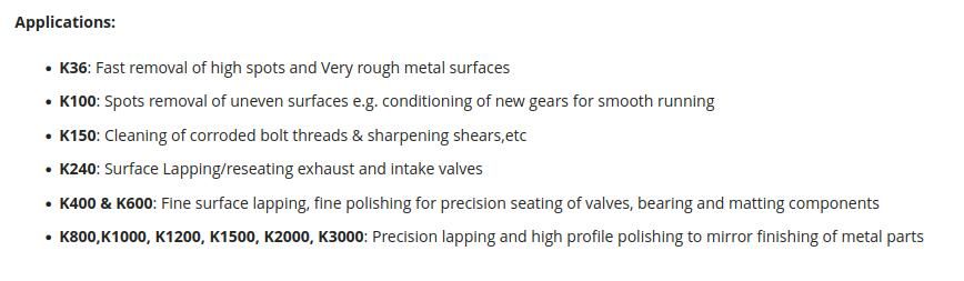

                                                The disk is a cheap "diamond" grinding disk. A link to the dutch supplier (article 7944) Grinding disk
                                                It gives a good finish even when running (dry) at 800 RPM. For hobby use, in this setup, it will last for years.

                                                  As I don't speak Dutch I'm not sure of the grit size on those discs so it would be helpful to know that.
                                                  I'm more and more persuaded to go for Huub's solution, the main problem being finding a suitable motor to power it.
                                                  #590934
                                                    Posted by James Hall 3 on 21/03/2022 14:57:11:
                                                    Thanks Huub and Paul.
                                                    No need to understand Dutch, K240 is the grit size.
                                                    HBM discs are available in the UK too.

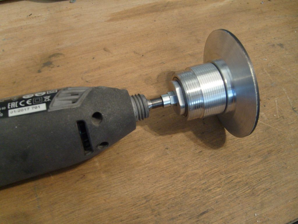

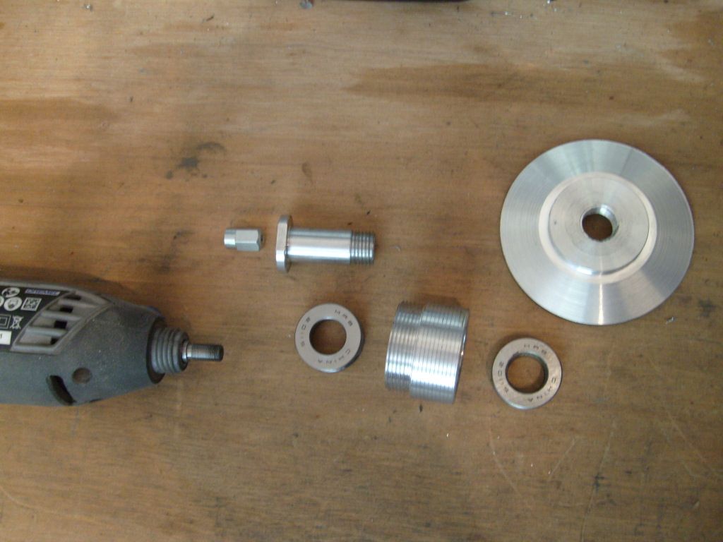

                                                      I have mounted the disk on a 2 trust bearing axis so the disk is running true without play.
                                                      The back of the axis has a hex hole that fits the nut on the dremel.
                                                      After a wile, I changed the dremel for the stepper motor that run's very quit.
                                                      I threaded the mounting hole of the disk.
                                                      The housing fits the dremel thread on one side and the threading of the grinder at the other side.
                                                      I choose for trust bearings because the load is only axial.
                                                      The parts (without housing)
                                                      The parts mounted (without housing)
