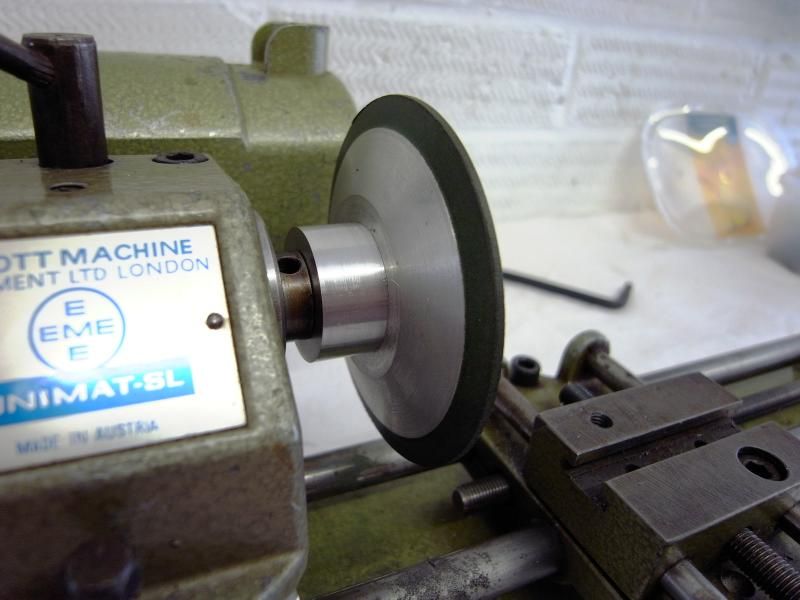

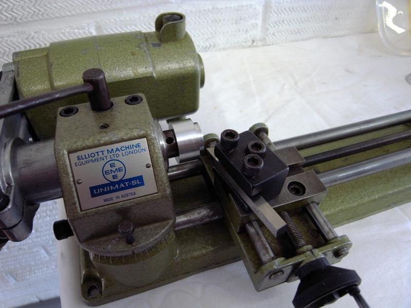

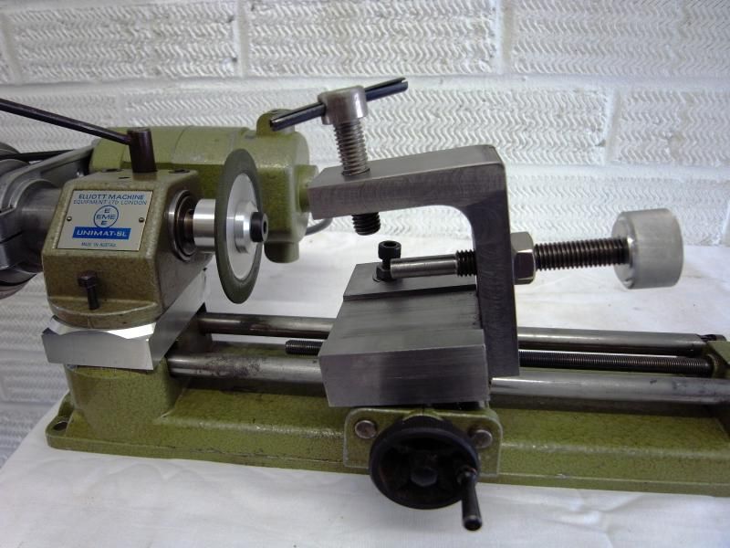

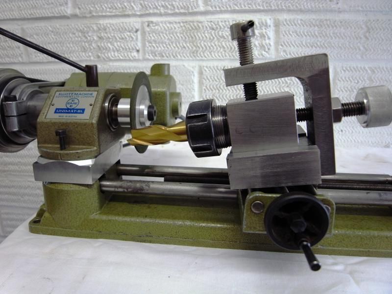

If you use the chuck to hold and index the cutter you then need another spindle/motor for the diamond wheel, also I doubt the chuck accuracy would be good enough for cutters.
The SL spindle is ideal for the grinding wheel, I'm sure with the right pulleys it would be good for 10,000 RPM so its a waste just to index with it.
