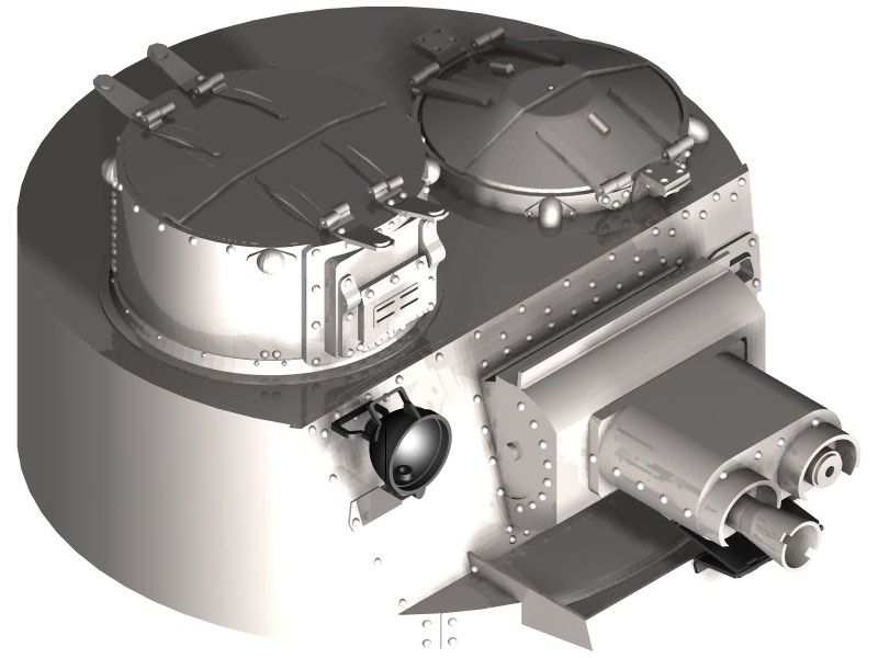

                                            #298032
                                            Cornish Jack
                                              @cornishjack
                                              Bit late in the day, but, combining simplicity and 3d design, I used Sweet Home 3d – must be simple 'cos I managed and it is free and has a fairly comprehensive library of 'bits and pieces'. I found it particularly useful because I can't visualise 3d from 2d plans.blush
                                              rgds
                                              Bill

                                              clogs
                                                @clogs
                                                Thanks all,
                                                taking in the recommendations ……..
                                                Neil W….what a work of art !!!….it'd be good if I could draw that free hand let alone live long enough to get the skill/knowledge to do something like that…….
                                                all I'd be happy with is square box's and the another box coming of at right angles, a pointy roof and stairs…….absolutely nothing fancy…….
                                                again many thanks…..Clogs
