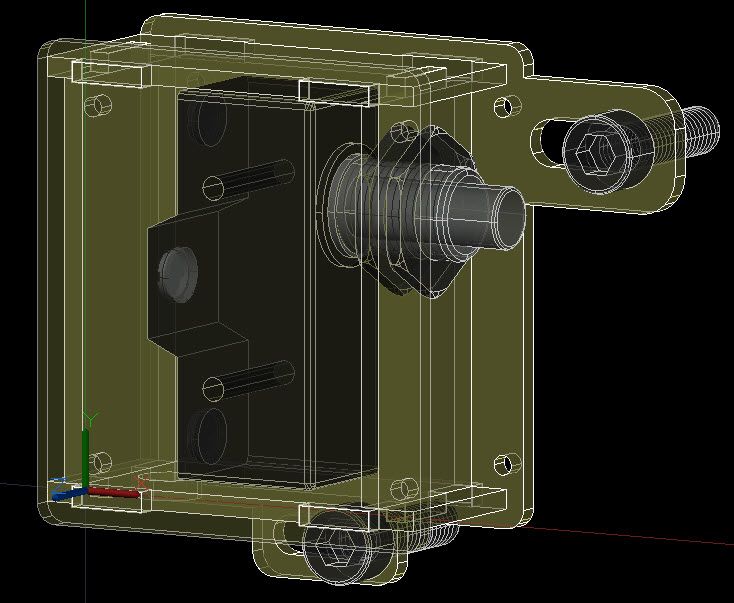

                                        John McNamara
                                          @johnmcnamara74883
                                          Hi John
                                          I provided housings for standard size plunger type industrial micro switches for the Epoxy V mill I am building. these switched are very robust and can be purchased for under 20 dollars from a known manufacturer.or a lot less from unknown Asian makers. I used these switches on another CNC project a router they continue to work well in spite of the wood dust. repeatability is around 0.003"
                                          The housing is tab and slot construction 2.5mm laser cut steel (not shown is the m3 screws that hold it together although the tabs do most of the work. they are very rigid.
                                          This article is worth a read
                                          In particular the section on precision micro switches with Micron level repeatability.
                                          **LINK**
                                          I did a google search.
                                          **LINK**
                                          I quickly found these as an example, but did not do an extensive review of what is on offer.
                                          For around 40 – 50 dollars pretty good accuracy 5 – 10 micron 120 dollars 0.5 micron
                                          I will stick the the mechanical switches for my project however if retro fitting a lathe where a single home switch is needed I would be tempted.
                                          **LINK**
                                          Regards
                                          PS Link to my project **LINK**
